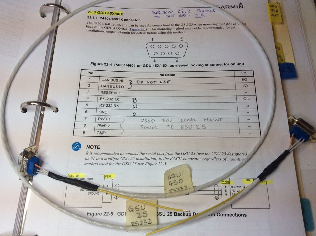

I spent several hours this weekend pouring over the G3X document and making notes and redrawing some of the information so that I might follow along a little easier.
So back at the hanger today, with the stripper and crimper in hand!
Here is the beginning of my 3' bundle from the GSU25 to the GDU450.
From what I understand, the only wires/pins on the 9 pin connector P4501 are for the data path backup. I guess the power on that connector is for output to the GSU25 IF you mount it to the back of the GDU.
I didn't catch the fact that those were power OUT on the P4501. Did I miss that someplace?

FYI I just learned today (I not complaining) that since the 9 pin connector on the GDU 450 is optional (used as a backup data path between the display and the ADAHRS that a connector and the rest of the stuff for that connector is NOT included in the connector kit for the GDU 450. I still don't see how or where I can deduce that in the manual but on with the wiring...
I thought I was going nuts, misplaced it or knocked it off my work table or the dog grabbed it or I don't know what... Wasted several hours looking for it...
