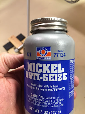

Default Anti-Seize for exhaust ball joints
I read that ball joints on the exhaust must be lubricated with anti-seize to prevent galling. Can anti-seize compound be wicked into the joint without disassembly? There is space at the open fair on the tubing to allow anti-seize to be squeegee'd in by finger. I suspect heat and vibration would spread the anti-seize between the mating surfaces. Thanks in advance...

This is a fairly easy job that can be done with anti seize and every other annual. We usually apply it to both surfaces. It is easier to loosen slightly the exhaust pipe nuts to allow the pipes to find their seating within the joint.

I believe anti seize is required where the header pipe meets the cylinder head as well.
Do we use the same anti-seize compound at both ends?.
