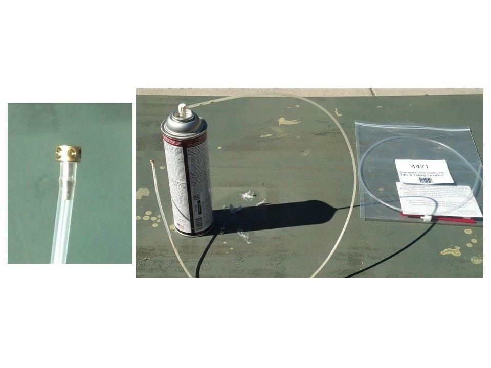

I've been putting off the priming of my torque tubes because I didn't have a great method in my mind for getting good coverage. On the RV10, the tubes are over 7.5 ft long each, so access is not easy.
The most frequent suggestion I've seen was to spray "a bunch" of primer inside the tube and swirl it around. I didn't feel comfortable that the rattle can had enough juice to go the length of the tube, so my best solution at the time was to buy Variprime and use it for the swirl. My thinking was that more liquid = better (compared to a rattle can). Problem was that the quart size of Variprime was going to cost over $120 with the converter. That stuff is liquid gold!
As I was at the auto paint store telling the guy what I was trying to do, he suggested an extension for the rattle can with a 360 deg nozzle on the end. Apparently its used in the autobody world for rust prevention around doors and fenders pretty frequently. The extension reaches 4ft so that my aircraft tubes could be primed from each end - and the best part was the cost was only $35. Sold.
Not much to the technique, but be aware of how small the surface area is that's being painted. If you are slow with the retraction of the nozzle, the primer will run all over.
Hope this idea helps someone else and prevents as much head scratching time as I wasted.

FAA recommends boiled linseed oil. It is very easy to apply, drill a 1/8" hole in the pushrods and inject some into the tube. Slosh it around, drain and fill the hole with a tube rivet.

Just follow Vans directions and swirl a bit if primer around in
Those tubes, done. For better paint distribution you can follow up
With a few burst of compressed air.
I have to admit the extension is a great idea but $35???
Linseed oil was the old standard, nothing wrong with it
But now you have to go out and buy linseed oil and what are you
Going to do with the rest of it?

Interesting spray head. Do you have a name or manufacturer?
Could be very useful for applying corosionX or similar.

Transtar Part # 4471 - Corrosion Protection Kit. Available at O'Reilly Auto, or Amazon. I got mine from an Auto Paint specialty store.
Originally Posted by N427EF View Post
Just follow Vans directions and swirl a bit of primer around in those tubes, done.
For better paint distribution you can follow up with a few burst of compressed air.
With a 7.5ft tube and not being able to see, I wanted the extra assurance that I had primer covering everything in there. I still don't know for sure without doing a borescope inspection - but THAT would be crazy overkill . Just another solution.

The linseed oil is hard to beat. If you warm it up you can feel the tube and tell where it is inside. This is the way the steel tube fuse homebuilders treat their's.
