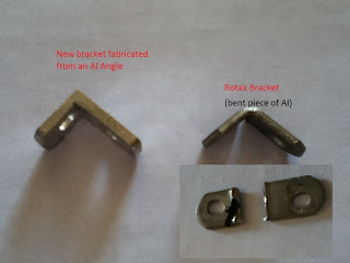

During my annual inspection I caught a broken bracket under the ignition module. I caught it by chance just because the vibration had created a polished crack that reflected my torch light. Very tight place, no easy access for repair and after finding how this bracket was made originally by Rotax (by bending 90 deg a pretty thick piece of Al), I decided to fabricate one (out of an Al angle) that should be less likely to crack. I suspect that I missed this broken bracket at my last annual because it was not polished enough...
Here is the faulty bracket with the new one I fabricated:
Here is the location where the bracket can be inspected (the new bracket shown here after repair):
You can easily understand why this cracked bracket might be difficult to detect (although I found afterward that pulling the ignition module up will show the crack once the bracket is broken)

On my 12 the same bracket broke at about 400 h.
**** of a job to fit a new one.

I also had the same broken bracket on the ignition module at 325 hrs.

Jack and Bob: are you sure about the number of hours when your bracket failed? As I mentioned, the failure may go unnoticed as there is little consequences to it. Indeed the ignition stack is set on the top of 3 "silent blocks" (an other French term?) of generous dimensions regarding the mass they support. Only one of these rubber dampers is using this type of bracket, the two others have a sturdier attachment. What I don't understand is why Rotax, with all it's mechanical wherewithal, is using a bent piece of thick aluminum for a bracket.

I see two possible issues with your new bracket;
1 - It looks like it is not the structural Al angle, no radius in the inside corner
2 - There appears to be a notch in the inside corner of the new angle, which may be a new failure point.
My questions are only based upon the image and may not be accurate.

My question, is an aluminum angle as strong as bent aluminum? Maybe it is stronger? I do agree the angle in the picture does not look like structural angle.
