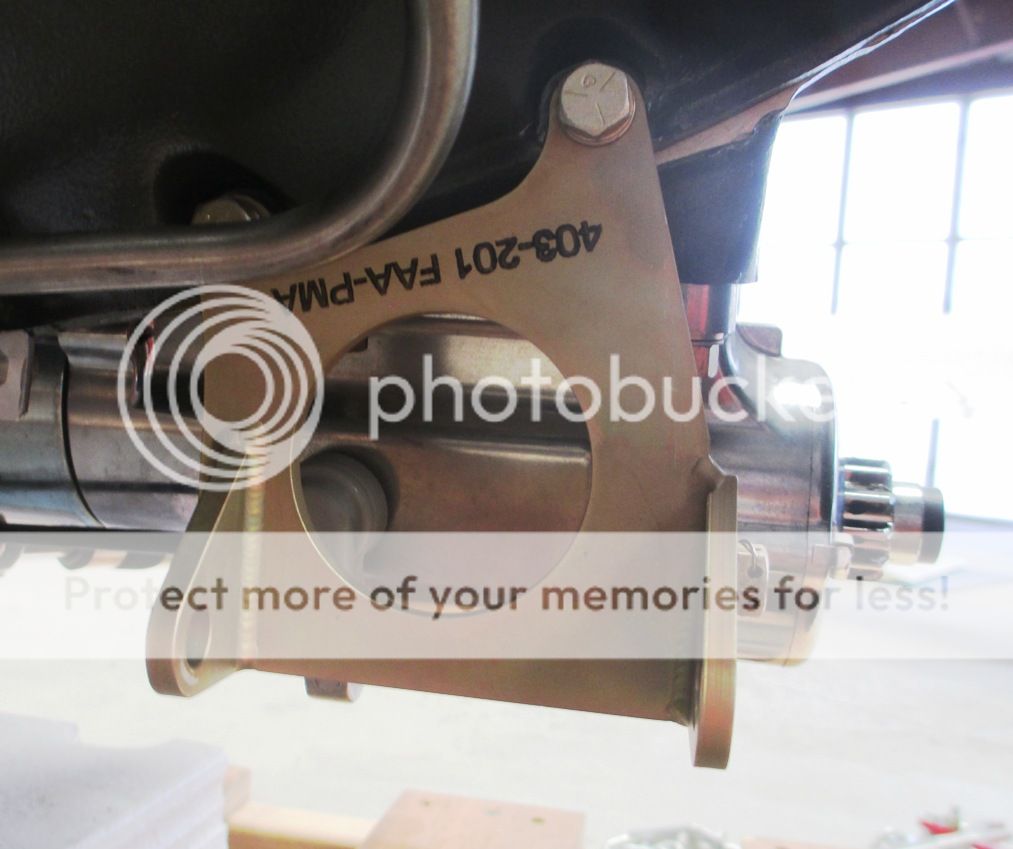

And just to add to the discussion, alternator mounts should also be considered.
All below are for older "Case Mount" alternators.
A comparison of the thickness of the Lycoming part (top) and Vans part -
The mount provided with the B&C alternator -
