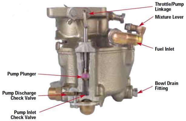

Hi Guys
I have an o-320 with ma 4spa carb on it. (2x slick mags 25 before TDC)
In the last couple of months I have been troubleshooting my RV6 having issues starting first thing, temperature is not cold 10-20 degrees C
I have narrowed it down to my carb fuel supply, possibly accelerator pump.
My reason is the following:
When I have my aux fuel pump on and pump the throttle I do not get any fuel in my air box like i usually did.
If I take a tiny bit of AVGAS drained from wings during preflight and throw it into my air intake she will start straight away on first rotation
After the first start of the day, she will have no problems starting again until left overnight again.
I am certain the issue is not related to ignition, and will be opening up the carb accelerator pump and check valves on the weekend. Have any of you guys got any tips on doing this, any parts that I need on hand that need replacing when taking it apart.
Does it sound like i am on the correct track?
Thanks in advance

Check the discharge valve and also run a wire down the discharge nozzle.

The only thing that confuses me is that the engine is very smooth from idle to full power (throttle pumped in fast stroke). I was under the impression that if the accelerator pump is not working that a pump of throttle to full power will cause the engine to hesitate before making full power
But definitely I am not getting any fuel in the air box with fuel pump on, pressure 5psi, and pumping throttle.

The discharge nozzle has an orfice in the neighborhood of .020 (I never measured). You won't get any kind of plastic tube in there. It's a copper tube and no you don't want to gouge the inside, but I always use a guitar string for stuff like that. It's the best way to ensure the tube is clear, you don't have to be an alarmist here.

From reading your initial post, I would agree, it sounds like it might be an accelerator pump issue.
One of the failure modes of the accelerator pump system, is that the long tube that sticks up into the throat of the carburetor can come loose, and fall out. The tube has a 90-degree bend in it, and is fastened with some sort of adhesive.
Make sure your accelerator pump tube is intact, and is actually spraying avgas upward into the carb venturi (throat) with each stroke of the throttle. If all that is good, then you likely don't have an accelerator pump issue. If you aren't getting a spray of fuel:
Rarely, and usually only after a long period of time, the seals in the actual accelerator pump can dry out and go bad.
Also, the carb overhaul instructions call out a test for the accelerator pump check valve. If it has failed, or has dirt in it, the pump won't force the fuel into the tube. Pretty rare.

OK.... So today I took the air filter off to see what is happening.
And this is what I see
The pump discharge nozzle is missing! I then looked back into my building log and it was never there since day one.....sigh of relief!PCHunt you were spot on with your thinking!
I pumped the throttle and fuel was definitely blasting out of the little hole but going straight down. Does anybody know if I can get a replacement for this and if this is the correct part. TUBE, PUMP DISCHARGE - 229-164--F

The tube doesn't just screw in, it is bonded with some sort of special adhesive/epoxy magic stuff.
I'm not sure that this would be an appropriate field repair.
Having said that, and looking back at your posts, you stated that you don't get fuel in the air box when pumping the throttle. If true, the missing tube wouldn't explain that. The fuel should just dribble out of the hole where the tube should be and drain down into the air box.
Have you observed the bottom of the carb while someone pumps the throttle to see if fuel is coming out?
If not, "further investigation is warranted," as they say....
