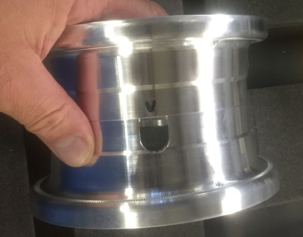

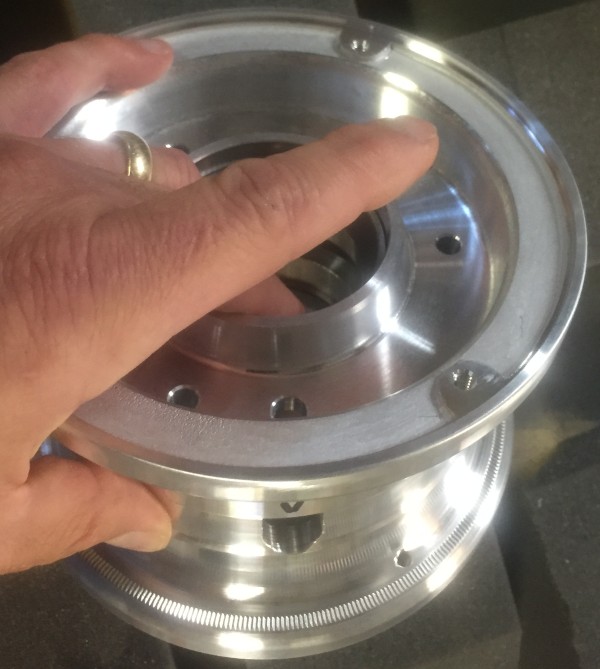

I got my wheel back from Matco today and mounted the tire on it. I haven't put it on the plane yet, but here are some preliminary pics and a report on the valve cap clearance.
As you can see from the first 2 photos, the hole is in the other half of the wheel, which is the way it should be for our installation. Matco sold me a new 1/2 wheel and machined my other 1/2 with the hole, then pulled my bearing races out of the old wheel I sent them and put them in my new wheel half.

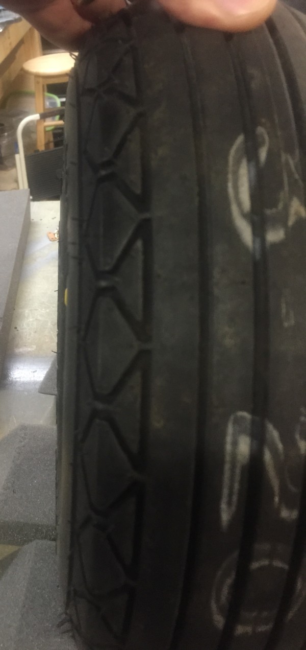

In the 2nd 2 photos, you can see a big difference in cap clearance will be the end result. When viewed from the forward side of the tire, you cannot see the yellow valve cap. I had to turn my viewing angle to the side of the tire to even see the cap sticking up. Then I laid a 2x4 on top of the tire, above the stem. The stem still has about 1/8" clearance from the board that is set at the width of the tire sidewalls. Now when you see your tire mounted on the forks, clearly the tire itself has plenty of room so it doesn't hit the fork. So the yellow cap will now be about 1/8" further away from the fork side than the existing sidewall of the tire is.
Much better, and now you can keep your metal hex cap installed.
Hopefully you all can learn from my mistake and save the added money I spent by allowing myself to be sold the wrong wheel in the first place.
