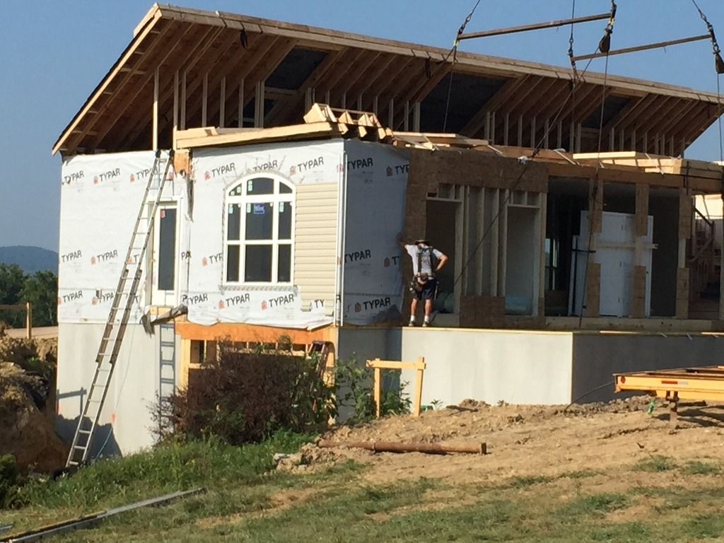

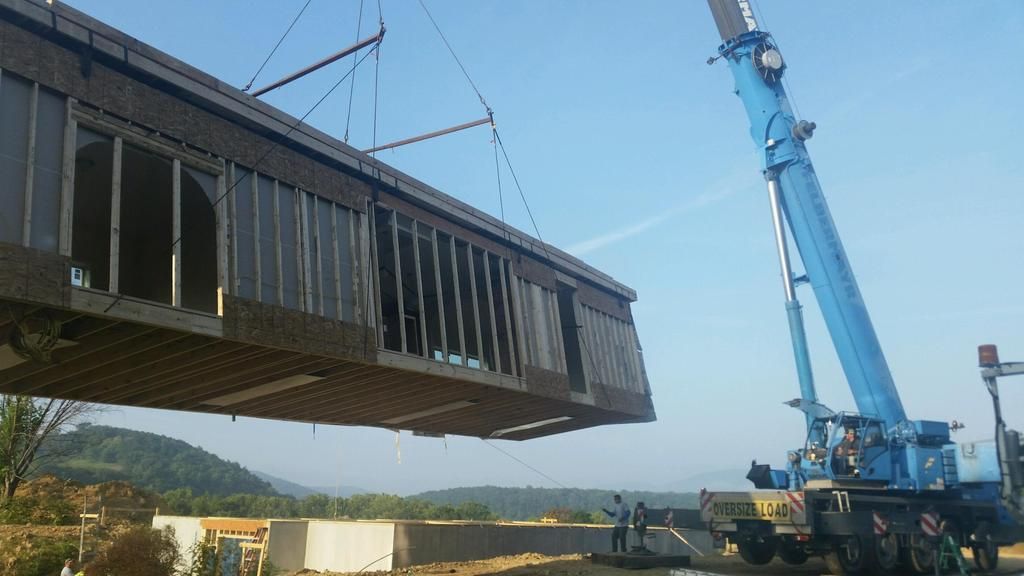

but I took yesterday off and gotta get back to salt mines. Yesterday's mechanical difficulties are no excuse! Wife's pix to the rescue.
Contractor says yesterday's malfunction came at the best possible time - before the "pick" started. If they'd had a unit on the cable when the O-ring went. it could've really set us back another two months while the demolished basement and house were re-built. Time to sweat-out the mission, I guess...
