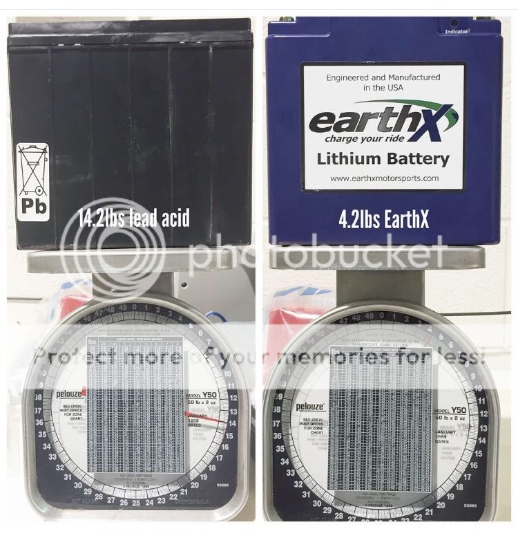

I now have EarthX in both my aircraft. I have been using another Lithium battery brand in my RV8 for 2 years.
HUGE DIFFERENCE when I push that start button!
Previous lithium brand during start would stop on first blade pass..... then start turning again for the actual prop rotation.
EarthX starts and surprises you! I could taxi the plane with just the starter button! (Not trying to exaggerate, it is truly a HUGE difference)
I hate hooking up trickle chargers. This is one of the big plus factors for me. EarthX does not discharge like standard batteries. Having 2 aircraft, one is always sitting and waiting to be flown. No battery low issues to worry about with Lithium.
I love the internal balance charge function too (other brands require an external balance charger). If your battery is not balanced, it will trick your voltage regulator (I speak from experience). I also feel much better flying with the protections that EarthX provides in their built-in protections.
This is the battery I took out and the EarthX I replaced it with. I'm very happy
