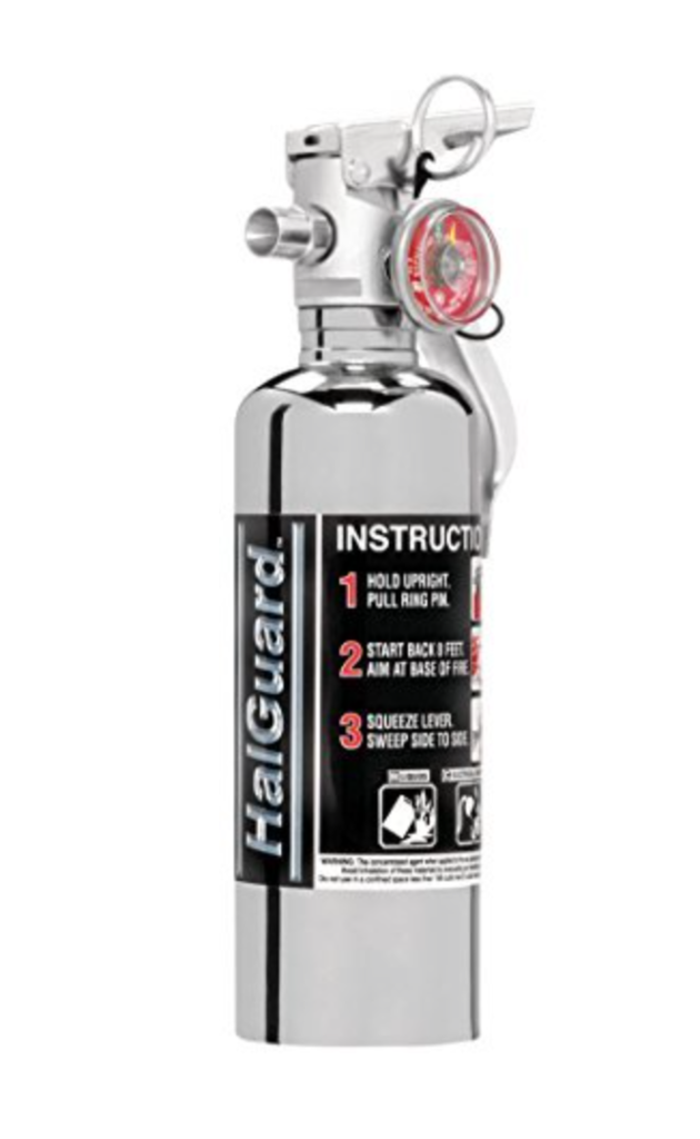

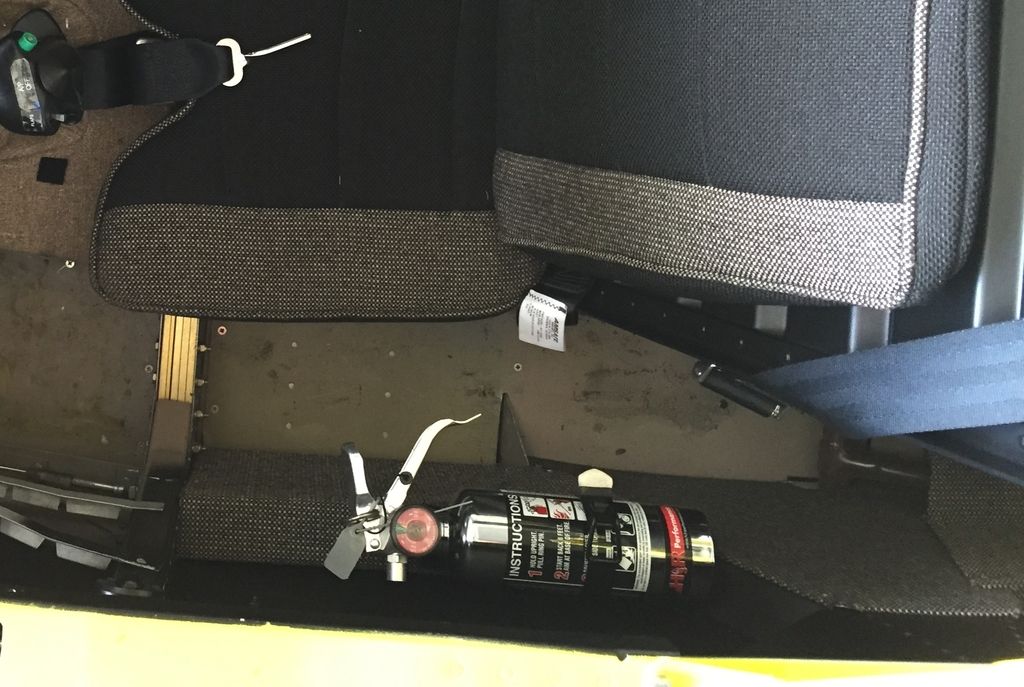

Default My RV-4 Extinguisher
Here's the one I put in my RV-4 - http://amzn.com/B001KAO63G. The chrome version cost an extra $10 but I think it's a nice touch. The cockpit photo is looking straight down over the front seat. I know it looks like the handle might be in the way but it's not. It's well clear of the passenger's left foot and below my left forearm. Easy access for me and doable from the backseat too.
