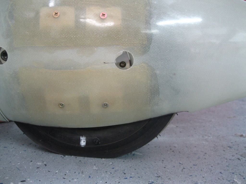

I got mine at a local NAPA store. They have multiple lengths and chrome or brass finish. Don't leave home without one!
Of course the other part of this item is painting a white dot on the bottom of the tire when the valve is lined up with the fairing hole.

Darn, I tried painting the bottom of my tire with a white rattle can.
Maybe I need a picture or something... the paint is everywhere but on the bottom....
Seriously though, when I see simple solutions like this I just smack my head and say, "why did I take all those screws out last time the tire looked low, but turned out to be just fine?"
I am headed for NAPA.

I like using a tire crayon on the sidewall. You can get 'em at O'Reilly's or Pep Boys. Stays put for a long time, but you'll want to touch it up occasionally.

White-out (remember typing errors?) will stay on the tire.........
