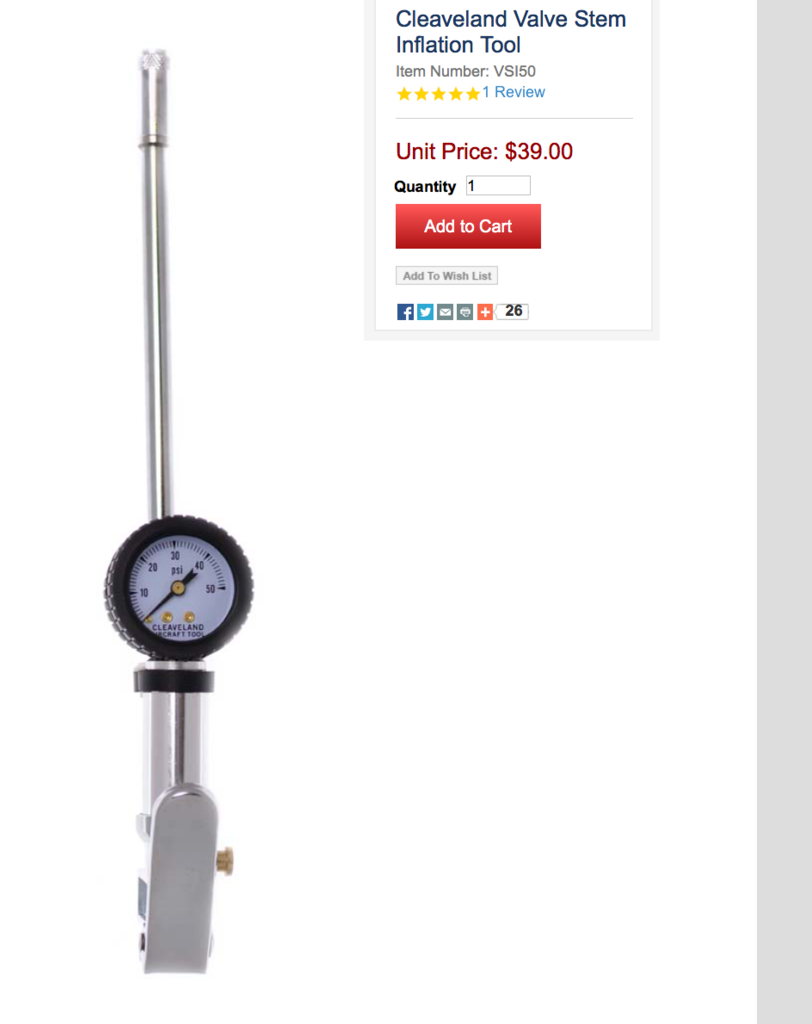

Old 08-26-2015, 12:04 PM
LifeofReiley's Avatar
LifeofReiley LifeofReiley is offline
Location: Round Rock, TX
Posts: 3,778
Even better... LOVE it!!!
http://www.cleavelandtool.com/Cleave.../#.Vd3_h42FOUk

Default Inflator Tool is best
I agree with Reiley, the inflator tool is a superior solution. If you want the cheaper / simpler valve stem extensions you can get them at any truck stop or auto parts store.
If you get the inflator from Cleaveland you should also consider adding the nickel plated buttons to cover the hole in the pants and the nice little valve cap remover / replacer they sell for $14. Just do a search on their site for "tire inflation" and you'll see all these products.

Originally Posted by tomkk View Post
Here's where I got mine recently ... http://www.cleavelandtool.com/5-Valv.../#.Vd38wfRZWPU
I have this one. It has a Schrader valve at the end with a shaft down the center that is supposed to open the valve at the tire when depressed by inflator.....which it does not do. It is as if the shaft is just too short.
I also have the cap removal tool that you can buy with it. The cap removal tool does not fit over the hexagonal caps that are generally used in aviation.
I bought this combination set. http://www.cleavelandtool.com/Valve-.../#.Vd8i0E3luUk
Just a heads up!!
