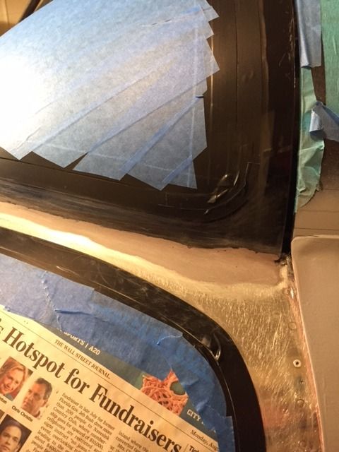

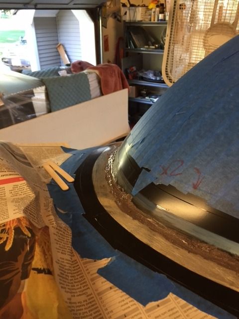

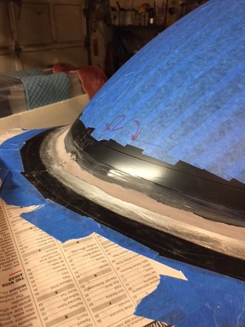

I just did mine in the last few days. I watched and followed the Van's video that was recently added to their RV-14 support site. Prepped my Todd's canopy and the top fuselage skin laying a double layer of electrical tape, and sanding with 80 grit. Used West Systems #105 resin with slow hardener #206.
I bought a small jar of grey tint from ACP ( Aircraft Composite Products) along with other fiberglassing supplies, and used just a pinkie fingernail of it, and it still turned the epoxy slurry grey, despite the micro-ballons being rust colored. The ratio of micro-balloons to liquid turned out to be about 1:1.
It may have been a mistake, but I bevelled the windscreen to more closely match the top skin; consequently, there really wasn't a substantial gap into which I could squeeze the epoxy, but, I'm confident that it is plenty secure. I feel confident because I squeezed epoxy both inside and out. The inner bead turned out pretty good. ( Sorry, no pictures) When I was SIKA-ing my canopy, I learned how to lay a good bead, run a filleting tool across it, pull one layer of tape, re-tool, and finally pull the second layer of tape and then DON"T TOUCH IT! This techniques was used for the inside bead only…the outer bead was applied without any electrical tape boundaries.
The micro-slurry sanded very easily; I glued some 80-grit to a 4" long piece of 1" diameter PVC pipe, with worked quite well. I did the sanding while holding the end of the vacuum hose next to the sanding block, so I was able to do this in my shop; I thought I was going to need to pull the fuselage out onto the driveway in order to keep the dust out of the garage, but the 80-grit produced relatively large particles that were sucked up by the vaccuum pretty cleanly.
Here's the front edge and side/corner areas- BEFORE.

…and here's the same areas-AFTER sanding.( You can see the small bracket I pop-riveted to the top skin to keep the plexi securely positioned while I SIKA-ed the canopy bow.

Looks good, but one comment....
Micro mixture is not for structural bonding. It is a filler only. The actual fiberglass lay-up is what it being relied upon to attach the wind screen to the fuselage
I would recommend (same as shown in the videos) that builders work in such a way that they are maximizing bond area for the fiberglass layup directly to the aluminum and the acrylic canopy. I.E., avoid laying fiberglass over micro mixture (regardless of how thin) in areas that the fiberglass layup is being relied upon for structural attachment of the canopy
