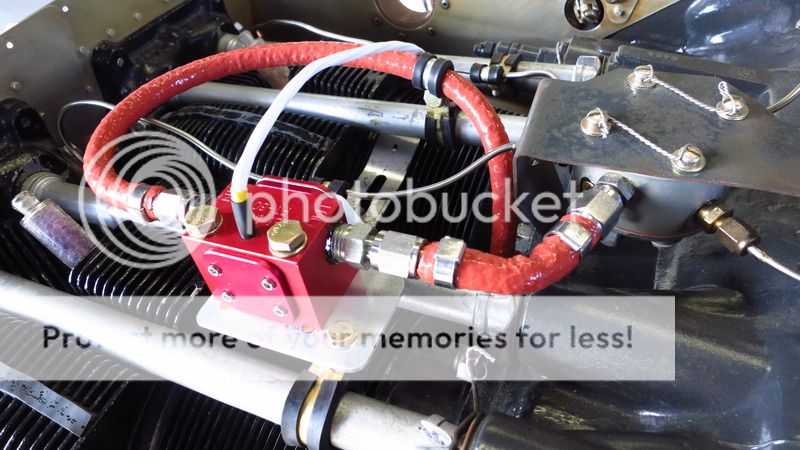

Originally Posted by Pat Hatch View Post
Tom sent us a short hose to try out instead of the adapter. I like it. This is a much better solution. Here are some photos:
That original part looked like a work of art but this makes me warm and fuzzy.

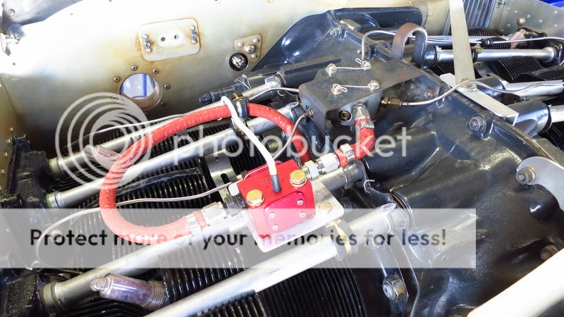

Just a quick observation, but Lycoming SB 342G Diagram 4, recommends
approximately 8 inchs between stainless steel fuel line supports.
This arrangement has moved the supports for cylinder 1 and 3 closer to the spider leaving a fair distance of unsupported fuel line to the injectors.
Also noted that cylinder 2 and 4 fuel lines are missing their supports at the crankcase join (should be 2 supports for each line on that side of the engine).
Cheers

Originally Posted by TS Flightlines View Post
Brian----warm and fuzzy is good. Keeping it simple AND warm and fuzzy AND cost effective is priceless.
Tom
Amen........!

Here's my mounting location, also thanks to Tom...
Firesleeve for cube on order...
