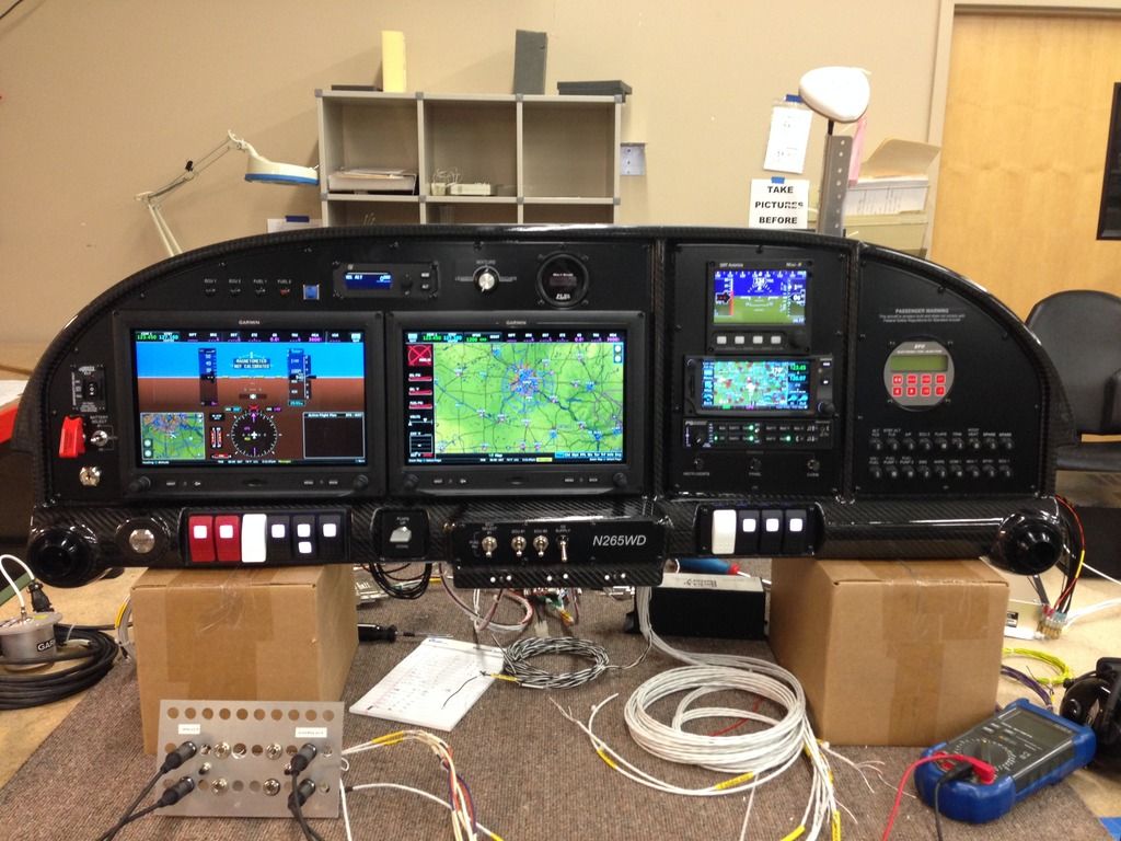

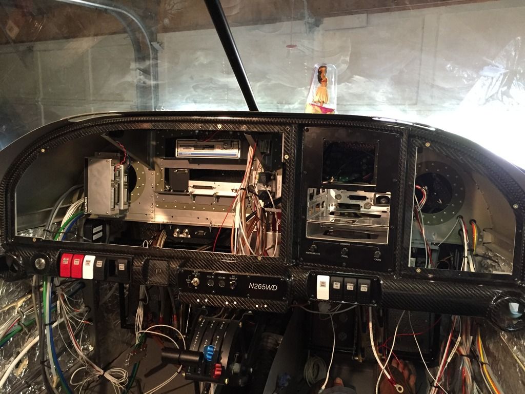

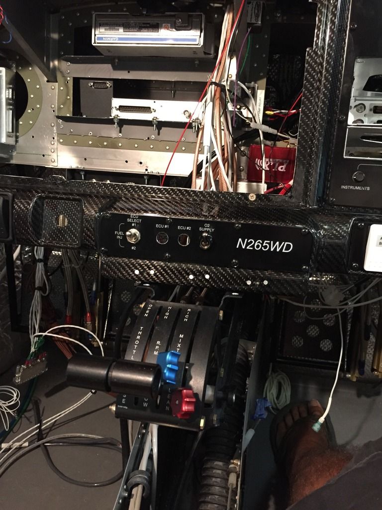

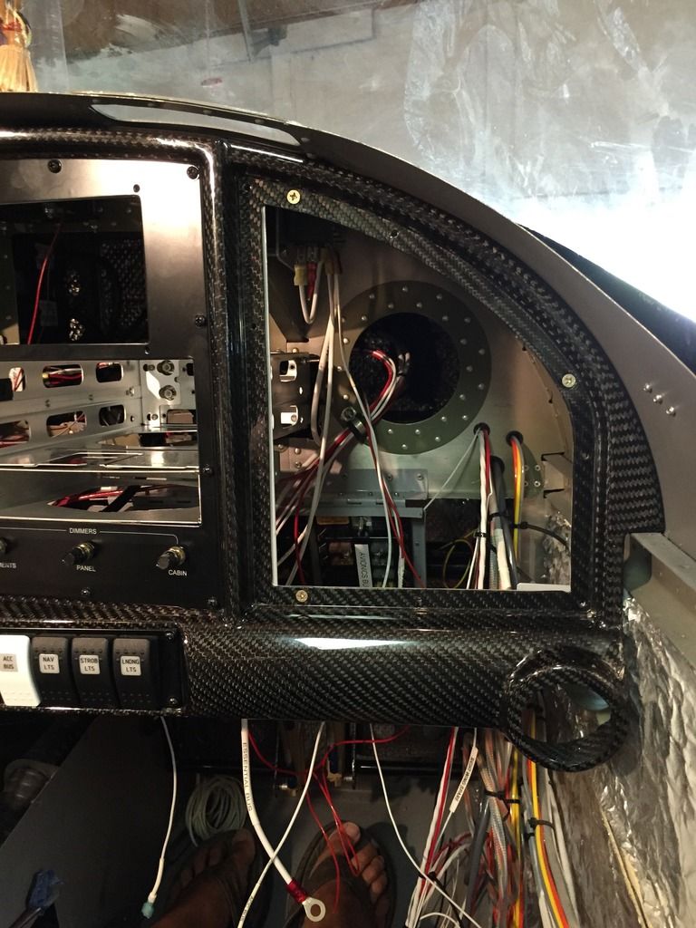

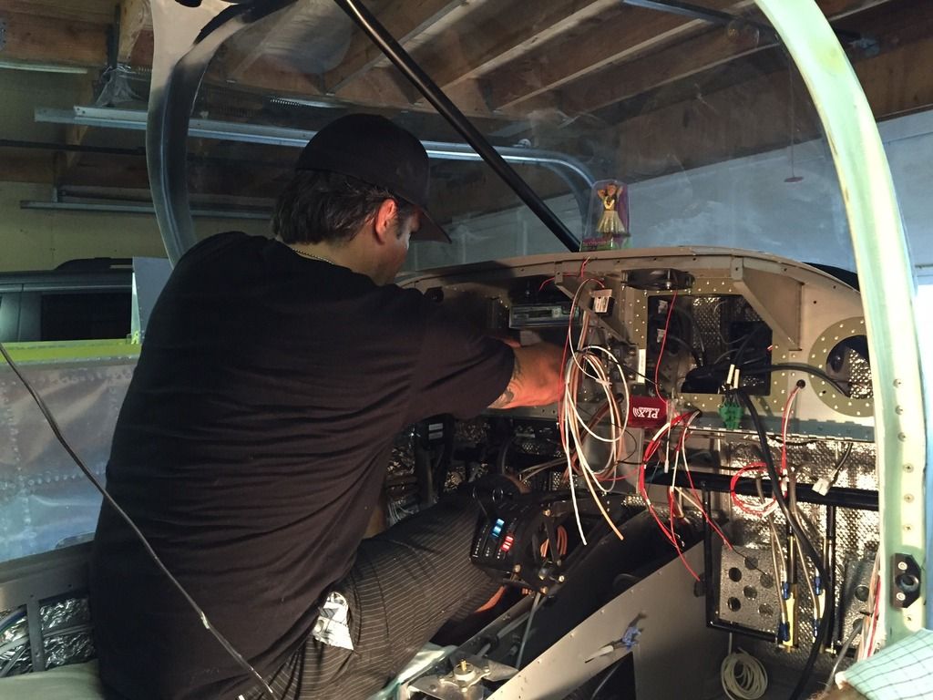

A Little bit of "one step forward, two steps back", but it was nice to get SOME work done after Oshkosh....
At the "lot's of bloody knuckles and 4 letter words point".... Still working on figuring how I'm going to cleanly get all that wire routed where I want it. It gives me anxiety to see it in this state, considering my day job.....
It's hard to see from this picture, but we had to modify the previous holes in the sub-panel to accommodate the depth of the GTN 650... It's getting cleaned up and adding fresh doublers and a couple lateral braces.
