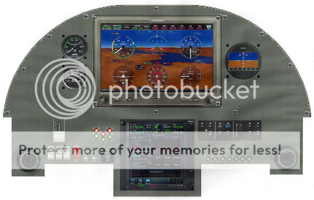

Here is the GTN-650 paired with the G3X...
