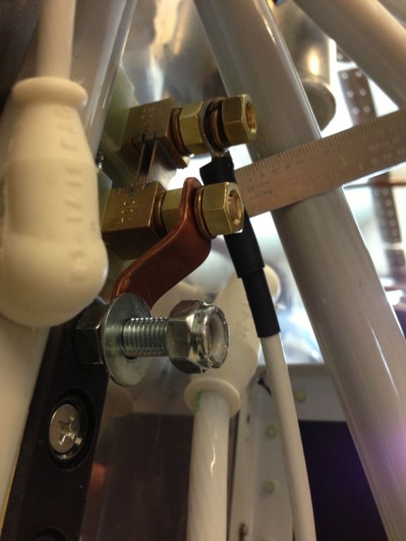

It's not what I envisioned when I put the anl/shunt on the firewall, but before I make anymore wires I wanted to check with VAF. The anl/ shunt is on the right (copilot) side of the firewall about halfway top to bottom. The top nut of the shunt is 1/8 inch from the engine mount tube. The wires and terminals 1/4 inch away.
I was going to put a rubber boot on it and no amount of firewall flexing will make it touch. In a crash it could bend and touch but the master and alt should cut power. Is it too close and I should move it or it is fine and build on?
