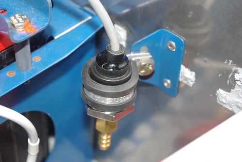

todehnal 05-22-2013 05:25 AM
Remote Mount Oil Pressure Sender
I have decided to install the remote mount kit for my oil pressure sender, during the build. I am trying to select a location on the firewall for the sender. It looks like we have two unused K1000-3 plate nuts on the upper firewall, just above and inboard of the battery. Thinking about using one of those. I noticed a thread by JPILOT, and it looks like he mounted his near the bottom, something about oil drain. Is there a problem with mounting the sensor above it's original location on the engine?
Also, Lockwood send me an alternative elbow fitting, that will start the routing of the hose, from the port on the engine, towards the rear, rather than straight out. This fitting appears to not need a clamp on the hose, other than the fire sleeve. Any guidance on the installation would be greatly appreciated. As a builder, I have been very reliant on Van's well done, step by step, plans set. When I get off into the rest of the world of homebuilts, and left to my own interpretations, I am easily snowed!
To those of you who have "been there and done that", I would appreciate your help on this one.
Tom

I've mounted mine on a bracket and clamp next to the battery. I have made up the hose and plan to run it under the right hand cylinders and secure it with clamps. However like you, this is new territory for me, so I'm open to suggestions.

todehnal 05-22-2013 12:12 PM
The Lockwood kit
The kit that I got from Lockwood included a fitting for the engine port that is a pinhole fitting, restricting the oil flow in case of a hose, or sensor failure that would allow oil to escape.
The hose fitting that is in the picture on the second post is what Lockwood supplies. The hose that is supplied, is an Aeroquip 300psi rated hose. They have been installing these kits on all of the Rotax powered airplanes they support, and have had no issues with the clamps. Let's see what others have to say about it.
I discovered that the two K1000-3 nut plated that I spoke of in the original post, are used for the coolant expansion tank, but I still may be able to hang the sensor on the inboard nut plates with the expansion tank strap.

Tony_T 05-22-2013 08:11 PM
Oil sender location
Here is my experience in moving the oil sender.
I do like your location better.
Tony

I got the Lockwood kit. I used the upper outboard bolt that attaches the Skyview engine module to the firewall. I attached a adel clamp to that to hold the relocated sensor. Works fine. If memory serves, I think I went to the hardware store and got one 90 degree fitting that wasn't in the kit. That may vary based on how you route your line. Also, and I don't know if it was really necessary, but I charged the line with oil as part of connecting it all up. Note that your oil reading will be slower to come up after engine start - will take a few seconds.
rgmwa 05-22-2013 09:12 PM
Thanks for the link Tony, I didn't know you'd moved yours. I looked at taking the hose over the top, but there are already a lot of hoses and the plug leads crossing there and potentially rubbing on each other. Going underneath was a shorter route and less congested. It puts the hose closer to the muffler, but still fairly well clear. I discussed it with my tech counsellor and he thought it was OK. I was going to put the bracket on the firewall shelf with the sender horizontal, which seemed a neat arrangement to me, but he felt that might not provide enough strain relief. With the sender mounted where it is now, the hose curves up from below into the fitting and has plenty of flexibility. Where it passes under the cylinders I'll secure it with Adel clamps. I don't know if this approach is better or worse than any other, but I guess time will tell.

Mine is the Lockwood kit, and it comes with those barbed fittings. The fitting at the engine end has a pinhole restrictor. The hose is a push fit and secured with Oetiker clamps.
