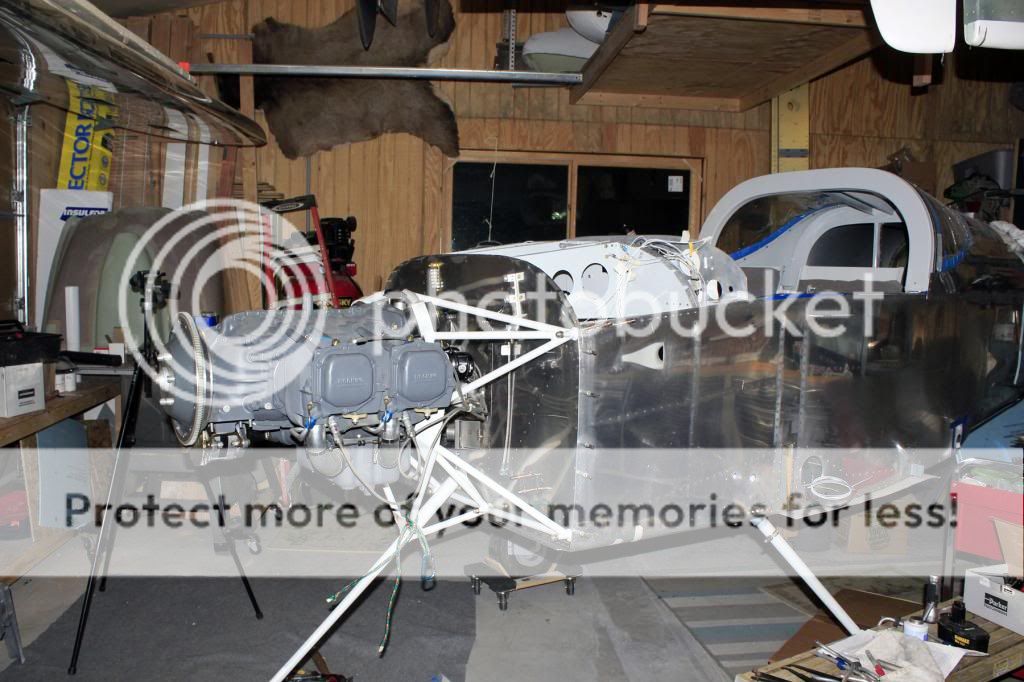

rockwoodrv9 03-17-2013 09:56 PM
Good deal Greg. But.. I beat you by one day. I got mine hung on Friday! What a good feeling! Now the fun begins.
[IMG][/IMG]
[IMG][/IMG]
bruceh 03-17-2013 10:55 PM
Looks like progress! How come no wheels?
Getting the engine on opens up a whole new chapter in the build.
BSwayze 03-18-2013 05:06 AM
Congrats, Greg! You, too, Rockwood! It's a great feeling, isn't it? Good luck with all the great stuff that follows!
airguy 03-18-2013 07:20 AM
Looking good Rock! Keep it up, you'll probably beat me into the air, I have limited free hours to work on my bird, I'm most likely 10-12 months out right now.
Bruce - I left the wheels off for now just so I can easily work on the panel and engine wiring without adding several inches of height on the airplane. I've got overhead hoist lift capacity over the airplane so getting it up again to mount the wheels will be about a 10 minute job, and this keeps it low enough for easy access to everything without using a stepstool.

rockwoodrv9 03-19-2013 08:41 PM
Jim,
Nice to see you got your engine on and on the wheels. I may have jumped the gun because I don't have my panel done yet and it is a PAIN working on the interior. I put the wheels on little HF dollys so I can move the plane around easier and that makes it 4" higher. I may take the gear off and put it back on the fuselage cart I have. I hate using a ladder to get in!
