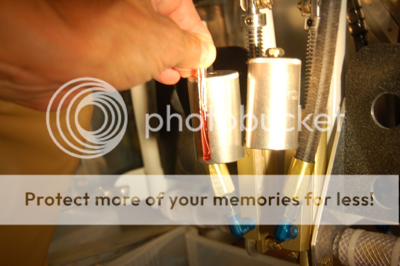

Has anyone installed the individual hydraulic reservoirs directly on the brake master cylinders? And if so, how is it working out so far? Pro's/Con's?
Vlad 03-01-2013 07:09 PM
I did. Not RV8 though...Working great for almost 700 hours.
The only challenge is checking fluid level.
RV8RIVETER 03-01-2013 07:43 PM
Many have on the -8. I have and works fine. I installed 1/8 fittings on top so when it comes time to exchange the fluid I can connect a line to it and fill from the brake calipers without making a mess.
cdmiller 03-01-2013 10:14 PM
They work fine
I have independent reservoirs on my RV-8. They have worked perfectly for over 1200 hours. I remove the front baggage compartment floor to check or add to the fluid levels. It is a little bit inconvenient, but doesn't need to be done very often. I use hex-head 832 machine screws to hold down both front and rear baggage compartment floors. They can be installed/removed easily with a small socket attached to a flex drive and an electric screwdriver.

SHIPCHIEF 03-02-2013 08:59 PM
I used the stock reservoir & firewall location. Then I 'discovered' the direct mount reservoirs.:( I would have gone with them just to save on the plumbing, etc.
I agree with Dan on the baggage floor. I use allen head capscrews instead of hex head, but the idea is the same. Those philips head screws wear out too easily. I use allen head capscrews on a lot of the inner panels that require frequent removal.

PaulT 03-03-2013 02:15 AM
Wasn't there an issue with rudder/pedal travel (master cylinders hitting the firewall) if the pedals are set forward? As I am quite tall, this would be the only concern I would have.

SmilingJack 03-03-2013 09:21 AM
Yes, I have ground adjustable rudder pedals and can not set them full forward.
No big deal for me, but could be a concern for taller Pilots.
DanH 03-03-2013 11:08 AM
You can relocate the reservoir to the corner of the front baggage compartment, run a hard line to a splitter, then run SS braided teflon lines down to the master cylinders.
