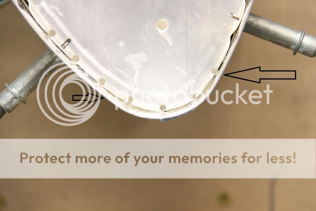

For those not familiar with this issue, the fuel tank skins have a slightly different manufactured radius than the tank ribs. With the tight prepunched tolerances, that is all it takes to make this a pain. Look closely at the rib/skin clearance starting at the big arrow on the right and working toward the smaller arrow. This is standard across all fuel tanks-QB and SB. I compared mine to several completed -10s during tank construction, and they are all the same.
Like the VS nose rib, this is one of the few quirks of the kit.
