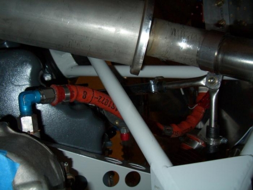

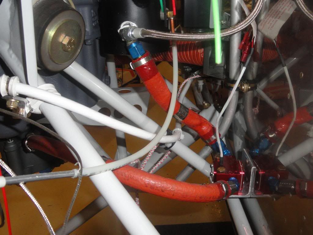

WingsOnWheels 01-25-2013 04:54 AM
Here is how I installed mine just recently on my O-360 RV-6A. This location only required one new hose to go from the engine pump to the cube. I was able to use reuse the pump-to-carb hose. I put a 90* on the carb and a straight fitting on the Cube. The hose is just the right length. I swapped the outlet fitting on the pump from 90* to straight (at $3.90 part from ACS) and put a 45* on the inlet to the cube.
ron sterba 01-25-2013 11:13 AM
Colin , You did a nice job of running the lines straight in and out of the cube as it says on my info sheet. I think I'll go that route. Good install! Thanks Buddy.

BruceP 01-28-2013 10:35 PM
How much of a problem...
do you think I will have with my installation? I was aware of the directions to have straight fittings but I ended up with a 90 in and 45 out. Rather than spend more money on new hoses and turn the cube around as shown in the previous post (nicely done!), I thought I would give it a go and see how the accuracy is before I changed it.
Wayne Gillispie 01-28-2013 11:27 PM
What is the white ? on your mech fuel pump outlet fitting?
WingsOnWheels 01-29-2013 08:03 AM
From what I have seen around the forum, the straight in/out requirement is not critical on the red cube. You will probably be just fine.
The main reason I ran my lines the opposite direction was to give better clearance to the vetterman mufflers. If I use the 45* fitting off the carb it puts the fuel hose very close to the muffler (almost touching). By running the hose up the middle I don't have to deal with that problem anymore, and my cube got installed at the same time.
BruceP 01-29-2013 01:29 PM
Thanks Colin. Wayne, strangely, the white is a camera flash artifact, there is nothing white in or around that area.

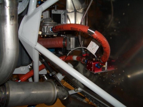

crabandy 02-07-2013 07:49 AM
My red cube instructions Rev C: 3/31/10 stating it must be downstream of the last fuel pump, wires installed up, and the outlet port not to drop down after exiting transducer. Nothing about 90 or 45 elbows.
I used the vans KB-090-T fuel pump fitting, vans VA-138 to a 822-6 inlet to transducer facing the cowl of airplane. Transducer outlet is 823-6 and another VA-138 with to an 822-6 on the carb. This clears the exhaust nicely and Three fuel hoses are all the same length. The Aluminum fittings are mockup only, steel are in the mail.

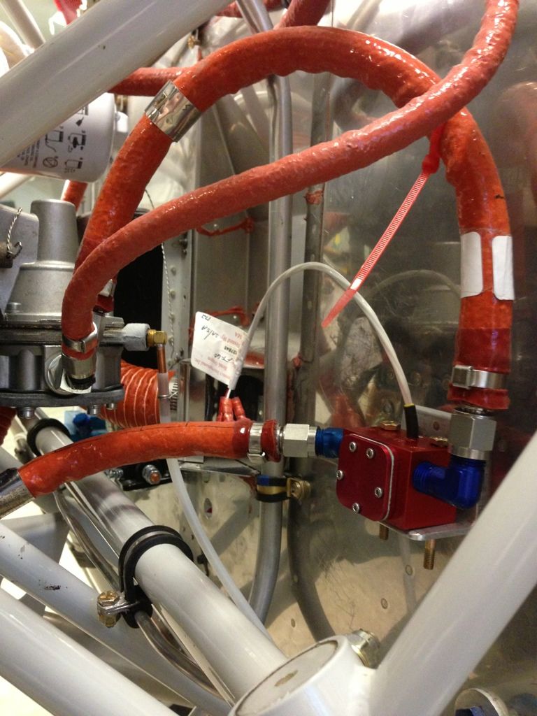

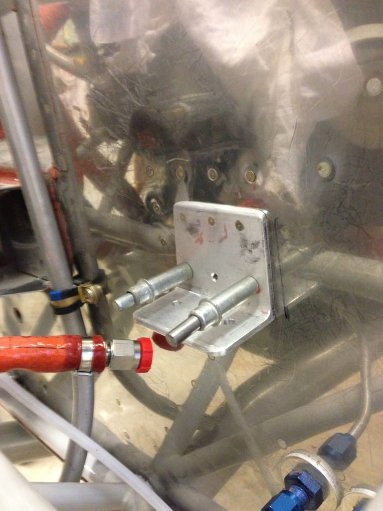

rzbill 03-11-2013 04:37 AM
Here's mine
My red cube mounting is similar to what has already been posted but it is different enought to share. 100hrs with no probs.
The bracket is lighter weight fabrication and my fuel pressure connection is simpler.
Bracket Fabrication
Attachment to firewall
The following is the only shot I have of the hosing. It is during construction so not finished but the differences I wanted to show are there.
Inlet hose and fuel pressure
crabandy 03-11-2013 04:47 AM
Bruce,
On my install I was able to use the gascolator to fuel pump hose (I forget the part # but its the shortest one) for mocking up my fuel flow location.
I ended up with 3 hoses all the same length, 1 gascolator to fuel pump-1fuel pump to red cube-1red cube to carb. I used vans 90 fuel pump fitting with the port for fuel pressure, a 90 elbow on the inlet to the red cube and a 45 exiting the red cube and a 90 on the carb.
To find the best location for the cube I made my red cube bracket and inserted the fittings and hooked up the hose from the fuel pump to the red cube and vans stock fuel pump to carb line and moved the cube around the firewall until I found the best clearances for both fuel lines. You can get the approximate position reference the rivets for the firewall stiffener/brake lines.
I had TS Flightlines make my additional hose as well as shorten one of the stock vans hose.
