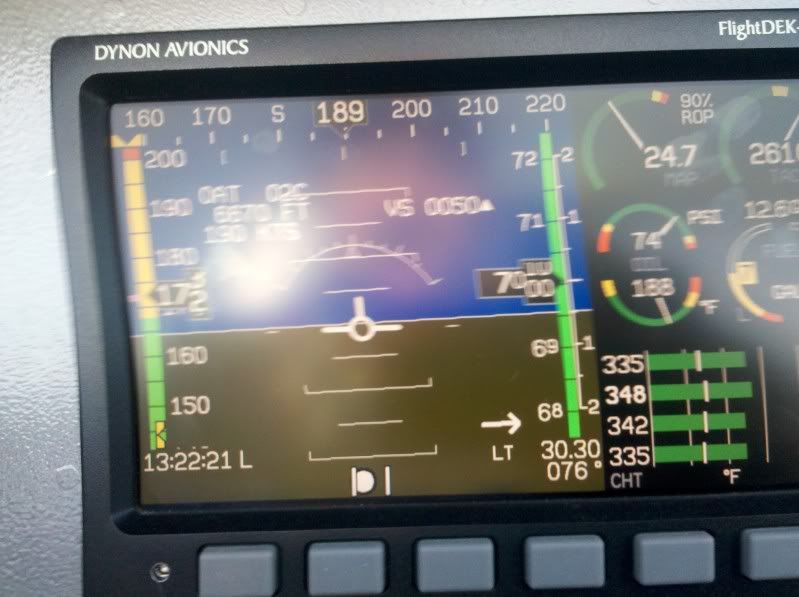

Jamie Aust 01-25-2013 03:06 PM
Originally Posted by RV10inOz (Post 737976)
In 100% of cases with plenums on RV7's that I know of, they all have chronic CHT issues.
Here is a picture of my chronic CHT. ;)
I still have a problem with #3 in the climb, it will hit 400F, if I climb slower than 100kts, once I level off I can see 350 - 360 F on all CHTs.
I love my DIY ( experimental ) plenum, however I would be just as happy if I had made a baffle system.

RV10inOz 01-25-2013 08:46 PM
Jamie, you should be saying if you climb slower than 120+ knots, you are only using 100 on initial climb out.
And at 29LPH, despite the Dynon being confused there about ROP, the CHT's should be down around 295-310, exactly as others report. I have had a few PM's on this thread, all agreeing but not having taken the time to photograph it. I hope they do.
Experiment for sure, but don't settle for something less than optimal is what I am saying.

**EDIT** Here are pics from a flight today. 70% power (both from RPM/MP Lyc chart and LOP 14.9 calc)
Sorry for the fuzzy pics. Poor field of focus on camera setting. Images were taken a few seconds apart.

LOP & Percet power
I think what may be missing in this discussion is what is true % power these CHT's are recorded at?
I believe % power calculations are based on ROP, at least on GRT equipment.
Try using Fuel flow / 14.9 (assuming 8.5 CR), you probably will find you get a much lower % power than your engine monitor, hence the lower CHTs
