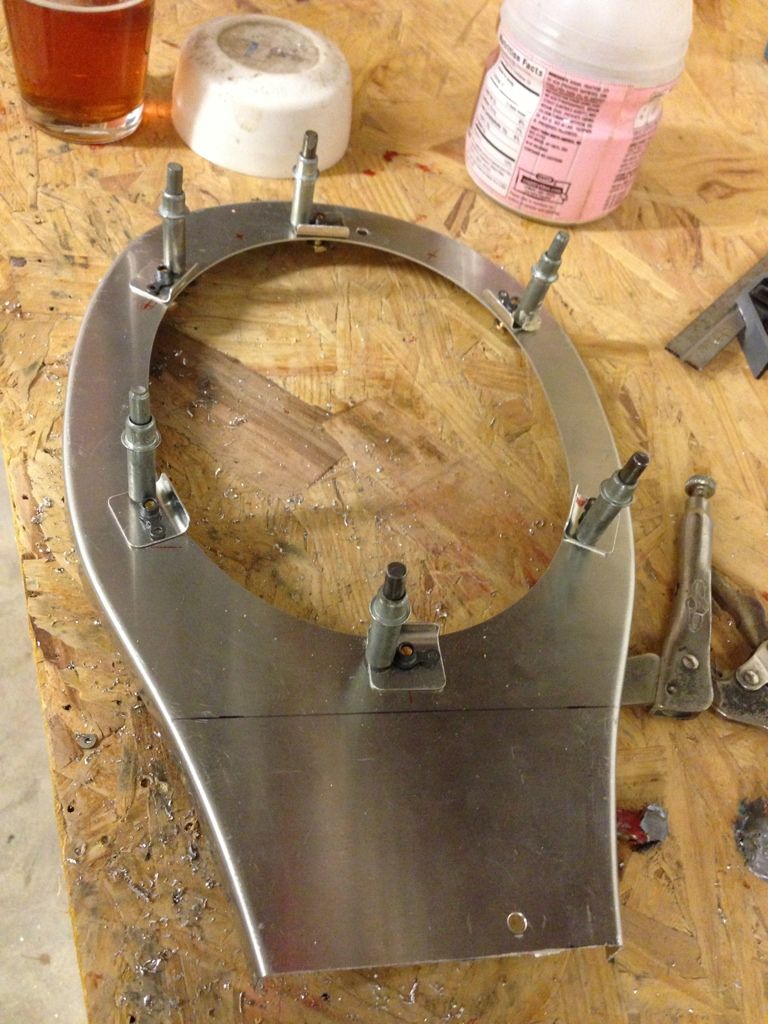

Tonight's progress on the FAB top plate.

crabandy 01-04-2013 08:37 PM

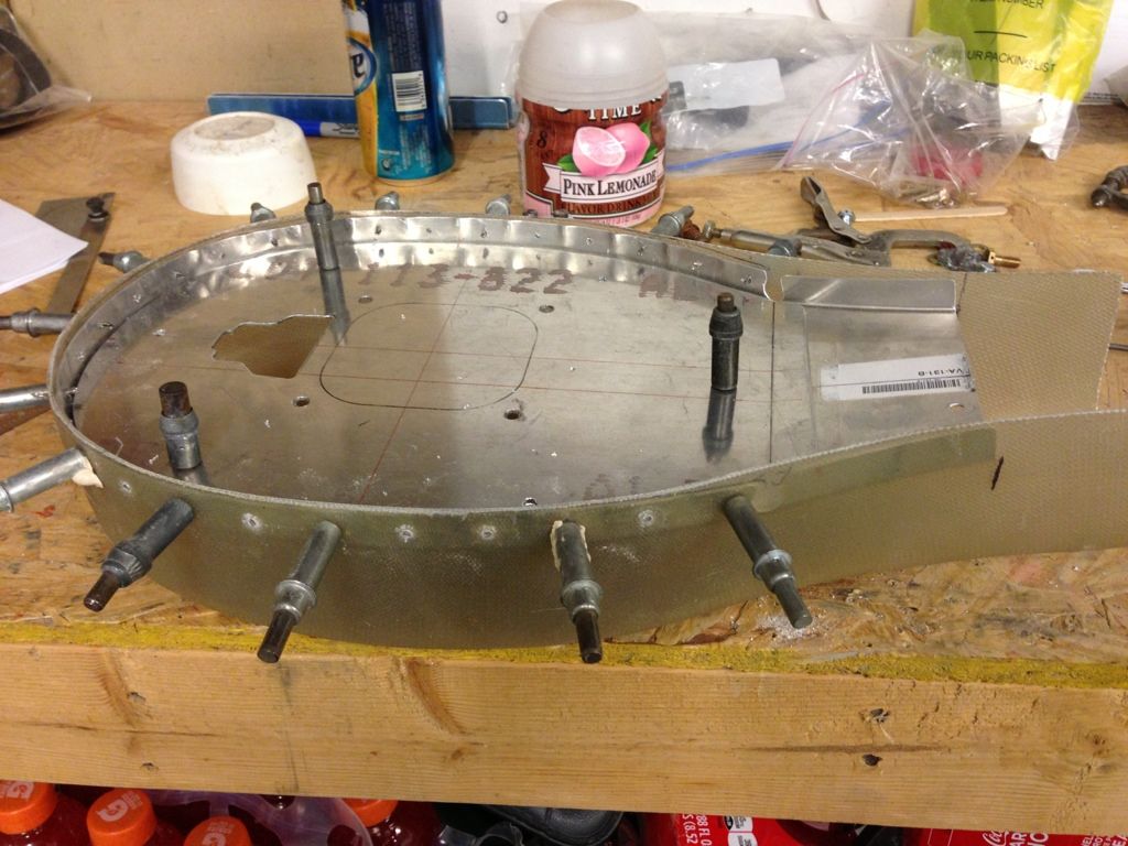

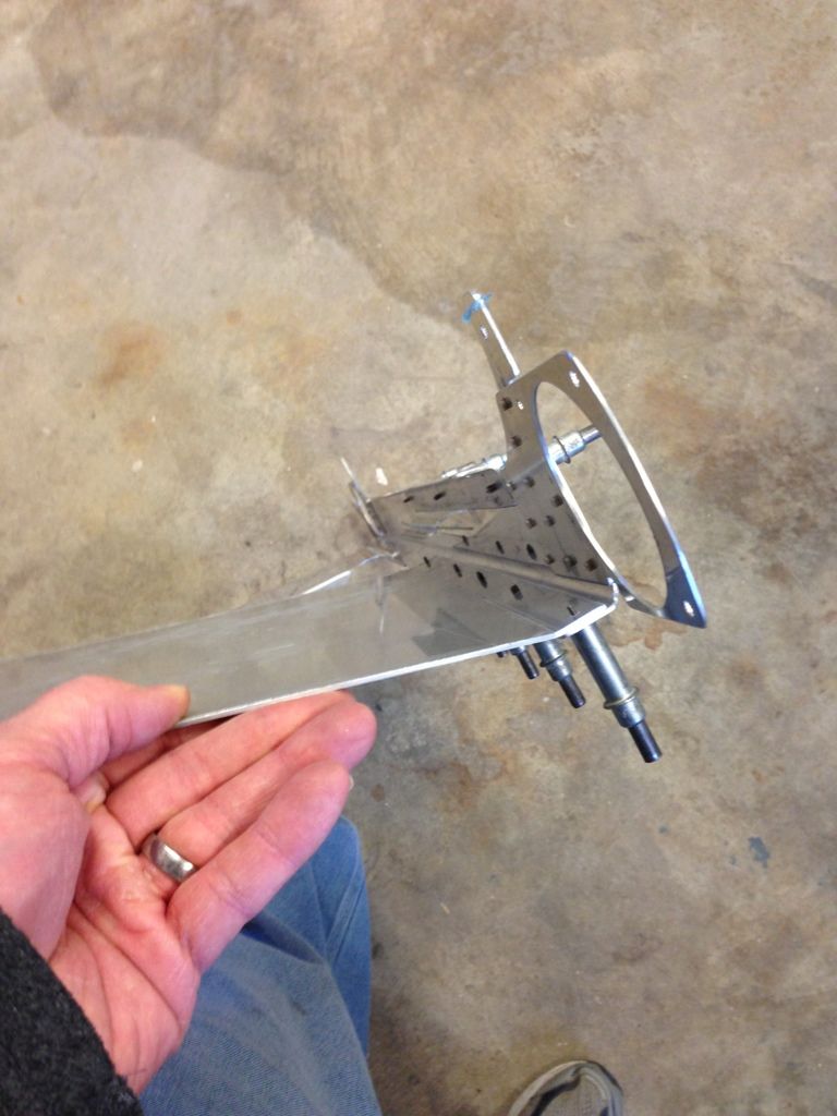

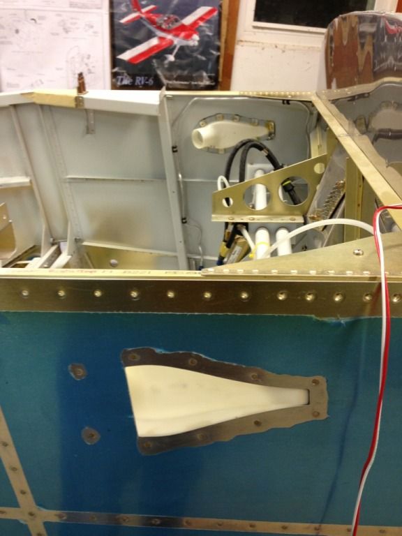

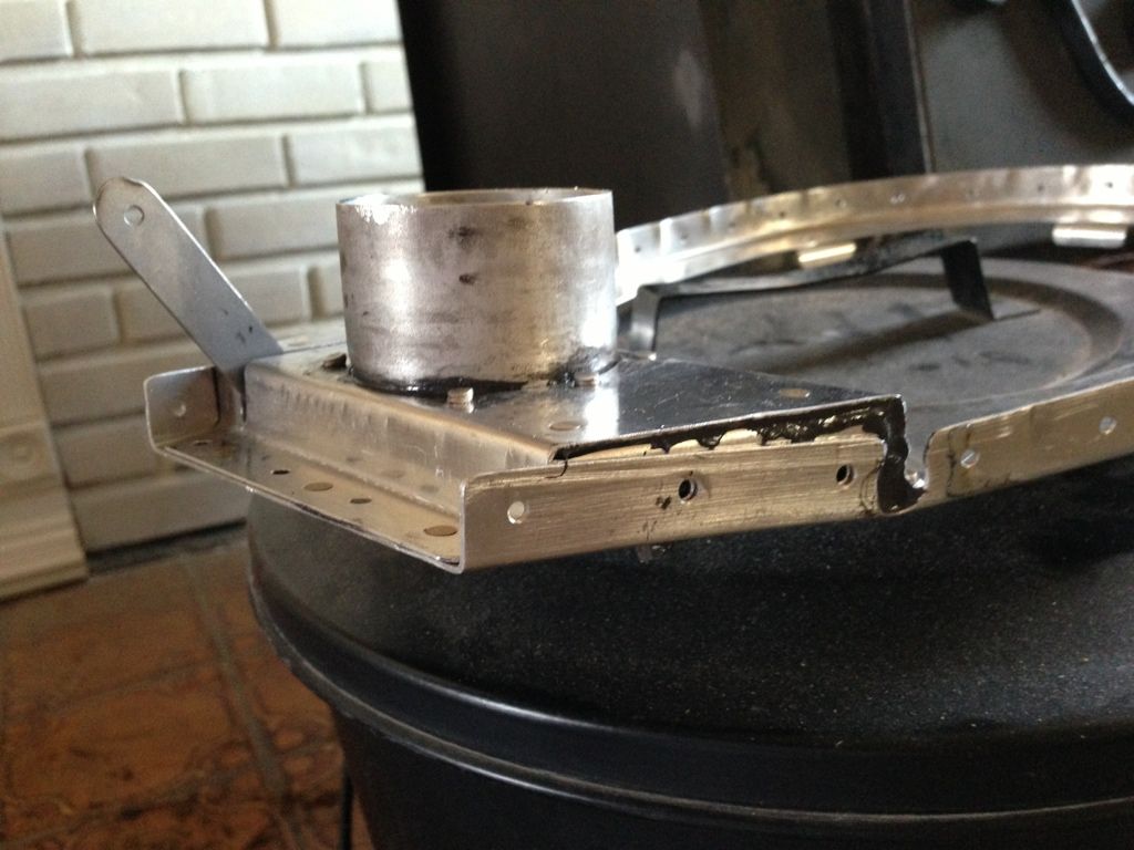

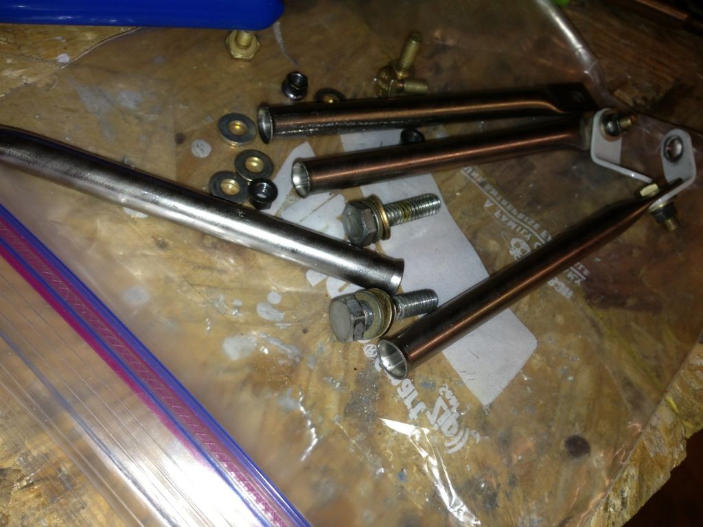

Finally back at it after the holidays, riveted nut plates and filter retainers deburred etc. I bent the FAB top plate to match the air scoop using a cool angle finder app and drilled it to the fiberglass bottom. 3 hours and 20 min man I'm SLOW!
crabandy 01-05-2013 04:32 PM
Cut air box to fit snorkel.

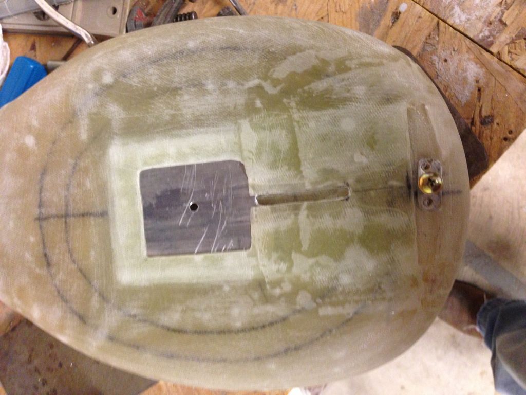

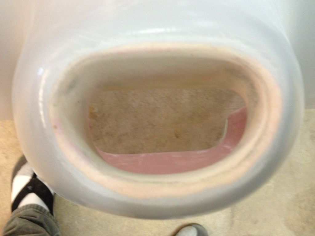

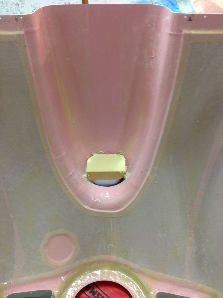

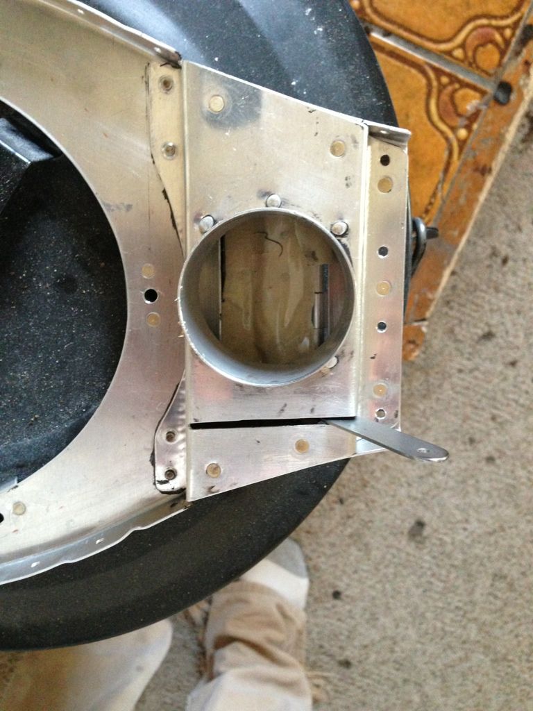

crabandy 01-06-2013 07:18 PM

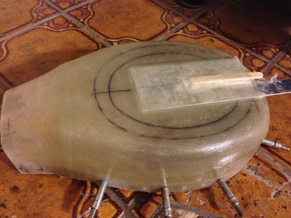

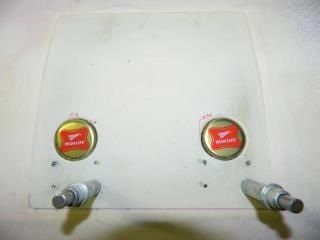

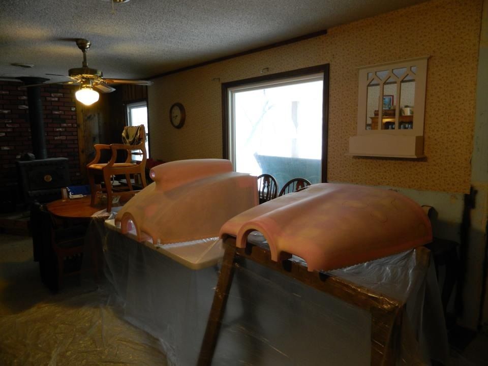

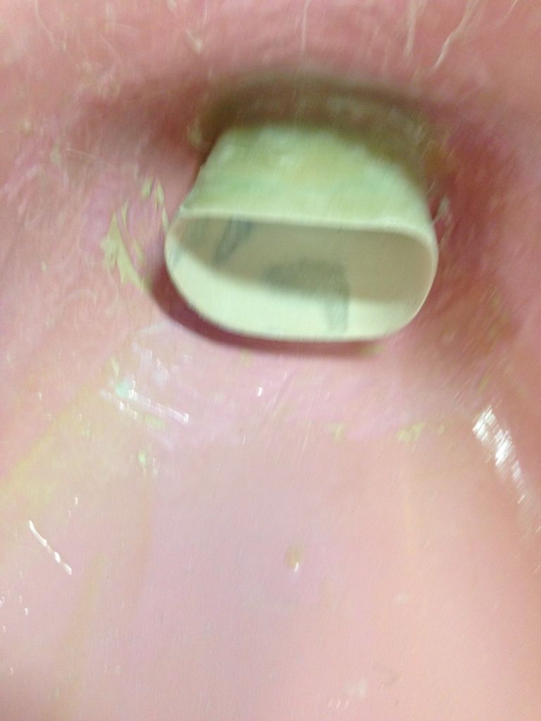

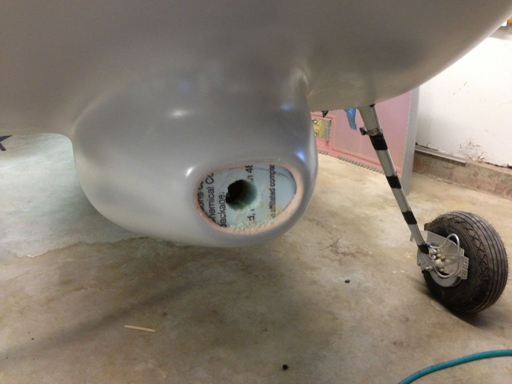

Fiberglassed the scoop back on and decided to try and make my own air bypass. The stock bypass has some bad reviews and you cannot reset without pulling the cowl. I taped up and waxed a piece 3x6x.063 scrap and glassed it to the bottom of the FAB. I added a couple of Popsicle sticks to the center so I could cut out the center for attaching the cable, I left the back open so in theory the .063 will slide right out once its cured. I'll find out tomorrow!
crabandy 01-09-2013 08:20 PM
Waiting for the epoxy holding the foam in the scoop to dry so I can carve and glass it before work tomorrow.
Some of my ugliest fiberglass yet on my alternate alternate air, I told myself no one would ever see it.... I really hope no one does.

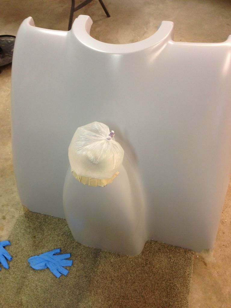

crabandy 01-10-2013 03:21 PM
You would think with two little girls there would be a balloon in the house/garage somewhere but had to borrow the lettuce bag.
I just put one layer in the first night just in-case it didn't turn out I didn't want to sand multiple layers of glass. Next day it was great, the glass conformed Perfectly to the foam. I bought balloons (per Vans plans) and put 2 more layers of glass in but when I blew up the balloon it required too much pressure to expand and slowly squeezed the fiberglass out of the scoop. Back to the fridge to snag the last veggie bag, green onions. Maybe the "hot dog" shaped balloons would work better than veggie bags, probably smell better than onions too!

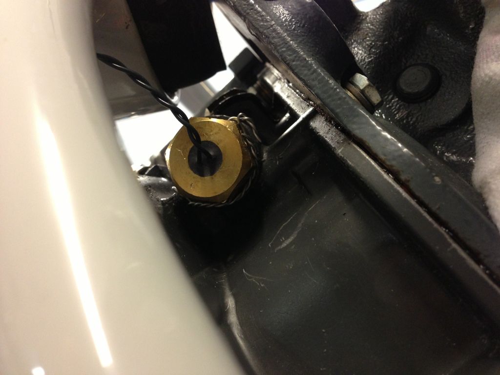

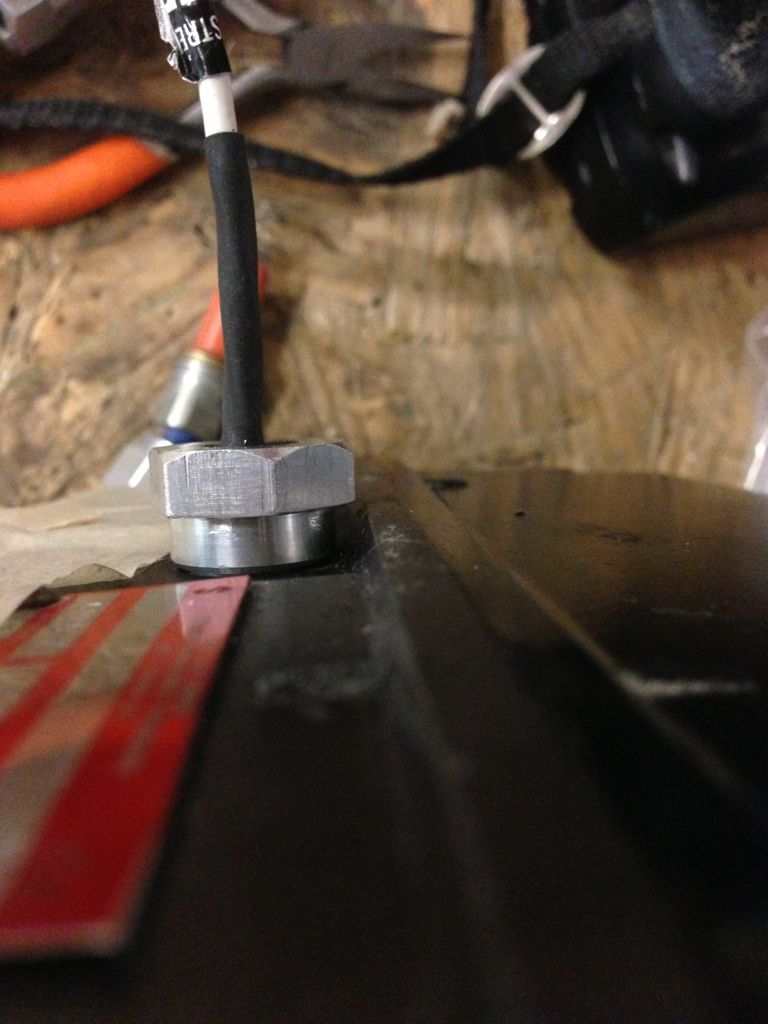

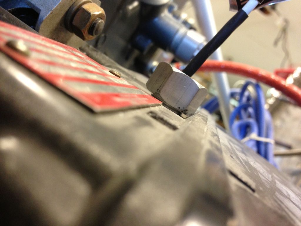

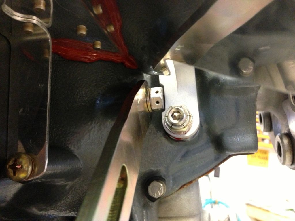

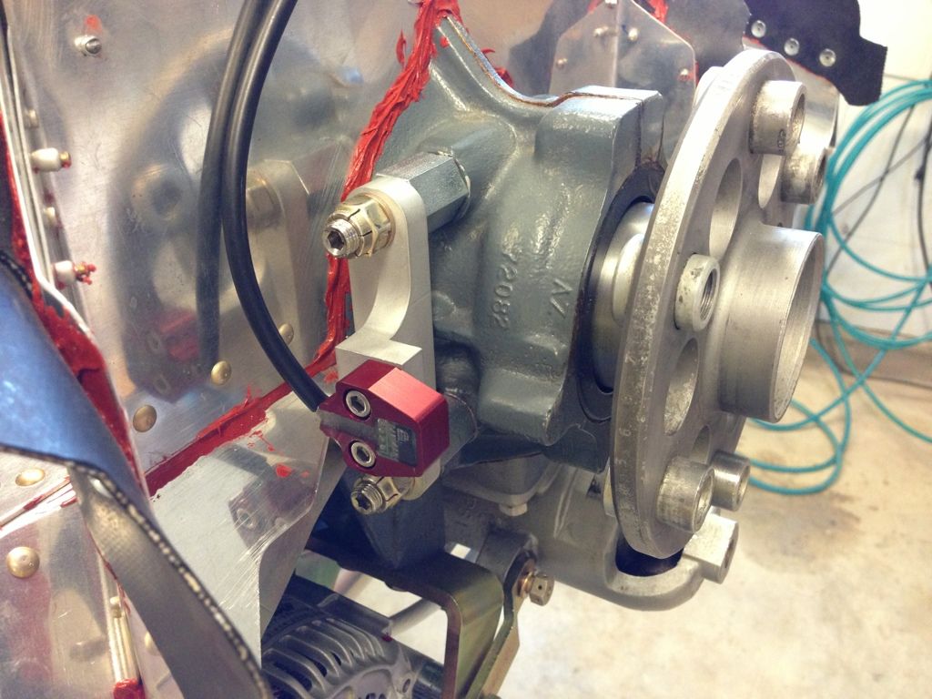

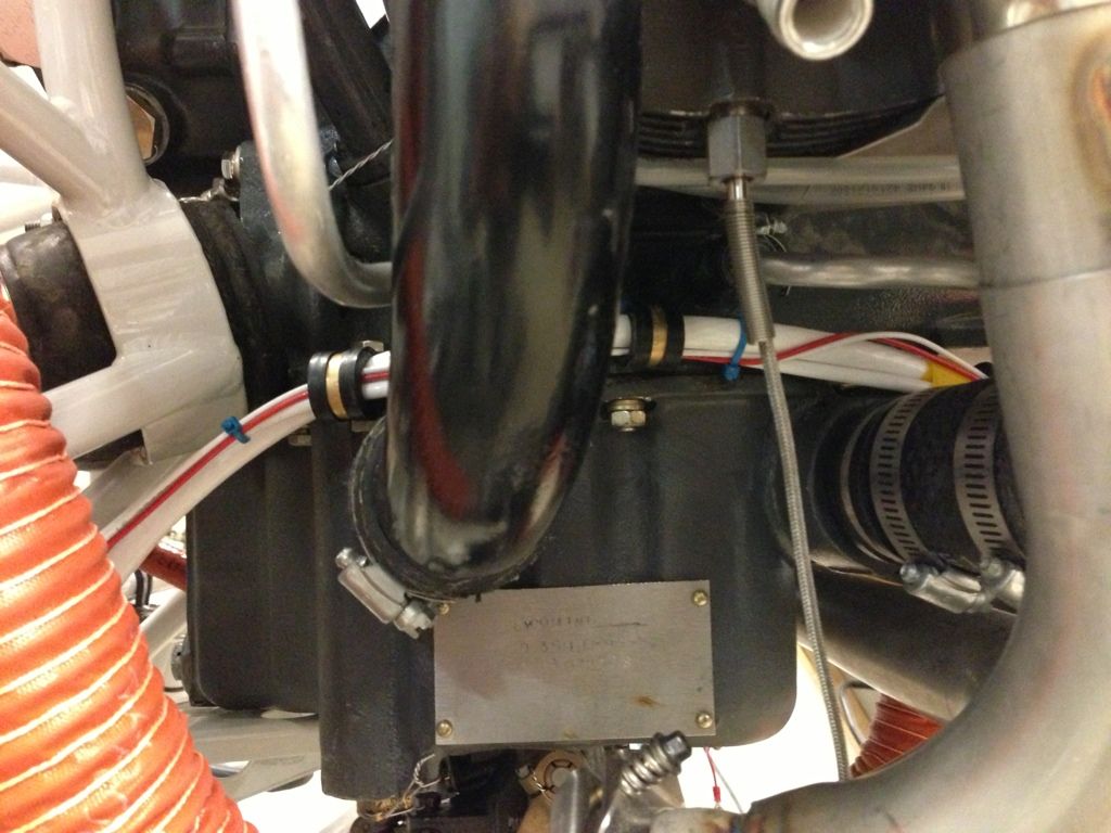

Installing G3x engine sensors
Had to clean cylinder head ports with a tap to get the CHT sensors installed, also installed/safetyed oil temp and plug.
I have a little clearance issue on the Hall effect sensor for my single dual bendix mag, solution on the way.
crabandy 01-20-2013 07:00 PM
After Matt's machine shop it fit great, now to figure out how to reinstall/time the mag.

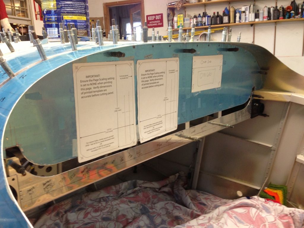

Figuring out panel layout...
My youngest helping me with panel dimensions.
crabandy 01-23-2013 09:34 PM
Panel
I decided to make the panel 3/4 inch longer to match the bottom of the air vents and give me more of a fudge factor for fitting the avionics and switches. Stock panel theoretically would fit everything. The nutplate between two lines is about 3/8 inch for overlap of panel face. The face itself is another 3/8 taller for the total 3/4 inch.
I'm trying to piece it together without buying to much extra metal, hopefully it won't look pieced together when I'm done.
I really need a bandsaw but at this point in the project I'm pretty handy with the die grinder and with my daughter holding the workpiece it came out very straight.

FAB to carb mounting plate, I used a homemade cork gasket between the plate and the carb as well as area washers to hopefully help keep it from cracking.

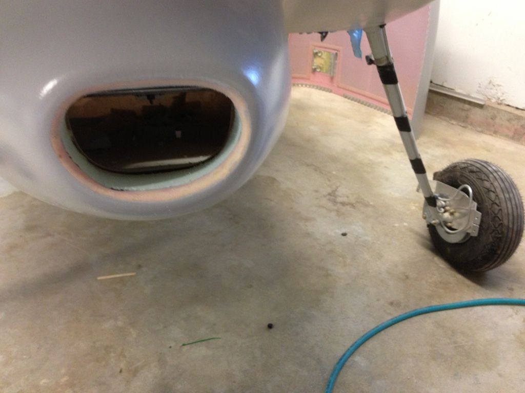

Still trying to come up with a decent seal between the cowl and the FAB, the plans way seems to be backwards to me but here's a version of it. Seems like I should attach and seal the fabric to the outside of the cowl scoop and have the fabric lay on the inside of FaB.
crabandy 01-28-2013 09:31 PM
I'm not a fan of the fit, more of a flapper than a seal. Time to break out the die grinder and fiberglass

EGT probes, #3 cylinder proved to be the tightest fit and dictated the distance (2 inches) to clear the pin and stay the required 2-4 inches from the head.

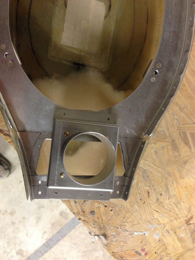

crabandy 02-07-2013 03:50 PM
I cutoff and reglassed the front of the FAB to make the inside flush with the outside of the cowl scoop.
I made a clamp and will glue and seal it for final fitting.
Tuck the fabric inside the cowl scoop and fit cowl and its close, just a tad more trimming to get it to lay flat.

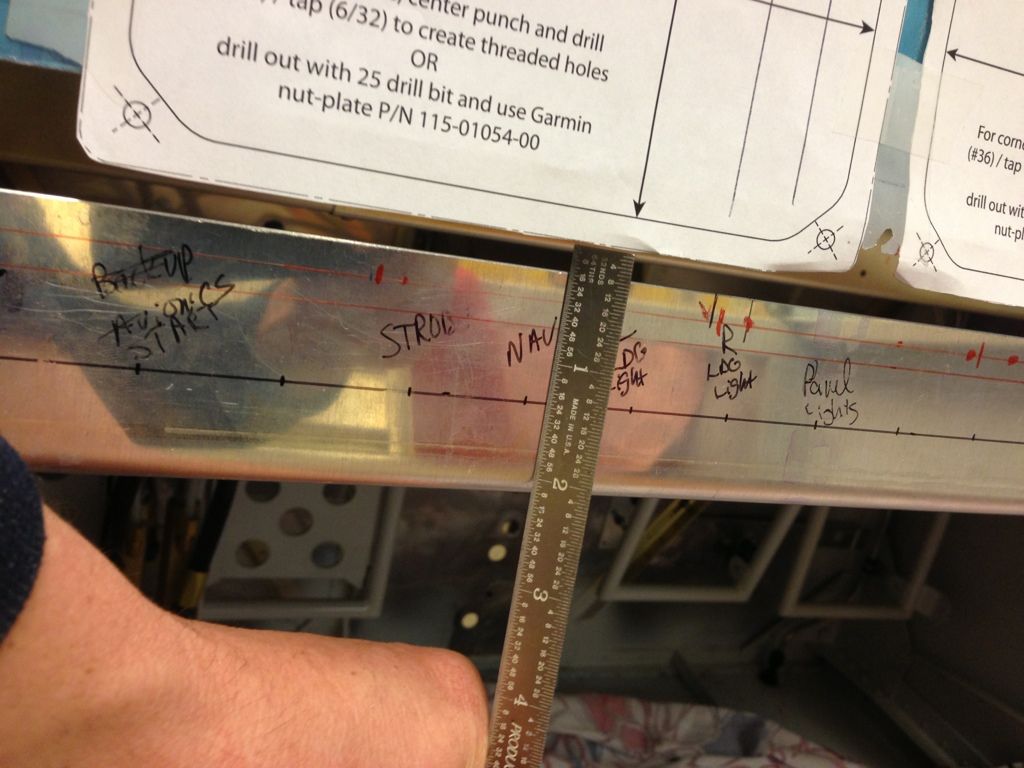

Finally made my mind up and time to move on, aeroelectric diagram Z-13/8. It gives me a lot more options for backup power as i add an autopilot and other flight instruments later. I'm planning on installing the aft firewall stuff now and defer the dynamo and associated stuff till later.
Double checked dimensions for the screws/nutplates on the bottom rail and still have clearance for the switches .
Leveled the plane...the tiltmeter app was pretty handy for the next part.
I laid out the holes for attaching the panel and drilled an angle along the bottom rail. I had to coax the angle to a 100* in order for the top plate to be flat, leveled back and drilled the another angle to the subpanel. The whole assembly is twice as big as I need it so I can mount the GSU 73 in several places and cut down later.

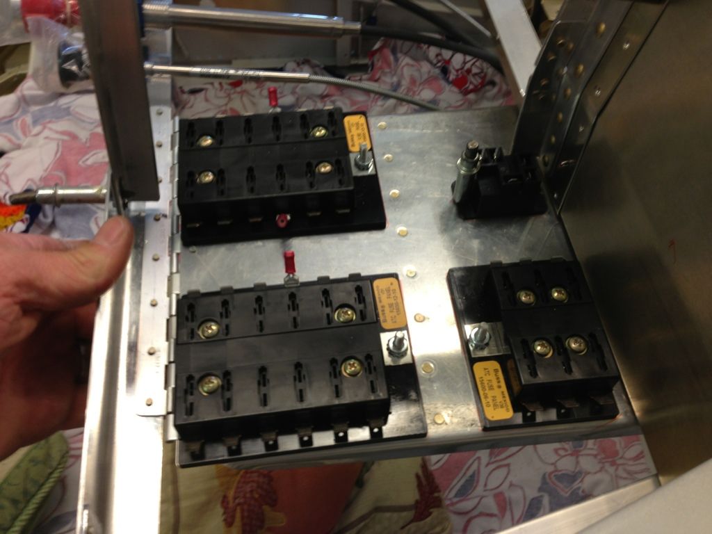

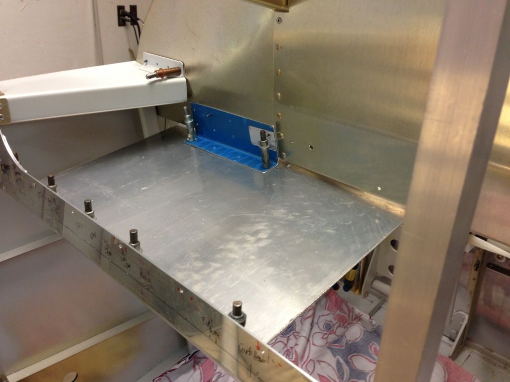

I've got another idea for the GSU 73 mounting table, but I need to borrow a brake. I finally decided on a location for the hinged fuse tray.

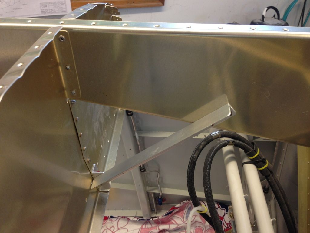

crabandy 02-19-2013 11:12 PM

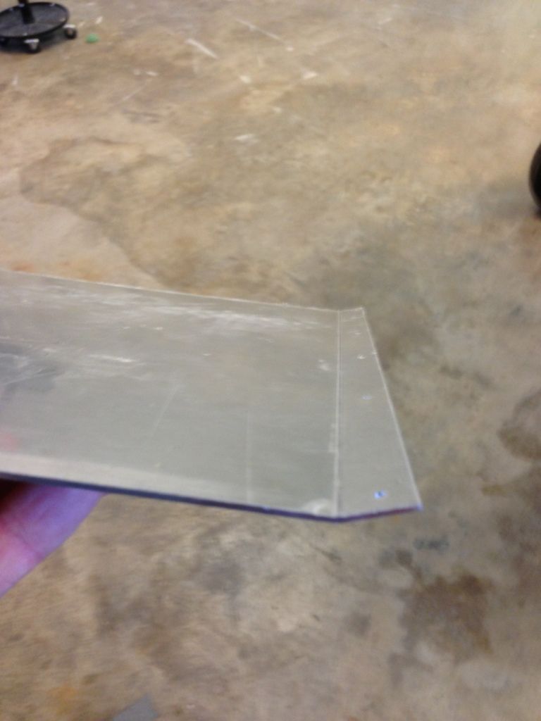

My usual bending brake (bench top and clamps and various plates) wasnt giving acceptable results with the small bend on .063. My local heating and air (thank you Adamson Bros) has an 8 foot brake they let me use. I can't wait to get equipment like that!
Drilled to the lower panel
Drilled to the subpanel.
The tiltmeter app is pretty handy, but probably a little too accurate. I keep trying to readjust to the 10th degree.
I don't want to add support angles or cut the floor plate down until I actually have the GSU 73 in hand.

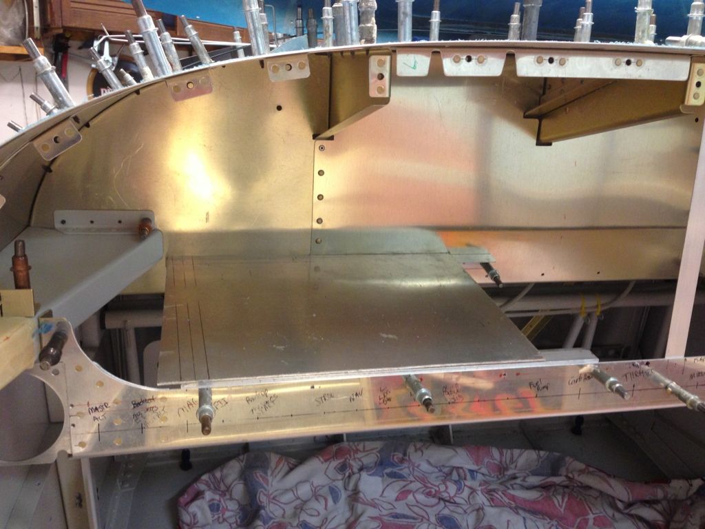

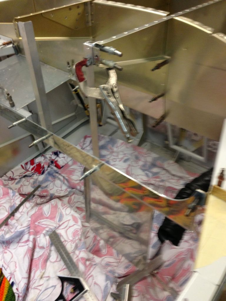

crabandy 02-22-2013 09:00 PM
Subpanel cutout and reinforced. Wish I had the radios and didn't have to guess. (looks tweaked but it's square)
I made a couple of reinforcement angles to stiffen the bottom of the subpanel and GSU 73 floor.

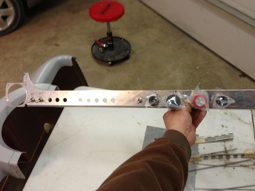

Switches drilled and temporarily installed cables and a couple of switches to check the fit.
tkatc 02-22-2013 09:21 PM
Not exactly sure what your plan is with the floor pan but I have had to work UNDER the panel of my -7A and would suggest cutting a large access hole in the bottom of that pan. That way you can remove the avionics from the front of the panel and then while UNDER the panel you can reach up to access whatever....wires, pitot tube, etc.
Perhaps you already had this plan though...
crabandy 02-22-2013 10:11 PM
Thanks for the advice, I'm actually hoping to not work under the panel. I plan on having the G3X screens wired a little long so I can remove them from the front, pull them out and unhook the connectors. The face of the panel will also be removable on both sides of the radio stack. The radio stack will stay in place as well as the lower panel with all of the switches and push pull cables.
I made the floor plate huge to give me several options on mounting the GSU 73, Once I get the actual Garmin pieces in a couple of months I plan on trimming it to fit the final location. It's only like 5 inches square but with the connectors from the screens sticking back several inches it will be kinda tight!

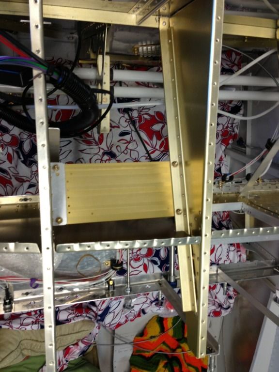

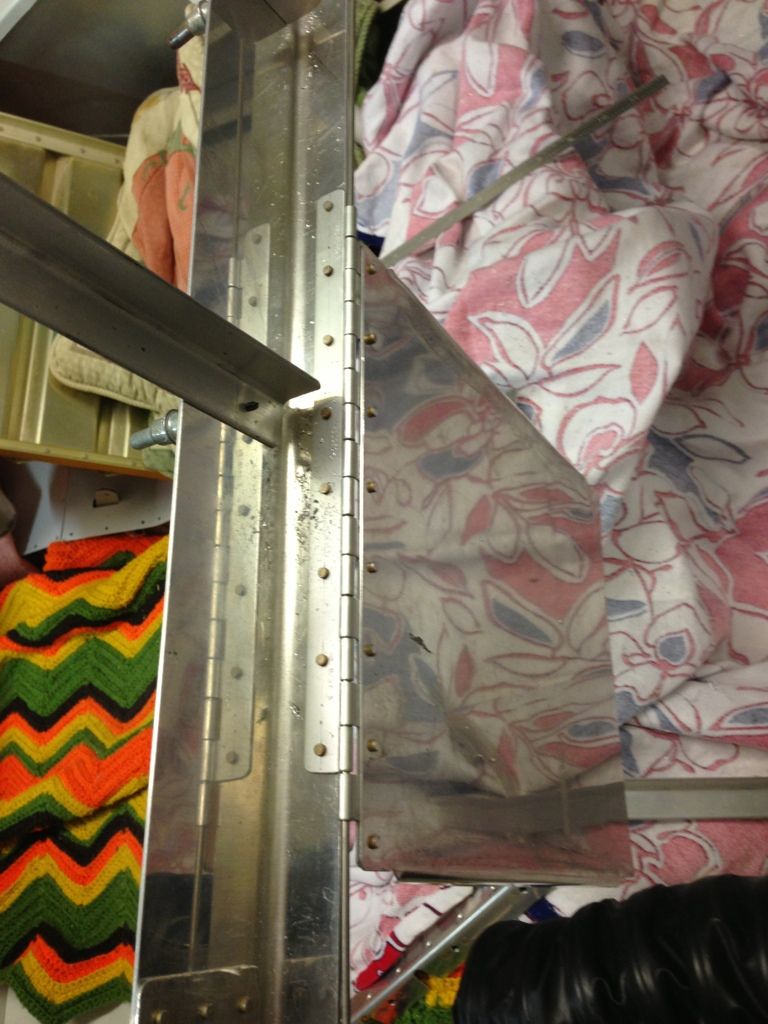

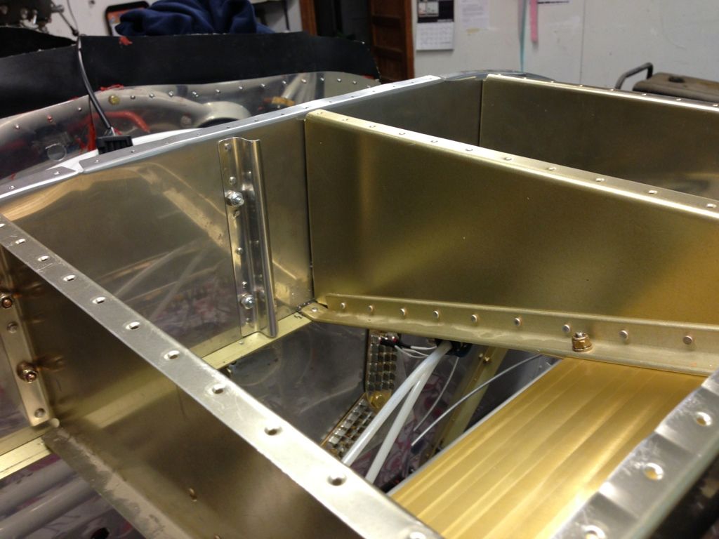

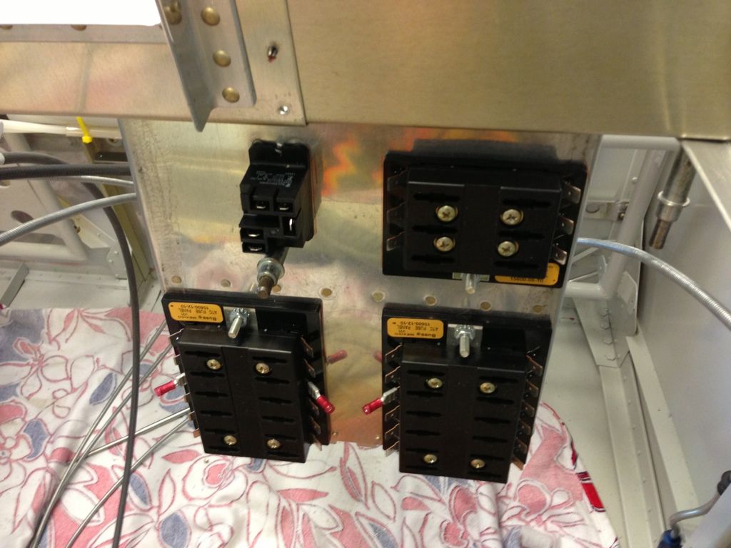

crabandy 02-26-2013 12:01 PM
Finalized my hinged fuse tray, the front latch is just a hinge.
Hinge on the subpanel.

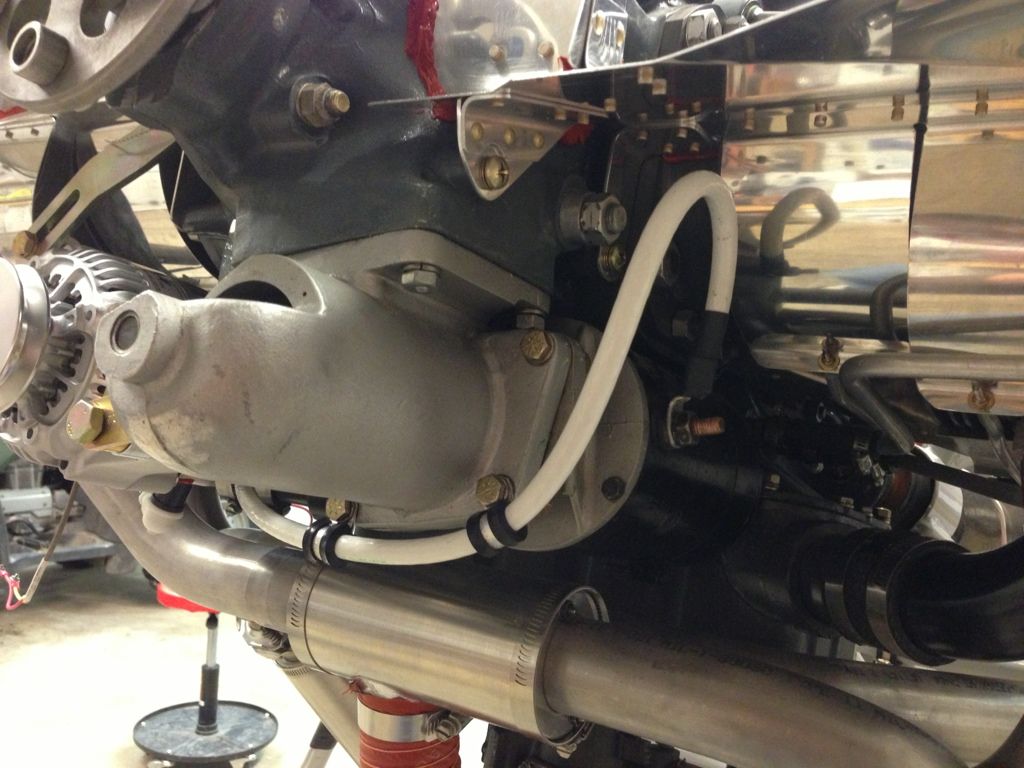

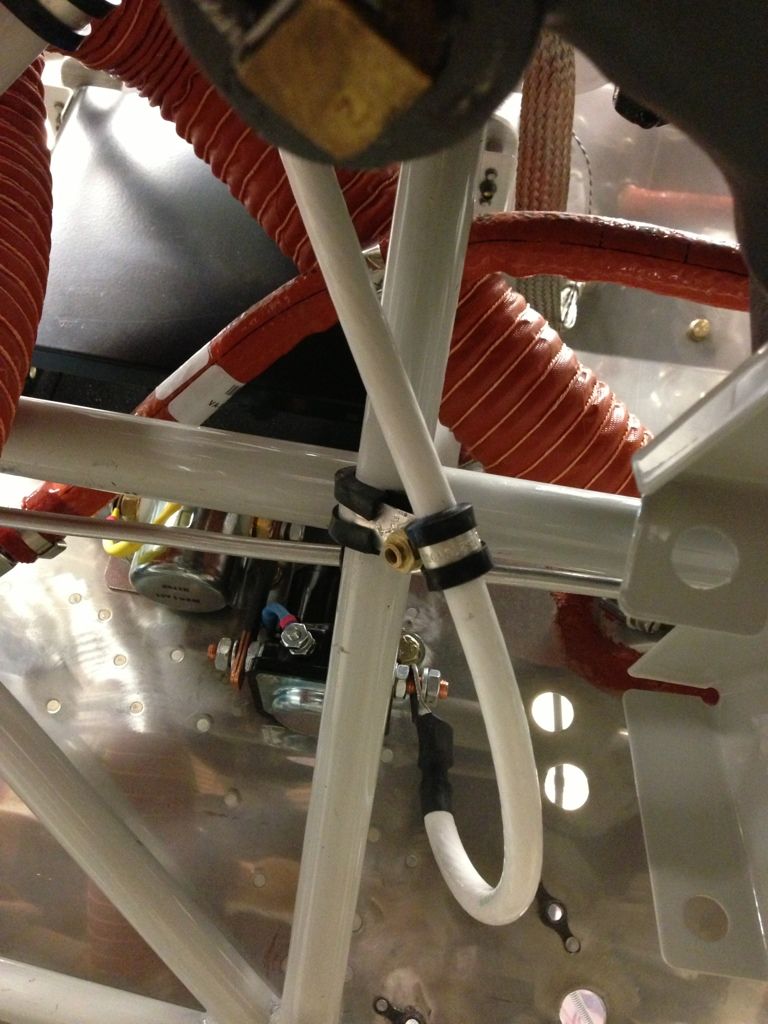

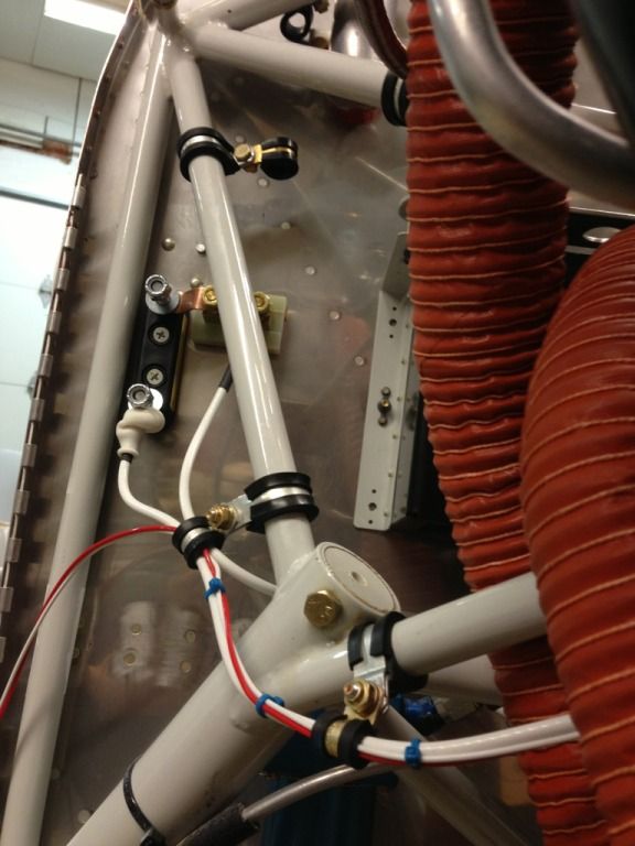

Starter and Alternator wiring
I ran the starter wire with the alt wire on the right side of the engine, I still need to get some more adel clamps to finish them. I tried to leave a service loop at each connection.
crabandy 03-06-2013 09:58 PM
I would rather sand fiberglass than fit adel clamps! I used some slightly Lionger an-4 bolts for the adel clamps on the sump, Americas Aircraft Engines said the hardware is interchangeable on experimentals.

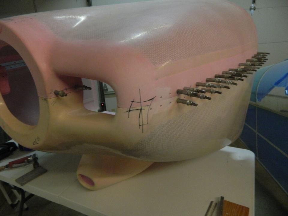

crabandy 03-08-2013 06:30 PM
Older cowling pics
Had to use the "inside" garage to get the epoxy to flow for pinholes.
Initial layout of my hinge covers.
After I reinforced my oil door with a couple of extra layers of fiberglass, my flush latch camlocks were no longer flush. It took me a couple of weeks but I found these laying around to fill the void.

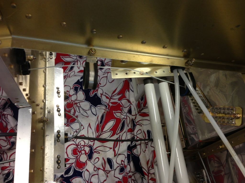

Making more decisions on various wiring runs, the panel will remain hinged for now.
Back side: I'm surprised how small of a service loop it actually takes to rotate the panel with the wires run this way.
Front of the panel: there is less than an inch of motion between the adel on the fuse panel and the adel on the sub panel, we'll see if the panel remains moveable after the wire bundles grow.
I think I'm going to run the grounds through the center of the sub panel and down the bottom side of the forward rib to the forest of tabs on the firewall recess. Disregard the forest of tab orientation and location, it just kinda happened that way.

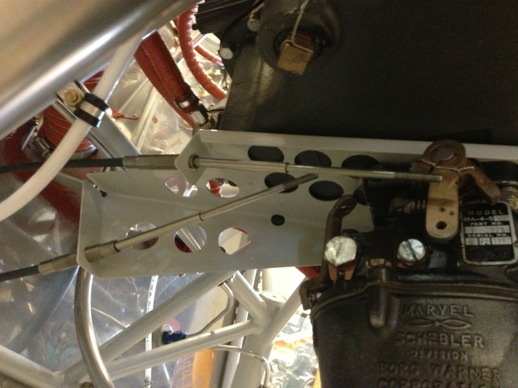

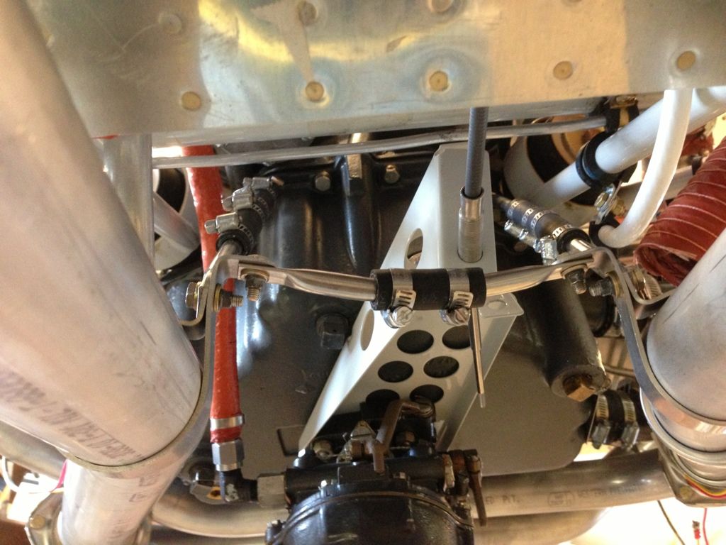

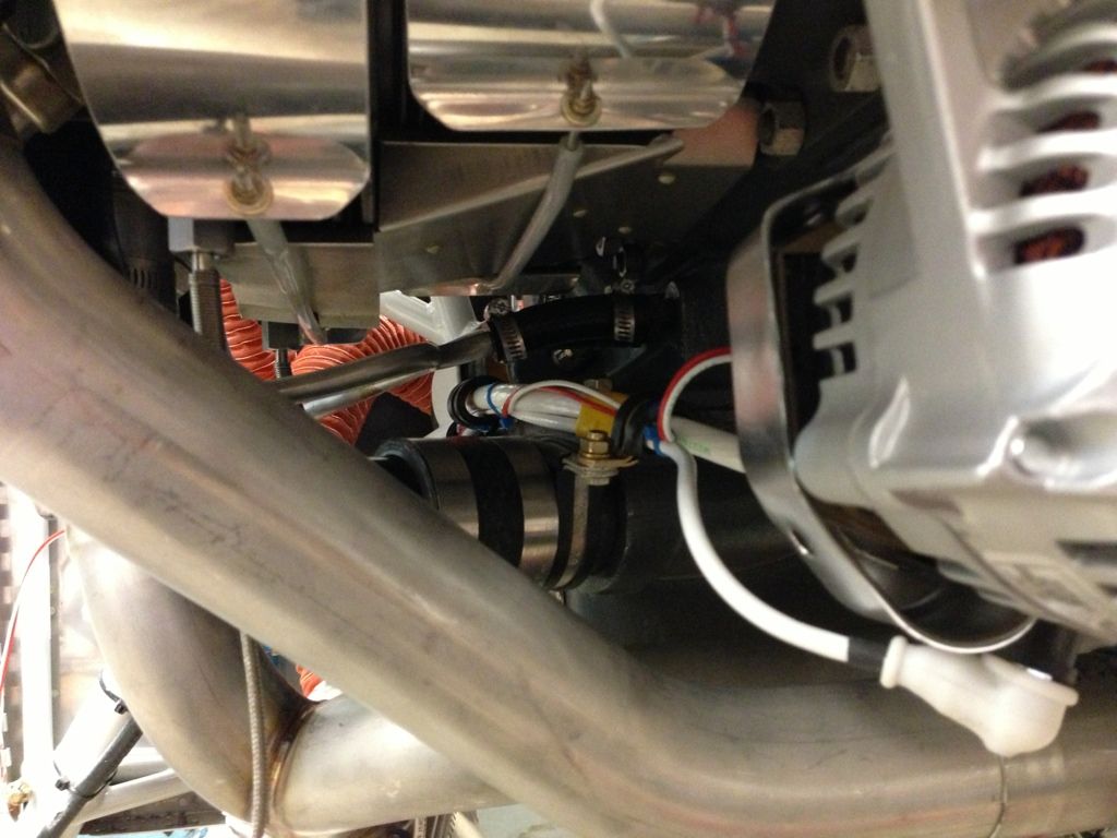

I positioned the exhaust tailpipes, I left the balljoint loose so I could twist them into position. I got the required 25 degrees down from the belly, but the best clearance from the cowl to heat muff is only 1/2-5/8 inch. I will look into some heat sheilds. The tailpipes do slightly angle towards each other.
I finally fit the tailpipe hangers on the right side, but as others has posted the rubber slips on the tube (I cleaned both ss and rubber inside and out with acetone) with 3-5 lbs of downforce. I roughened up the tubes with a file, added a slight flare with my new flaring tool and doubled the hose clamps.
I had to fit the hanger between the throttle cable and starter cable, the left side is just inside my fuel line to the carb. I really want to come up with something better, but it can wait till after I'm flying.

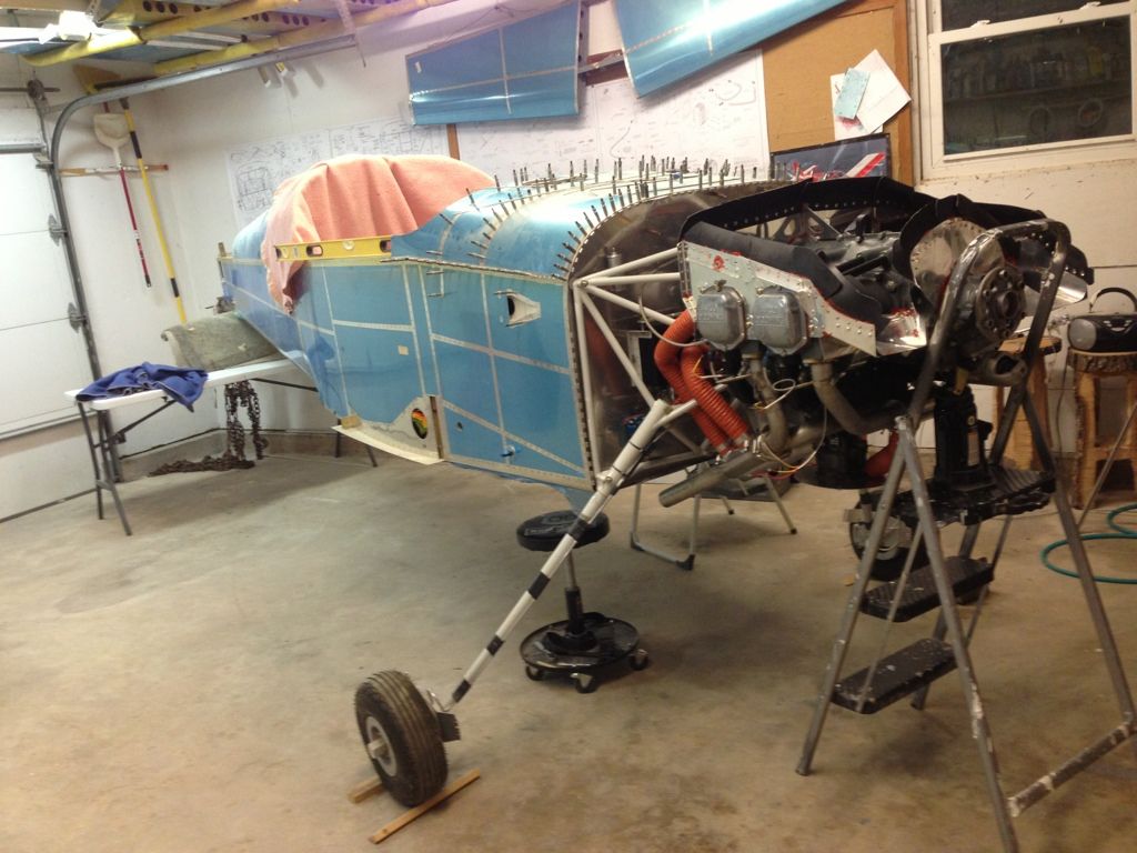

crabandy 03-28-2013 02:27 PM

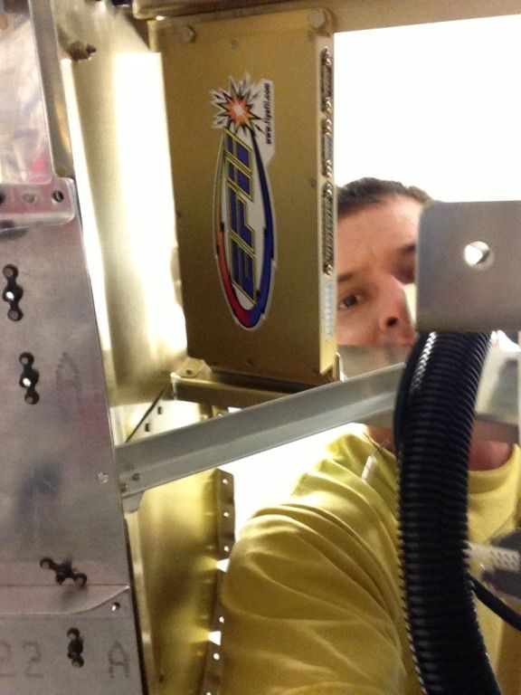

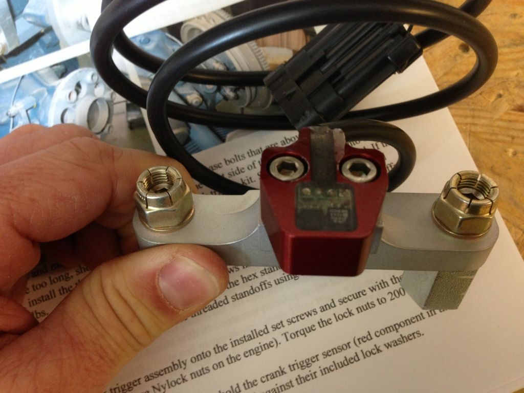

My EFII ignition came today! I mailed my flywheel to Protek about a month and a half ago, they put in the 3 magnets for the flywheel pickup.
Here's a shot of the flywheel pickup.
Installed via the existing case bolts, no drilling or positioning required.
The alternator braket bolt must be installed first.
I mounted the ECU on to the angle brace on the center rib (slider) and added an angle to the left rib.
Downside is the wiring harness and connectors are pretty large.

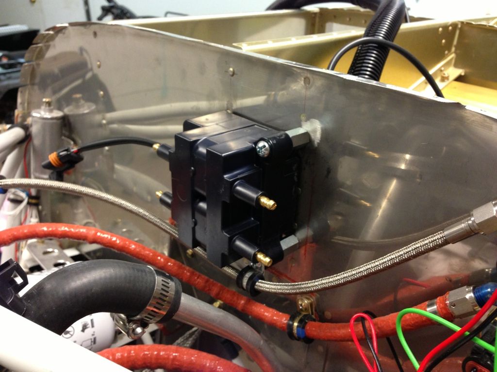

crabandy 03-29-2013 05:52 PM
Pic of the coil mounted on the firewall. It came with a nice mag blockoff plate and coil mount, but I've got the single mag accessory case. I was going to mount it on the lower accessory pad but the firewall was easier.
