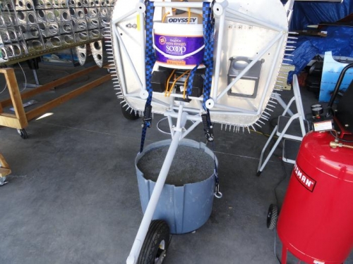

flion 10-27-2012 12:24 PM
A friend of mine who built a Lancair propjet had to make a tie-down so he could jack the wings up and do retract tests. I stole his idea, modified slightly, so I could make a tie-down to keep the nosewheel on the ground until I am ready to mount an engine. I bought a trash can with wheel dolly at Home Aviation Depot, along with a couple of large eyebolts with large washers and nuts. I already had the concrete bags (from back when I was building the RV-6A!). I mixed up 3 bags in the bottom of the trash can (wheel dolly attached; this one has a nice molded one that locks on). Then I drilled for the bolts just above the level of the cement and inserted them with washers and nuts. The washers are to sandwich the hole you drilled; if you can't get eyebolts threaded up to the eye, it's Ok, the washers alone will be suffcient; they just keep concrete from leaking out. I used bolts 180 degrees apart but nothing says you can't add more. Once the bolts are in, I mixed the remaining 3 bags and poured it in. Once the concrete set, I cut off the top of the trash can using a cutoff wheel.
If you were keeping count, I used 6 bags which is only 360 pounds, somewhat less than the weight of an IO540. But it works as a compromise because 1) the gear mounts are aft of CG and 2) more concrete would have made the unit too tall to go under the gear leg. I can always add additional weight (as I have done in the picture) as needed (and I keep a stand under the tail just in case). The unit can also double as a tail tie-down, is on rollers so it can be easily moved or blocked in place if I don't want it to move, and can be lifted and the rollers removed if I REALLY don't want it to move. It was quick to make (even the setup time was only about a day) and not prohibitively expensive - though I admit I didn't pick the cheapest trash can available.
