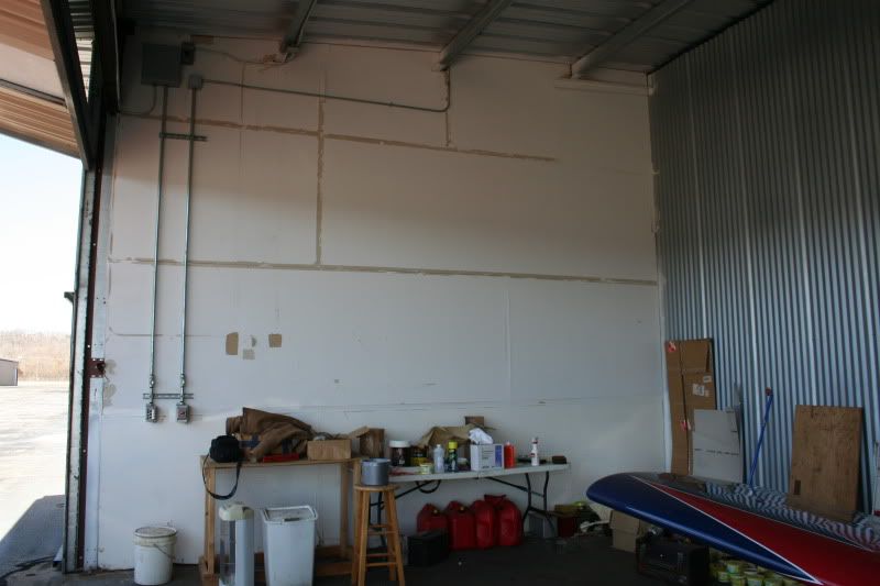

I have hung drywall, taped and used joint cement/compound in a house on a few ocassions but not for a long time. I have a nice large T-hangar and there is a lot of freedom to keep them up to our liking so I'm about to make some changes. The tail of the "T" has three corrugated walls but the wing tip ends of the "T" has drywall. These walls are 17' 9" long and approximately 14' tapering down to 12' tall. I am planning to install a photograph 12' tall and 16' wide directly on that wall ($4.50 per square foot plus tax).

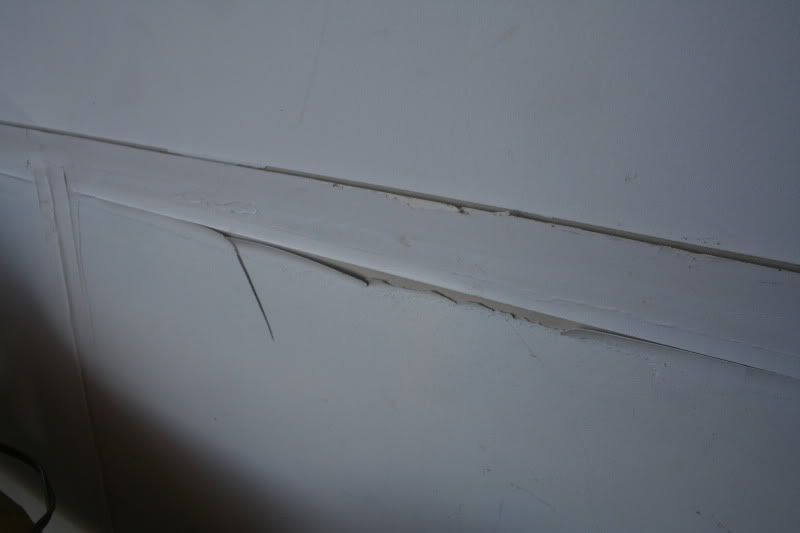

The wall is fairly flat which is a good thing but the joints between the drywall panels are the worst I have ever seen. The tape is peeling off and the paint in that area is flaking badly. At some time in the past someone handled a load with a fork lift and gouged the drywall badly from the floor to about a foot above it. The photo sign store gave me a 6" wide strip of the adhesive backed paper off of a roll (4 ft wide) to see how it adheared to the wall. I wiped down one area with a dry cloth and left another area untouched. I cut the paper into two pieces, peeled the backing off and applied them to the two test areas of the wall (one wiped and one not). The piece on the wiped area was applied over a tape seam. A few days later both pieces were still the same as when they were first applied.
Tonight I loaded up my extension ladder, went to Lowe's (after setting the DVR to record The Gifted Man and Blue Bloods) and bought a 61 pound bucket of premixed joint compound and went to the hangar. I forgot to buy a roll of joint tape but I did do a few things with what I had:
1) I filled the fork lift holes and that went failry well
2) I pulled off the test photo paper strips. They came off with no trouble but so did the white paint that was on the wall - obviously a low grade latex. This means that the paper applied to this wall as is, cannot be removed and reapplied because the adhesive will be covered with paint. A one shot deal unless the surface is changed.
3) I tried applying the joint compound over the existing joint tape but that just didn't work. The joint tape is stiff from the original coating and curled away from the wall at the edges and it was not changed by the application of the new joint compound.
Tomorrow, I will buy a 500 ft roll of joint tape and redo all the joints. The 4'x8' drywall panels are mounted on their side (think landscape) so there are 4 horizontal joints and a lot of 4' vertical joints. Then I need to prepare the surface I'm thinking some good slick paint like epoxy but I will have to check on compatibility.
When that cures I will be ready to install the four 4'x12' or 4'x13' vertical photo strips with a 1" overlap.
That's my current plan - any thoughts? (other than be careful of course)

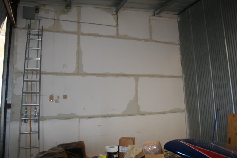

Really good inputs thanks. I pulled all of the tape on one of the walls today and chipped off everything that would come off with a putty knife (mostly where filler had been applied over screws etc. - maybe 20%) then applied this new, to me, net adheasive tape and applied joint compound to joints in the lower part of the wall. I think this is going to satisfy my needs. If everything continues to work out I will post a photo.

The drywall panels are 4'x12' nor 4'x8' as I had originally assumed. One of you guy's mentioned that or I wouldn't have even thought about it. The drywall itself appears to be in pretty good shape. The panels are installed with the long dimension horizontal and staggered. There are four panels stacked to the roof but the roof is slanted for run off so the height is approximately 16' to 14' and the width is 17'9" as I said earlier. I'm a fairly strong and capable 75 year old but I'm sure you understand that there are certain physical limits that have to be recognized in this labor of love - I have to work with the wall that is there. The paper joint tape, much of which had aready fallen off and all of it had delaminated, has been stripped from both the north and south walls. I also have used a metal bladed medium width putty knife to chip all of the paint and filler that would come off of both walls. I washed the joint areas with a sponge to remove the dust from the areas to be taped. The South wall, where I intend to apply the photo, has the ahesive "net like" tape applied over all the joints and I have covered the tape and gouges with premixed white (very light grey?) joint compound. I smoothed it as much as I could during the application but it will require sanding to remove imperfections. I will install the tape and joint compound on the joints of the north wall today. I hadn't heard from the photo/sign shop so I called them this morning. I was told they had to order some new software to get the resolution needed for this photo so they don't have the small scale layout ready for me to approve yet. I think they are taking this job to heart. My plan at this point is to sand the joint compound to blend the surface so there are no ridges or gaps. Then I think I need to remove the dust (I just washed and waxed the Blue Bird, sigh...) and paint both walls with something substantial that will provide a good surface for adhesion and a barrier to moisture. All this time I have to think how I can hang this very large photograph printed on four 4' wide strips of 12' or 13' feet long adhesive backed photo paper and get perfect alignment. I have several ideas using the "think ahead" skills I developed while building our RV-6A but I'm keeping the brain going.

I finished sanding the wall yesterday and did a lot of cleanup of the floors. There are some spots where the net like joint tape pattern is visible but I plan to live with that. The mess created by putting the joint compound on and sanding it off creates a mess that has to be seen to be appreciated. The beautiful dark blue airplane is now powdery white and that is a special cleaning problem. I plan to wash down the walls with a bucket of water and a sponge and then apply the Guardz sealer/binder. Robb in Las Vegas said he sprays it on but that is not possible in my situation. He said you can put it on with a roller and that seemed OK but when I am standing on an extension ladder trying to reach up to 16 ft with nothing to hold the Guardz but a bucket I just don't think that will work either. I think I am stuck with a brush. I possible could do the border with a brush and use a roller on an extension poll - have to think about that.
