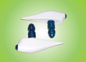

f1rocket 10-17-2011 05:25 AM
You need to add these!
You can find them here: http://www.aircraftextras.com/
Ironflight 10-17-2011 06:30 AM
I looked at (drooled over) some of the cool vents like those Randy, but alas...the tank flange is just too narrow to comfortably drill holes for the AN fittings. And down here where the mud-dauber's live, it's nice to have a tube over which to slip a cover!
Those things are pretty neat though....

DarylT 10-18-2011 09:03 AM
Threaded Fittings
The ones from Aircraft Extra are threaded for an AN3 bolt. I am using a remove before flight flag on a drilled headed bolt. Still doesn't solve the wing flange issue that Paul describes though. But they work great on the side by sides.
