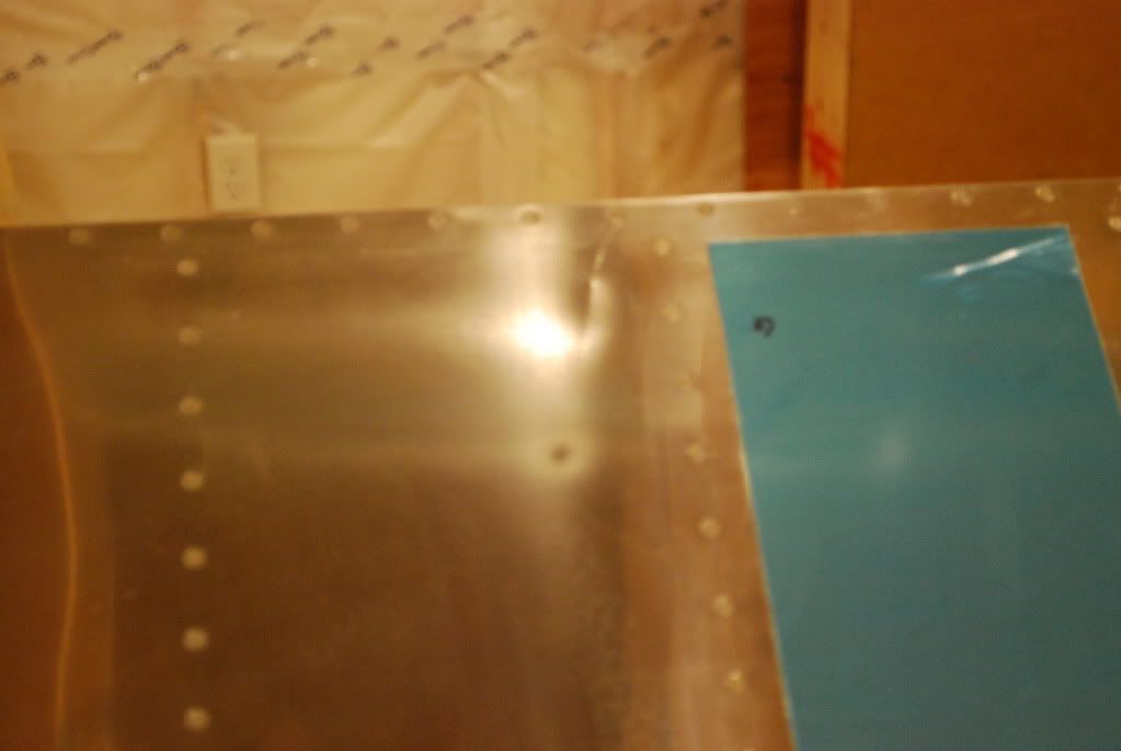

Yep you guessed it. I forgot to lock the door and the little "fill in the blanks" got in and did this to my right elevator (of course the top)...
I tried so hard to have a dent free empennage, I even replaced this skin previously because of a dent. Now those little rascals did this. Is this fillable or do I have to replace the skin?

I would take it as a lesson learned and replace or accept
I would take it as a lesson learned and replace or accept the dented skin - but then I'm a passive soul that can't stand the ongoing tension brought about by confrontation. I would never survive in Texas. There is a bigger picture to consider on many fronts that only you are fully aware of including your work environment. The bottom line is the skin is damaged and I would replace it at this stage or I would leave it as is as structurally safe and accept the appearance. Attempts to fill this thin skin may work but my experience with a epoxy fillet on the rudder trim wedge was bad. The edges delaminated after painting. Some builders fill all the rivet locations and end up with a composite looking finish so experience varies.

f1rocket 10-13-2011 05:24 AM
I can't see the picture from work (site blocked) but I would be careful about additional weight in the empennage based upon the results of the Canadian accident discussed recently.
An experienced builder can put an elevator together in just a couple of days. Buy the parts and re-build it. In the mean time, work on something else to take your mind off of it and the little *&$^&@ who did it.

Brantel 10-13-2011 05:54 AM
Some properly applied filler and that will never be seen again...unless you plan to polish instead of paint.
N8RV 10-13-2011 05:59 AM
I agree with Brain -- fill it and forget it.

Since the dent/scratch is so small, I think you stand a greater chance of damaging the ribs by enlarging the holes when you drill out all of those rivets. Given a choice, I'll take a small, filled dent over enlarged rivet holes, but that's just me.
Depending on how old these miscreants are, it might be personally rewarding for you to invite the little rascals into your shop and teach them how to rivet on some scrap. And show them how to drill out rivets. It might sink in that the damage they did wasn't insignificant and you might end up with a riveting buddy out of the deal someday (if you build as slowly as I did, they'll be teenagers by the time you need someone to crawl back into the tailcone with a bucking bar!)

+1. Should be fine after filling and paint.
