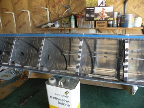

WSBuilder 11-28-2007 11:51 AM
Thinned Sealer?
Rick,
I'll start sealing this weekend and plan to use your suggested 100% cleco process and post-semi-cured rivets. Two questions: is it easier to just do the ribs that way but not the stiffeners, and 2) would it be a good idea to thin the pro-seal a little for wet installing the rivets?
Rick6a 11-28-2007 12:15 PM

longranger 11-29-2007 05:21 PM
Originally Posted by WSBuilder (Post 175052)
... and 2) would it be a good idea to thin the pro-seal a little for wet installing the rivets?
Sam Buchanan thinned sealer with MEK and got good results. I tried it a couple of days ago and couldn't get it to mix thoroughly. I may have added the MEK too long after initial mixing. I'm just going to stick (no pun intended!;)) with straight sealer.

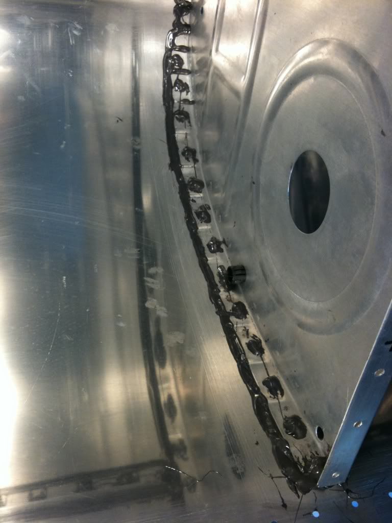

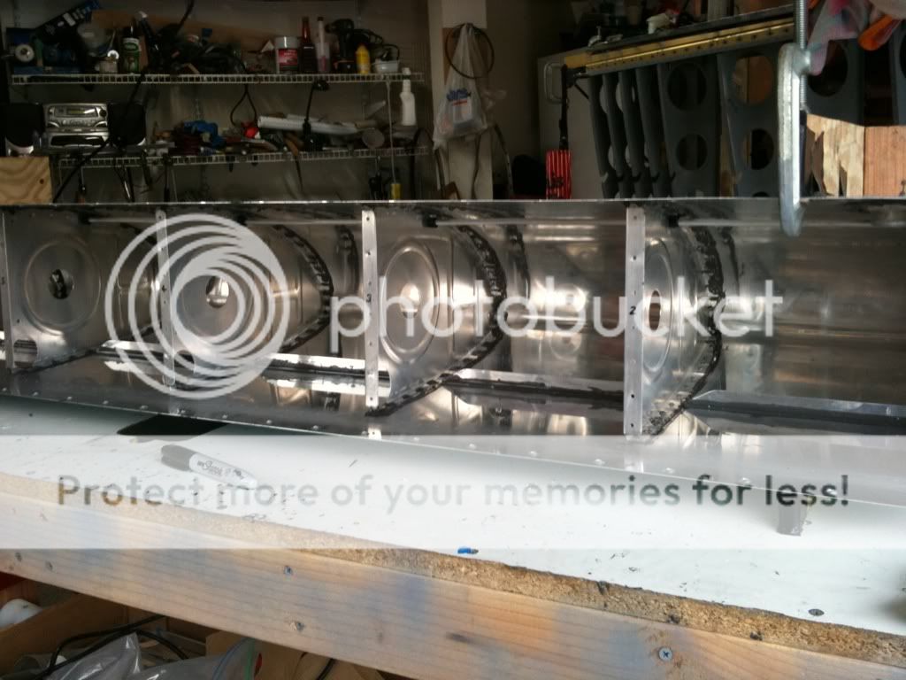

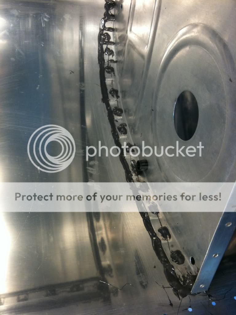

Don Patrick 11-16-2011 09:00 PM
Thanks Rick!
Rick, great information on the sealing of the tanks. Much appreciated. I don't know if this is overkill, but I really don't want to do all this work and have a leaky tank. So, I completely encased the shop heads and the flange with proseal...too much?
Any comments would be appreciated.
Here's a link to my pics:
http://mykitlog.com/display_project.php?project_id=820
Don

Rick6a 11-17-2011 05:22 AM
Good Job
Originally Posted by Don Patrick (Post 596744)
......Any comments would be appreciated.....
Looks okay to me Don. Since you are inviting comments, I will remark on something you wrote:
"Later tonight, I'll go in and proseal and 100% cleco another rib, and then rivet the rib I prosealed...."
My question (if I interpret your comment correctly) is why invest in the extra time and effort to install the internal ribs singly or one at a time? Unless you feel you would have difficulty accessing all the rivet holes, on the next tank why not install all 5 of the internal ribs in one session? Doing so will provide you with the following benefits: By clecoing all 5 of the internal ribs in place in one session, starting with the nose of the ribs and then "wrapping" the fuel tank skin around them as shown in my series of photographs (selectively abbreviated below) you will greatly reduce the chance of generating voids in the faying surfaces as opposed to "sliding" each wet rib into place one at a time. Also, installing all 5 ribs at once will minimize the number of times you have to mix up a batch of proseal.
In any event, it is always gratifying to hear from other builders who have learned that by working smarter rather than harder, the horror stories about "black death" we sometimes hear are completely overblown. You are learning for yourself that working with proseal is not that big a deal if the task is approached efficiently. Good luck to you Don, by the looks of your encapsulation method and supposing your fay seal surfaces are without void, I am virtually certain you are building at least BLISTER free fuel tanks.
One last thing...be extra mindful when you get around to installing that rear baffle. That seems to be the one area of fuel tank assembly many builders report leaks to emanate from, particularly the corners.

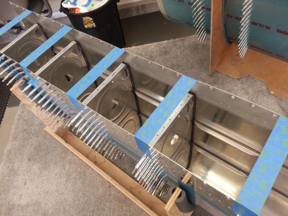

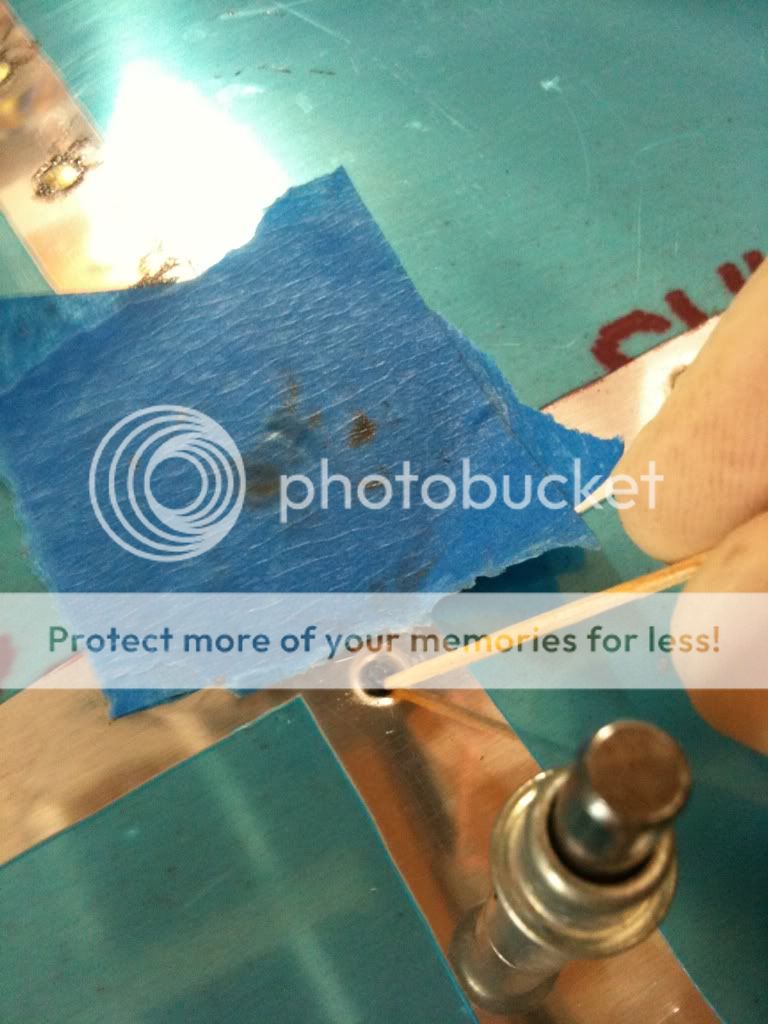

Av8torTom 04-01-2012 02:03 PM
Another Fay Fan
Just finished my right fuel tank using the fay method that Rick described. Much easier and neater than the left tank which I did following the manual. I 100% clecoed everything Friday, then riveted today (Sunday). The weather has been cool so by today the proseal I used on Friday was like soft tar. I used a toothpick to push the little "nit" of proseal out of the hole, then used another toothpick to dab some fresh proseal in the dimple before riveting. MUCH neater and MUCH less stressful way of sealing and riveting the tank. Most importantly, you can visualize the shop head of the rivet MUCH better with this technique.
Filling the dimple with a little dab of fresh proseal
This method allows for a very neat job
P.S. - what looks like streaks of Proseal on the tank skin in the last picture is the reflection of the rib's lower flange
Thanks Rick.

Anyway, here's what I did.
1. Sealed off tank except for vent tube and put a shop vac hose in filler hole. I left the vent tube open to avoid pulling too much suction and damaging tank.
2. Cleaned area of leak with MEK and used vac to suck some MEK into leak and let it evaporate.
3. Mixed up some proseal and thinned to consistency of about Karo syrup or some of that running "natural peanut butter".
4. Put the proseal on and used shop vac to suck it into leak. I let that cure for a few days and leak checked and it was good.
5. To be extra sure put more proseal on outside. I know a few tanks that have been done this way with small leaks on seams and none have failed to date. One has been about 4 years.
I actually have a photo from inside tank that shows where the proseal streamed back along bulkhead.

coldbearsteve 05-16-2012 05:43 PM
Add another Fey Fan
Just finished my first tank( right ), and leak tested. No bubbles. Have had balloon on vent for over 48 hours and balloon is still inflated!
Thanks so much to Rick for sharing this method. I had been reluctant to start the sealing process till I read Rick's post. Can honestly say it was fun.
Steve

SilverEagle2 09-03-2013 10:38 AM
First half
I used Ricks method for the first half (ribs to skins) and I must say...all my fears of ProSeal really were for nothing. This is pretty clean way to get the bulk of the sealant done on the tanks.
I hope to have both tanks riveted during this week sometime. Wish I had done it sooner! Thanks Rick!

SilverEagle2 09-03-2013 12:06 PM
Originally Posted by rmartingt (Post 803980)
How many clecoes did you need to do that? I'd like to lay all the ribs in at once but I don't know if I have enough clecoes to be able to fill every hole on the interior ribs...
340 total will take care of both RV-7 tanks!
I had to borrow some from a buddy to make it work and still leave my top skins and leading edges together.
