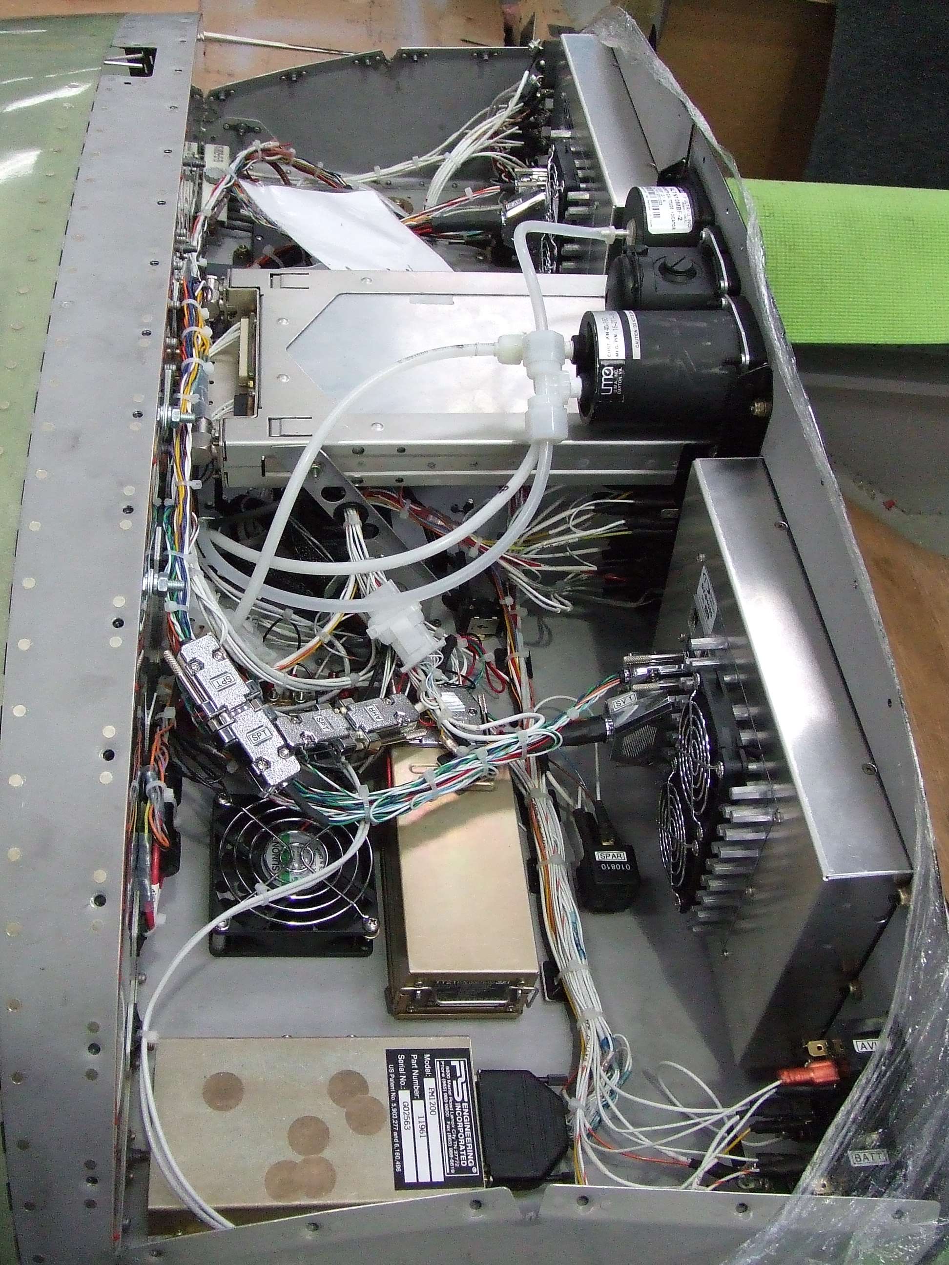

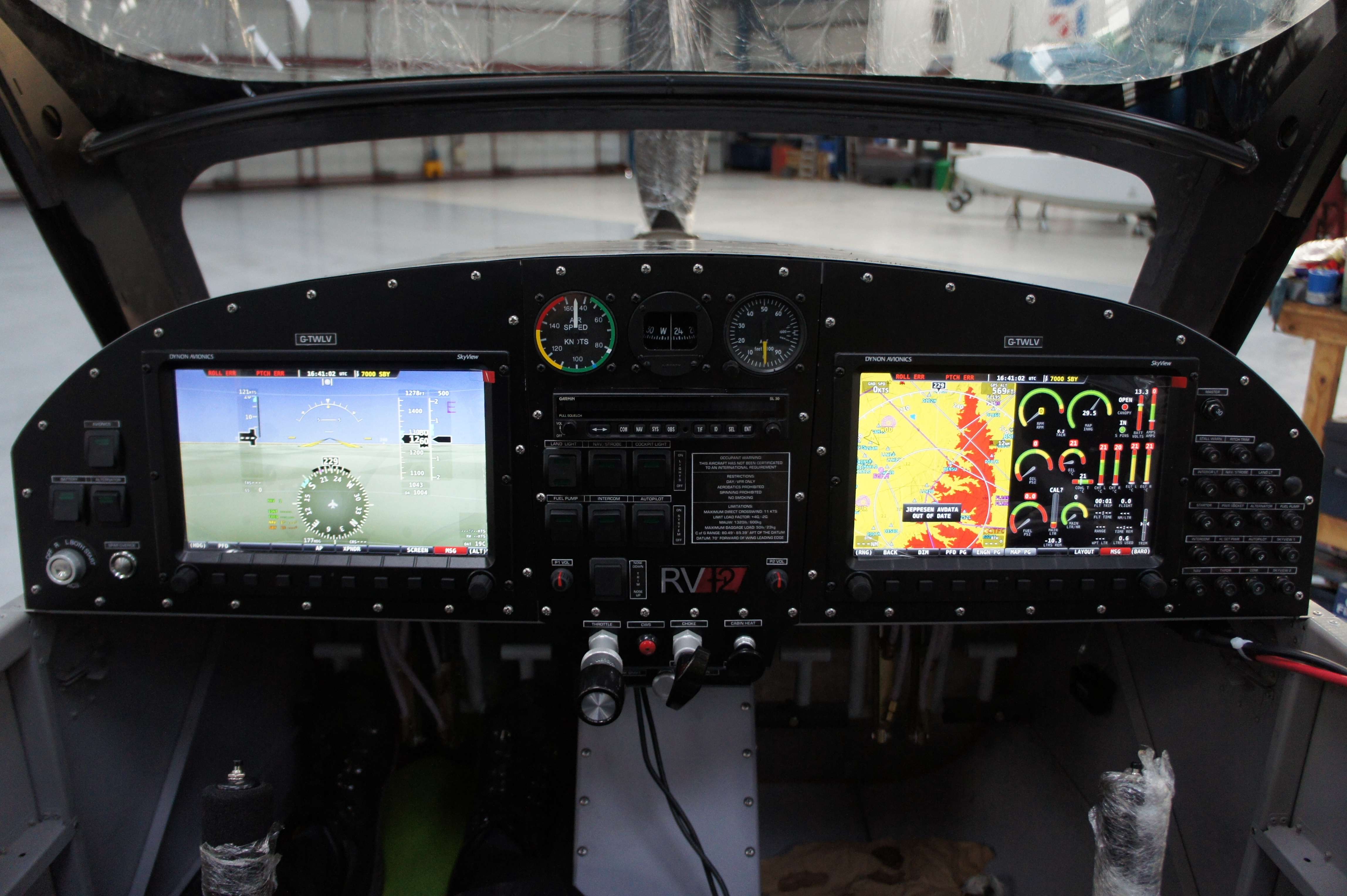

A couple of pictures of our dual SkyView installation (in the process of ground runs, not yet flown).
My 3 analogue instruments are a requirement for the UK: UMA 2-1/4" ASI (40-160 kts) Airpath C2300 Compass FALCON ALTN10MBF-2 altimeter (single sweep 0-10,000ft....!) ASI is plumbed with the pitot on the right and static on the left (gauge in the panel and viewed from the pilot's seat). Static T-piece also feeds the altimeter. ![]() ![]() |
Don't feel bad about the UK requirements, I am putting in the same analog instruments in with my Skyview. I like the way you have mounted them, looks very nice.
