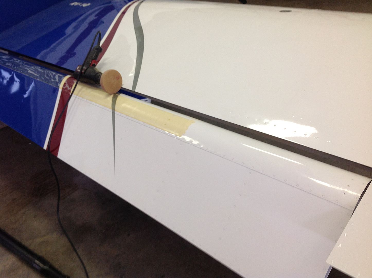

tommylewis 05-08-2012 06:21 PM
Flap tape removal
Today I removed the flap tape from my RV10 because it had yellowed badly. I bought 2 eraser pad wheels and for an RV10, it took both. This is a picture 20 min into the process. I did get both flaps done today and they look much better.
Thanks to those who posted this info.
Master Designs 05-08-2012 07:32 PM
Great pic. Thanks for the motivation to do mine. I already bought the eraser wheel, so now I just need to do it.
Did you use any chemicals along with the eraser (to soften the left-behind adhesive) or did you attack it dry? Also, does the adhesive roll into little balls, stick to the wheel, or fling across the hangar? :D

Kyle Boatright 05-08-2012 08:05 PM
Thanks for the tips.
It just flies off as dust. No chemicals required, but you should peel off the outer layer of the UHMW before you start with the eraser.

tommylewis 05-08-2012 08:41 PM
pirep
My prep is to do an inch or two at both ends of the flap, because as the wheel gets smaller it is harder to do the ends. And strip right to left because the clockwise rotation will peal the tape up better. It took about 3 hours to do an RV10. I did not use any chemicals.
