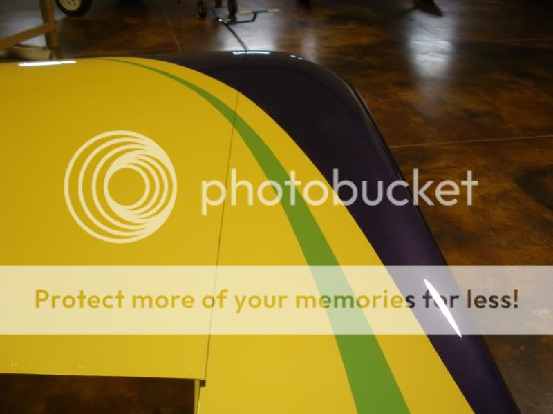

Bill.Peyton 06-26-2011 08:32 PM
Wing tip attachment
Has anyone used piano hinge to attach the wing tips? It sure looks like it would make for a clean looking installation
Bill

Chad Jensen did it on his RV-7, it's all in his build log. Looks sharp.
http://www.chadandbrittne.com/full_construction_log.htm
Richard Connell 06-27-2011 02:52 AM
Yep
And would do it again in a heartbeat.
Very clean and trivial to install/remove tips.
Wasnt too big a deal to install, maybee an additional 3-4 hours.
Only thing id recommend would be to use a wider hinge half on one side or the other so the hinge line is not visible.
Dont have any photos handy, ill take one next time i go flying.
cheers

Not an RV-10, but worked nicely on my -7. I get a lot of comments on the clean lines.
Bill.Peyton 06-27-2011 07:52 AM
Wow, it sure looks nice and clean! I'm convinced, now off the the shop to find some hinge...

Which size hinges do you guys recommend. I read that Mark Phillips used MS20257-3
I assume thats referring to the 1 1/4" as the Spruce MS20257P3-6
Or should it be 1/2" as the .04 metal strips?

Bill.Peyton 06-28-2011 05:48 PM
I purchased 1.5" so they would protrude into the tip. The 1.250 did not quite make it with room on the edge for the rivet holes
Bill.Peyton 07-06-2011 04:36 PM
We just completed the wing tip attachment using the piano hinge material. Not real difficult, just took some time to make the shims and rib needed to match drill the hinge. I did not put an extra rib in the wing tip. I really don't think it's necessary and just adds additional weight.
