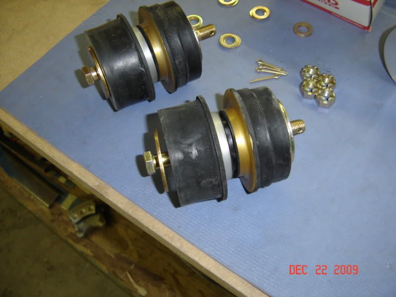

Hi all,
My a&p is working on hanging my new IO-360 and is not 100% sure the orientation of the dynafocal mounts. Unfortunately, he doesn't have the right plans to refer to because mine are at my house vs at the airport 1.5 hour drive away where my airplane is stranded, and I'm stuck at work. Can someone take a picture either of their plans or their mounted engine and send me the photos to forward on? A quick forum search didn't turn up an answer.

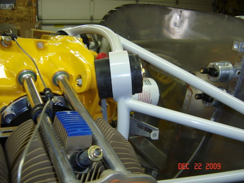

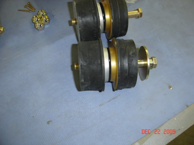

hydroguy2 02-16-2011 07:43 PM
Email sent, but in case anyone else needs to see them.
Lower mounts
Upper mounts
Upper mounts installed

Mel 02-16-2011 07:43 PM
If you are talking about the orientation of the "Lord" mounts; the "hard" mount (the one with the "ring") goes behind the mount on top and between the engine and the mount on the bottom. That puts all the "hard" mounts in compression with the aircraft sitting with one positive G.
