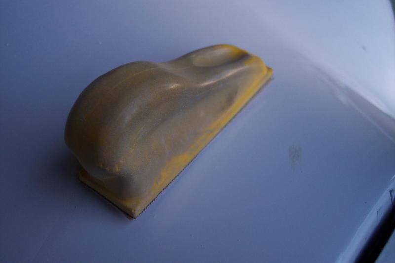

Obviously you can use a machine sander, but in fairness it gets tricky on highly curved surfaces like emp tips and the tail fairing. There you hand sand for sure. Do note the choice of 2000 grit for the last sanding prior to buffing the dark color on the hot rod parts. Dark colors show sanding scratches and swirl marks far more than light colors, so finer grits are better. |

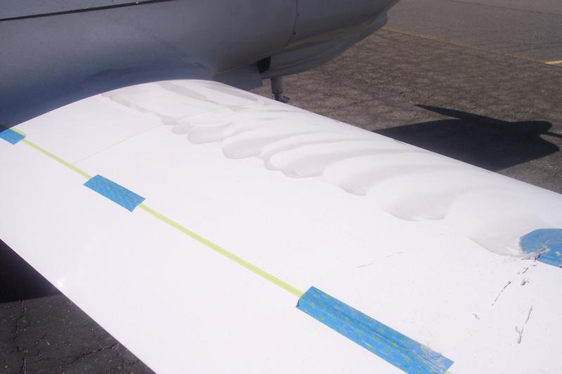

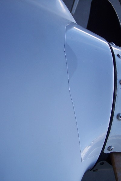

Anyone know the best way to blend something like this? It's single stage Full-Thane.
Tape Line?
Is that a tape line!? IMHO, that is going to be somewhere between very difficult and impossible to blend. Paint spot repairs with blending, by their nature, require a tapering of the new paint thickness down to zero where it transitions to the old paint (the blend). You usually shoot the paint to a feather edge out a good ways from the actual repair area. The photo shows a large "step" (tape line) and very little surface area of new paint in which to create the "taper".
If I was going to attempt it, I would probably tape back close to the tape line again (to protect the old paint from the abuse to come at the line) and then a bit of scraping using a razor blade to knock the step down a bit (starting the taper) and then move to wet sandpaper on a block to move the taper out into the new paint. Remove the tape at some point and gradually use finer paper (always on a block), extending the blend into the old paint and then eventually move to buffer etc. Very tedious at best and I wouldn't want to bet on a good outcome (invisible blend). Just my 2 cents based on my painting experiences. |

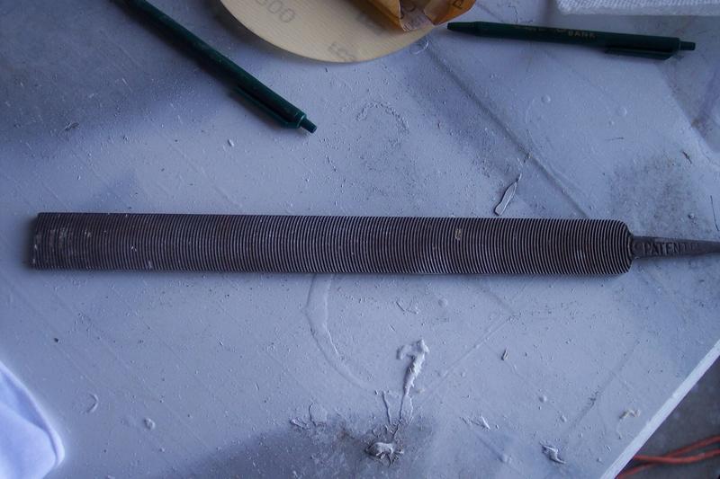

No not a run razor, looks like this https://www.eastwood.com/painters-ni...yABEgL5UfD_BwE, called a painters nib file and is used to cut down painr runs. Tedious but works.

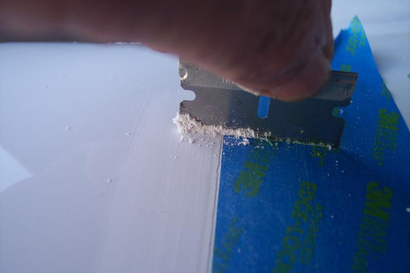

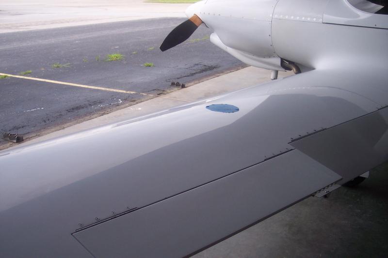

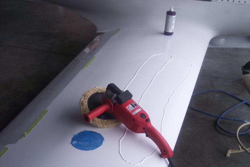

So today I used the razor blade trick to taper down the new paint. It worked pretty well but I have two recommendations. First, putting the razor blade in a vice and using a steel rod to curl over the edge seemed to work better than the 600 grit. I tried it both ways. Second, be sure to put a small piece of tape on the side facing you because it's almost impossible to tell which edge has the curl.
![]() After using the razor blade, I went to my tiny little Ace Hardware sanding block with 120 grit on the raised edge. ![]() After that I went to 320 grit on a 3M hard rubber pad, then 600 grit. It came out nice and smooth, but I can see different color bands. Whether I sanded through the top coat and exposed the white sealer, or whether the paint match wasn't quite perfect, I don't know, but it's good enough for now. Eventually, I'll have to reprint the entire canopy top (if I care). |

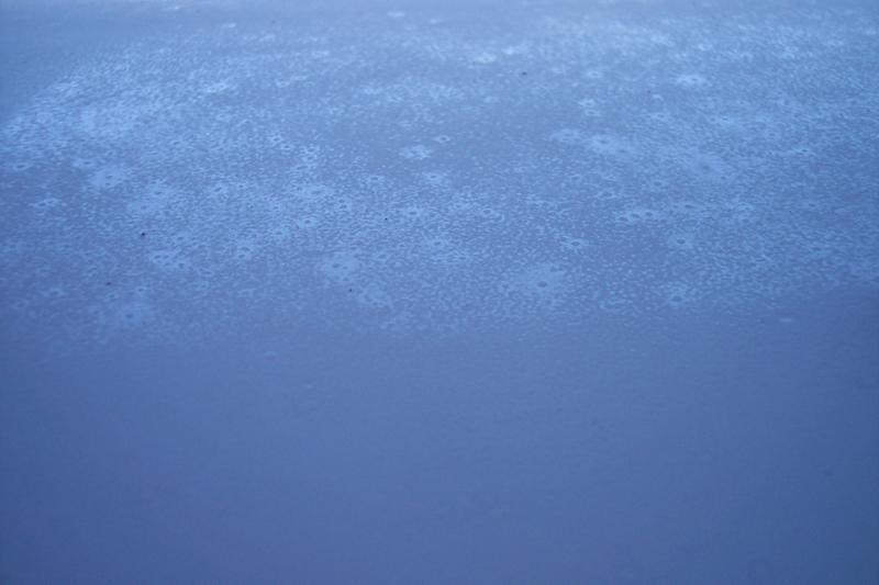

DanH has put together a great thread here showing us all how it should be done. I'm just an amateur who hates painting, but maybe it would be useful for everybody if I posted a few examples of how it should NOT be done. First of all, your cutting and buffing will go a LOT better if you do a good job of applying the paint in the first place. In my case, I used a cheap Harbor Freight Binks-knockoff siphon gun, and really didn't have a good spray booth. Two strikes against me. There are a lot of tricks to adding the proper amount of reducer to the paint so that it will flow evenly without runs or sags with minimal orange peel. I guess I didn't know any of those tricks because I got all of the above. You won't get runs and sags if your workpiece is horizontal, but that is hard to do on a fuselage or if your aileron is hanging vertically from some wires so you can do both sides at once.
You will really want to minimize dust or other debris while spraying, so you should cover the floor of your spray booth with butcher paper or wet it down with a garden hose. You don't want to spray when it's windy. I didn't do any of those things with this last attempt, and here are the results: ![]() The good news is that all those "dust nibs" (I think they're called) sanded out, but it took some time and effort. I should mention that I'm using single-state Urethane paint (Nason Ful-Thane) which seems to work pretty well for a klutz like me. I started with 800 grit to remove 80% of the defects, then switched to 1200 grit for the last 15%. Yes, this is not a show plane so I'm willing to accept an occasional defect here and there. After that, I went to 2000 grit wet-or-dry and that made the surface almost shiny, but I can still see some faint scratches. I bought some 3000 Trizact discs which I will be using tomorrow. After that, I intend to use 3M "Perfect-It" compound #1, then #2 if necessary. One thing I've discovered is that a foam 3M hand pad cuts almost as fast as the DA sander, and doesn't leave swirl marks. This has been an adventure. ![]() |
