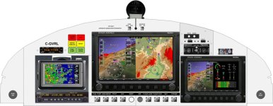

F1 Rocket full panel upgrade
https://drive.google.com/drive/folde...OC?usp=sharing
The panel was overdue. Clean work and outstanding service from the avionics shop. Sold the TruTrak AP to have everything match with Garmin. I did not want any CB or switches on the panel. Wanted it clean and efficient. All switches moved to the right console and all CB moved to the lower console.
Infinity grip is nearly HOTAS with fuel pump, starter, trim, flaps, comms and AP cw switch. Only thing I wish I could get is a dual comm switch on the throttle.

Very nice. Pretty much the same equipment I installed in mine last year :-)

Thanks. Replaced the TruTrak for Garmin and also changed the VM1000 engine monitoring for the Garmin EIS. The GMA 245 and GTR20 are both remote.
Are you using the GNX 375? In Canada we ned dual independent navigation source which is why I needed the GNC255 and GNX375
