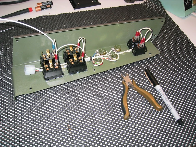

Bill Wightman 01-07-2010 10:26 AM
I used the panel on the right side for lighting controls. Big rockers are external lights; knobs are dimmer controls for internal lights; small black rockers are for interior utility lights.
The panel unplugs using a simple 9-pin molex connection:
As you can see, the CB's are all mounted across the bottom of the panel. Like Danny, I put the flaps on the Infinity stick. Buttons on the stick are also used for the starter, radio interrupt (to cut out incoming audio), and radio transmit.
Most other switches are on the right side instrument panel.
