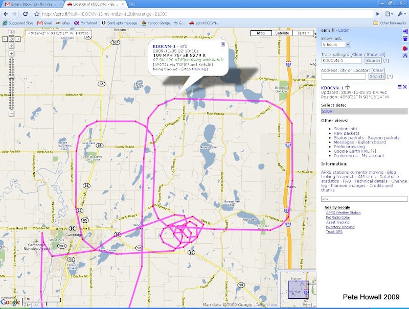

I just signed off the 3rd annual condition inspection on the -9A, and I thought I would re-run some cruise performance #'s to see if she has lost anything. Plus, a meeting was cancelled, and the weather was perfect!
I preflighted, took off, ran on up to 8500ft, and set up for cruise. I locked on the Trutrak and took some 4 way data on the cardinal headings. 22.2" MP, 2270 RPM, LOP 6.0-6.1 GPH, carb heat about 1/4 on. Here is the data: NTPS spreadsheet shows 151.6 KTAS with a small std dev. I was happy to find this is just a touch better than my Phase 1 test data. Over 28 smpg at 170+ mph, I guess I'll have to keep her...... Here is the APRS track, the big squares are the test runs: ![]() |

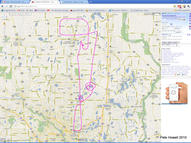

Looks pretty much the same after 750 hours. Can't complain.... Otto the pilot was flying, and the numbers were pretty steady. Cold -8C , but nice and smooth up at 8000. I think the temps gave me a knot or so....
22.2" MP, 2270 RPM, LOP 6.0-6.1 GPH, carb heat about 1/4 on. Here was the track today: ![]() |
