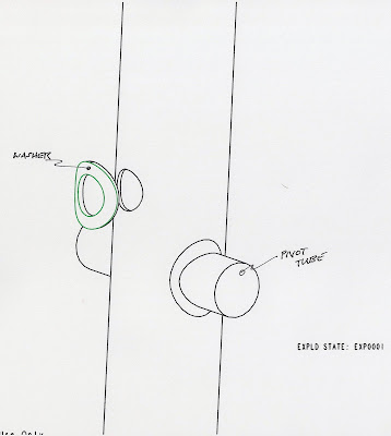

FIX: Putting a hole in your control stick for wiring
Problem: How to run the wiring out of your control stick(s) when Vans says its bad to put a hole in the wall of the tube, especially near the pivot point.
Here's the warning from Vans: Any hole anywhere in the control stick will reduce its strength. The nearer this hole is to the pivot point of the stick (where the bending forces are higher), the greater will be the severity of the strength loss. Van's recommends that builders do not drill holes anywhere in the control stick, particularly near the pivot point. Generally, the accepted routing for electrical signal wires is through the opening on the bottom of the control stick. So now we have a problem that nearly 100% of RV builders must face: how to run the wires out the stick, and most of us don't want to run them out the bottom of the stick for reasons explained elsewhere. Also, there's no "opening" at the bottom of the RV8 stick mentioned in the warning from Vans. This problem was also discussed at length in another thread when a builder asked how to route wires out of the control stick. Since nearly all of us have wiring in the control sticks these days, a solution is needed. Solution: The solution is to use a reinforcement "washer" around the hole. The purpose of the washer is to reduce and disperse stresses around the hole in the stick. This work-around assumes 3/8" diameter hole is necessary to route control stick wiring into the stick. The location analyzed for this work-around is 3/4" up from the longitudinal pivot axis of the stick (the pivot bolt). The hole may be placed on the front, back or side of the stick. The "washer" used to distribute stress is 4130 steel, .050" thick, and has an outer diameter of 5/8". As mentioned, the inner hole is 3/8" diameter. The washer should be rolled into a radius so that it fits the stick tube's 1-inch outside diameter. To carry the stress loads, the washer should be welded around its outer and inner edges. Edit: Its not recommended to braze 4130 (see post below) Exploded view of RV8 front stick tube with washer ![]() The resulting tube with washer will have very close to the same bending strength as the tube with no hole in it. Smooth the inner edges of the hole after the washer is fastened. There may (probably are) better ways to do this, but this is one solution that will work. |

I'm not an engineer and I can't see how drilling a hole in the control stick will weaken it to the point of failure. After all, we're not using the stick as a jack handle or cheater bar on a pipe wrench. Your only putting enough force on the stick to deflect the control surfaces. I'm sure we're not applying many lbs of touque. I drilled a hole in my RV-7 stick and installed a very small rubber groumet I bought at ACE. Then I installed the wiring. Charlie |
4130
So where does one get a 4130 washer from? Make it? Local stores carry them?
I'm not an engineer either, but I agree with Bill that a hole MAY create a dangerous situation. Yes, it is unlikely that anyone will put the requisite force on a stick to bend it during normal flight, given the hole size that Bill tested. Are all wiring holes the same size? I also note that the pressure tested was only 6" above the pivot - its easy to be higher than that on the stick and not really notice the pressure. Final bit of info: I just tested my 9 to see flyability with the trim tab full up and full down and it was shocking to me how much pressure was required on the stick to stay level. Again, not likely in normal flight but...
my two pennies worth. Bill, I would be interested to see the model for a hole in the SIDE of the stick. greg |
Very interesting, thanks for the work. I've got a small hole in my stick exactly like you describe. Since I'm down for annual, I might just pull the stick and do the washer mod like you describe. Did your FEM take into account the heat affected zone of the weld of the washer? As for brazing 4130, this is a no-no. I know that bicycle frame builders do it, but this is not a bicycle we are talking about. Below is a quote from Richard Finch, welding guru and author of several welding textbooks: "Always avoid brazing 4130 steel. The reason is because the chrome-moly steel has a definite grain structure that actually opens up at medium-red brazing temperatures. When brazing alloy is melted onto the steel surface, it flows easily into the many small cracks and crevices in the chrome-moly steel. Then, as the braze joint cools, the brass will not compress, and it causes major cracks to form in the 4130 steel. Often, a brazed 4130 steel part will crack completely before your eyes as it cools." - Richard Finch, "How to Weld **** Near Anything" pgs. 115-116 |

Charlie - Everybody here ultimately makes their own decision on how they put these planes together, within the scope and context of AC43.13. I'm only offering an engineered work-around to a problem many of us must solve somehow. This remedy isn't intended to be taken as marching orders for anybody. Keep in mind the warning was issued by Vans, not me. ************************* Where to find the washer? You could use an AN960-616 aircraft grade washer. Its close enough in material properties to work for this purpose. Specs are .390" ID .625" OD and .063 thick in standard thickness. You could work the thickness down to .050 and put the roll bend on it easily. Aircraft Spruce has them. |

You could easily put a hold in the stick and do it in such a way as to not reduce the strenght at all.
Take the hole you have drilled in the 4130 control stick, take another piece of 4130 steel tubing the same diameter as the stick and fishmouth cut the small piece of tube. Use AC43-13 1B to see how it is done and for pictures. Now weld the piece over the hole that you have drilled to where the smaller piece is 90 degrees to the control stick with the fishmouth cut fitting over the hole you have cut in the control stick. Now file and sand down the 4130 tube piece to create a 1/8 lip or the desired height you want of the lip. This is somewhat along the lines of the washer idea except its the FAA way. And we all know that the FAA way is the ONLY way.. :D This is the same type of welding tech used to build airplanes so I think it would be ok. Just my two cents. If you really want to know if it will hold up, I'm sure someone would test it and see. |

Another concept to strengthen tube. Buy some larger diameter 4130 tube from spruce, cut a 2" long piece, slide it down your control stick and drill a hole where you want the wires (telescoping tube). For example, if I wanted to strengthen my 1" OD RV-8 front stick around the hole I drilled, I could but some of the following: 1 1/8 OD .058 Wall Part No: 03-07100 $3.70/ft It has a 1.009 inch inside diameter. Slide a 2" piece down your tube, drill the hole and call it a day. You could weld it on, bond it on, or even have a couple of screws. Take a closer look at the RV-8 rear stick and you'll see what I mean. Cheers Robert Grigson |

A few of you have asked about putting the hole in a better place in the stick. The analysis I did had the hole in just about the worst possible location, and it was 1/2" diameter to boot.
I have a couple comments about alternate locations: First, consider putting the hole in the side of the stick rather than the front or back. This is simply because the roll forces on the stick are less than the pitch forces. I'd guess off-hand that the roll forces are maybe 2/3 or even 1/2 the pitch forces. That would result in a corresponding decrease in stress around the hole. Second, placing the hole further UP the stick is better than closer to the pivot. The controlling distance is what's measured from the hole to the application of load, ie the stick grip. Locating the hole higher up on the stick does give us some other problems to deal with and those have already been discussed. Finally, there's no substitute for an actual test of this part. The FEM analysis is pretty and it has merit for showing how stress is distributed. BUT its hard sometimes to draw the correct conclustions from this type of analysis. I'll try and get a few tests in for y'all. |

I think I have a better idea now after re-reading the post. What you are talking about is making a T-joint right over the hole in the stick (similar to putting holes within a cluster joint for line oil to penetrate) then cutting off the vertical leg of the T after welding, so that only 1/8 inch or so remains. This seems like a good alternative to welding on a washer. My next question is- does the vertical have to be the same diameter of the stick? If the hole is 1/4, why not use 5/8 or so tubing for this? |

I added a hole to my control sticks for the Infinity Grip under the pivot and on the side. Under the pivot for reduced stresses on elevator loads. On the side to reduce moment caused by lighter aileron loads. TIG welded doubler made from trimmed portion of stick.
https://drive.google.com/file/d/1v79...ew?usp=sharing https://drive.google.com/file/d/1TVZ...ew?usp=sharing Installed cable at hole interface with silicon tape wrapped and cable tied to stick to reduce any movement at cable exit through hole. Cable routes to bottom with a loop on inner skin, wrapped in snake skin to prevent wear or chafing. https://drive.google.com/file/d/13zQ...ew?usp=sharing https://drive.google.com/file/d/1Gph...ew?usp=sharing |
