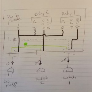

I decided to buy this GSM switch from Amazon to allow me to remotely turn on my engine heater. The directions are pretty weak and I'm not real strong with electrical things. I was wondering if one of you guys could back me up on the wiring of this switch?
I bought the AC version vice the D.C. Version, so it take 115V AC power in. I plan to use the male end of an old orange 16 ga extension cord for power in.
1. Do I just attach the white and black wires to spots 1 & 2?
2. What do I do with the green wire (ground)?
For the output, I'm using the female end off of relay #1. The same questions apply here. White and black off of 6 & 8? What do I do with green?
Here's a link to the manual for the 12VDC version. There is no manual for the AC version: http://tinyurl.com/z3tds57
Manufacturer's website: http://tinyurl.com/js6jag5
Chuck

Bo1000 12-14-2016 08:12 AM
I'd hire an electrician
From the sketch, it looks like pins 1 & 2 provide power only to the components on the circuit board, not to the relay contacts.
Each relay switches common (C) to one of the other 2 associated contacts (NO or NC) depending on the command you send. If you connect your AC wires to pins 6 & 8 and send the command to connect them, the relay will connect the black wire to the white wire. Briefly. I would hire an electrician for peace of mind.
(Also, T-Mobile and its re-sellers will be your only choice for a SIM card. AT&T is turning off all its GSM service at the end of the month.)
Bo

jwyatt 12-14-2016 08:37 AM
I have an older AC version of the same unit that I wired up. The following assumes that your model is the same wiring (the manual link seems to indicate it is). There is no internal connection between the 1 & 2 terminals and either of the relays, the 1 & 2 terminals are simply to power the board's electronics. The relays are separate from the internal electronics.
Needless to say, if you're uncomfortable working with household power, don't try this at home.
Your incoming and outgoing power cords should all have three wires:
Green: ground
White: neutral
Black: hot
Connect all of the greens together; they don't need a connection to any of the terminals.
Put a white pigtail on terminal 1, connect this and all the IN/OUT whites together.
Put black pigtails on 2, 3, and 6, and connect all three to the INCOMING black.
Connect one OUTGOING black to 8; this is your first switched circuit.
Connect one OUTGOING black to 4; this is your second switched circuit.
No connections to 5 or 7.
Here's a sketch of my connections (click for bigger):
ChuckGant 12-14-2016 09:04 AM
Thanks for the help guys. Here is another diagram from the 12VDC manual:
I will have an electrician look at it, but I also want to learn as I go.
I finally found this project. I guess that I didn't realize that terminals 1&2 are just to power the device, not provide power to the heater.
JWyatt,
I sincerely appreciate your diagram. That helps a lot. One question... Yours shows that we use 3&4 and 6&8, but the diagram above indicates that I should use 3&5 and 6&7. Thoughts?
