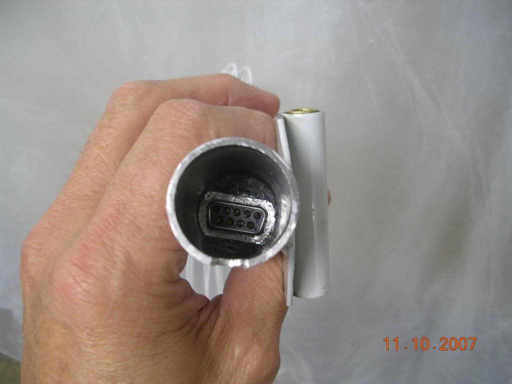

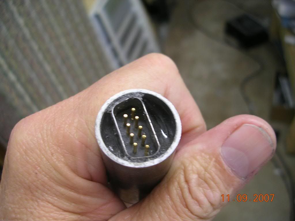

Here's my solution to the problem of having a "wired" stick that is REMOVABLE.
I thought about this WAY too long, but I'm excited about the results.
I just didn't see how there was going to be enough room for external wiring and connector.
I used DB9 connectors that are trimmed down to fit inside the tubes and used epoxy (West Systems) to "pot" them in.
You have to solder the two halves of each DB9 connector together, because when you trim them down you cut off the part that holds it together! The soldering is the easy part.
I had to install an allen screw (6-32) and make a slot in the reciever so the DB9's would line up when slid together.
I saw where "kevinh" had done this with a round headphone plug. But I needed 9 wires as I have a CH grip on both sides.
The photo's below show what I've done. I haven't cleaned them up yet. They will look better when I'm finished.
The powder coat line makes it look like it's not all the way in but it is!

Nicely done, Mark. Great idea. I knew that one of these days I'd have to tackle the "removable R stick with PTT" issue.

EXCELLENT solution Mark!!! I'm gonna do it, thanks very much!
Your first post here has a pic that's not linking... maybe its the pic of the receiving plug. I'd like to see that.
