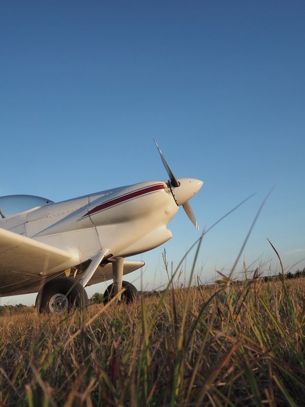

gmrv4 10-26-2015 12:26 PM
Certainly some compromises that most folks might not want to make or everyone's cup of tea but works well for places I like to go. 21X8-6 4 ply
