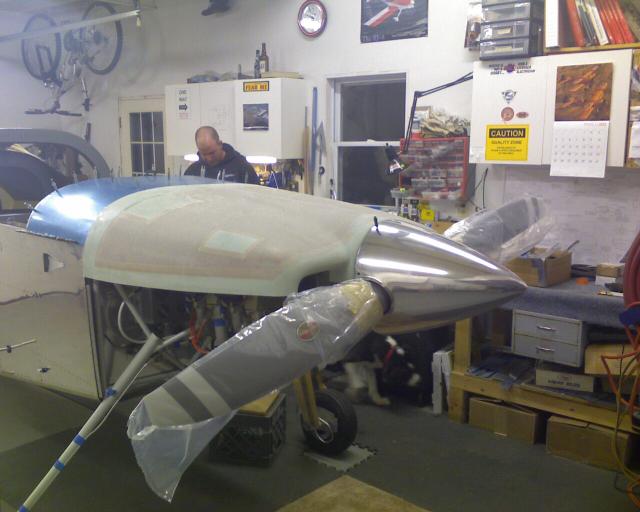

Captain_John 04-12-2012 09:34 PM
Yah sooo... this is lookin' pretty good. Had ta share...
What cha think?
:) CJ
Flying Scotsman 04-24-2012 12:08 AM
THAT looks sweeeeet! I wonder if it would work as a drop-in replacement (now that I've already fit my cowling)? :(
pierre smith 04-24-2012 05:26 AM
Nope.
Those big gaps around the prop shank will cost you speed...as well as the lip around the opening creating turbulence. The tighter the spinner is fitted to the prop, the faster you'll go....thanks to the late Paul Lipps for that info.
Best,
Captain_John 04-24-2012 08:15 AM
Steve, Pierre is right. It needs to be fitted with the cowling.
Pierre, I like the way this looks so much, I am willing to take a .325 knot hit.
:) CJ
pierre smith 04-24-2012 09:12 AM
Originally Posted by Captain_John (Post 652983)
....Pierre, I like the way this looks so much, I am willing to take a .325 knot hit.
:) CJ
Rv's are fast even in slow flight:)
Pretty spinner tho',
