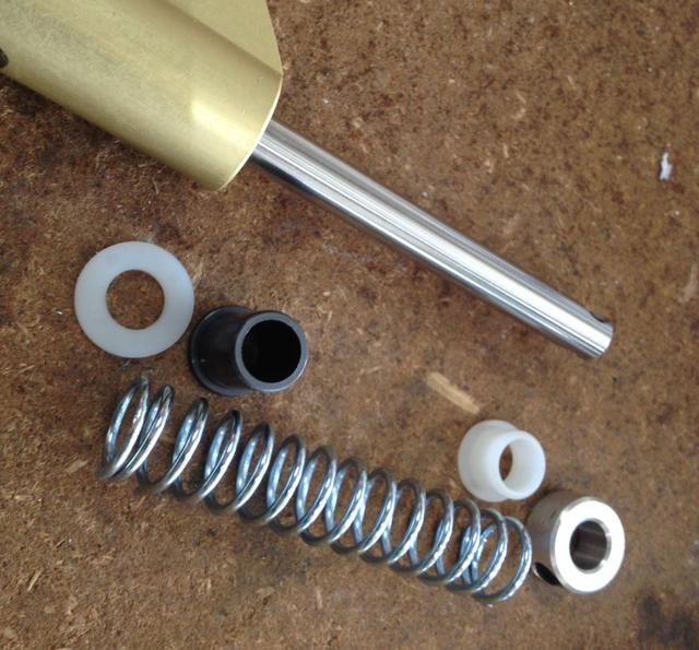

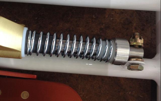

As I hate to say it but the master cylinders go bad and cause your brakes to drag. I’ve personally replaced them with Grove masters In 6 Rvs and 2 Glastar’s. Rebuilding does no good. Only thing I’ve seen that helps completely release the brakes is installing a external spring on the shaft.
togaflyer 10-03-2020 08:49 PM
I have the Matco brakes. 32 months/240 hours, no issues. Did a lot of short field emergency landing practice this year with maximum braking. Just did my condition and have enough Brake left for one more year (if I lay off the short field heavy braking training for a while). I plan to recheck them at six months. Been very satisfied. Lots of braking power. Worth the money to me.
One add on. To prevent the peddle’s brake cylinders from failing to fully extend after pressure is applied, you can slide Springs over the cylinder rods. They need to be Long enough where the springs have enough load to push the cylinder out. This will help prevent drag issues caused by the cylinders not fully extending.

rvdave 10-04-2020 06:53 AM
I’d be interested in a picture of how springs are installed

pazmanyflyer 10-04-2020 08:58 AM
Thread post about it here https://vansairforce.com/community/s...0&postcount=24
