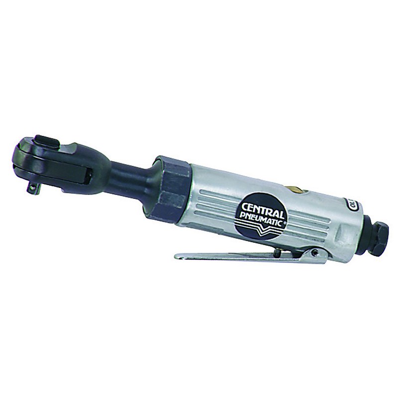

ronschreck 08-26-2020 04:29 AM
Get one of these.
This makes the job much easier:

mturnerb 08-26-2020 05:30 AM
Only $20 from harbor freight.
How do you set torque?
ronschreck 08-26-2020 05:45 AM
You would have a devil of a time getting a torque wrench on those 21 bolts! Just snug them up by feel.

ronschreck 08-26-2020 07:48 AM
Originally Posted by 9GT (Post 1457296)
... No way I would use a pneumatic anything for these small bolts...
If you set the pressure to about 25 PSI you won't harm a thing. Set final torque by feel or with a torque wrench if you can get one in the tight spaces. I have used a pneumatic wrench for about a dozen tank removal/installs without incident. Do what you feel comfortable with.
