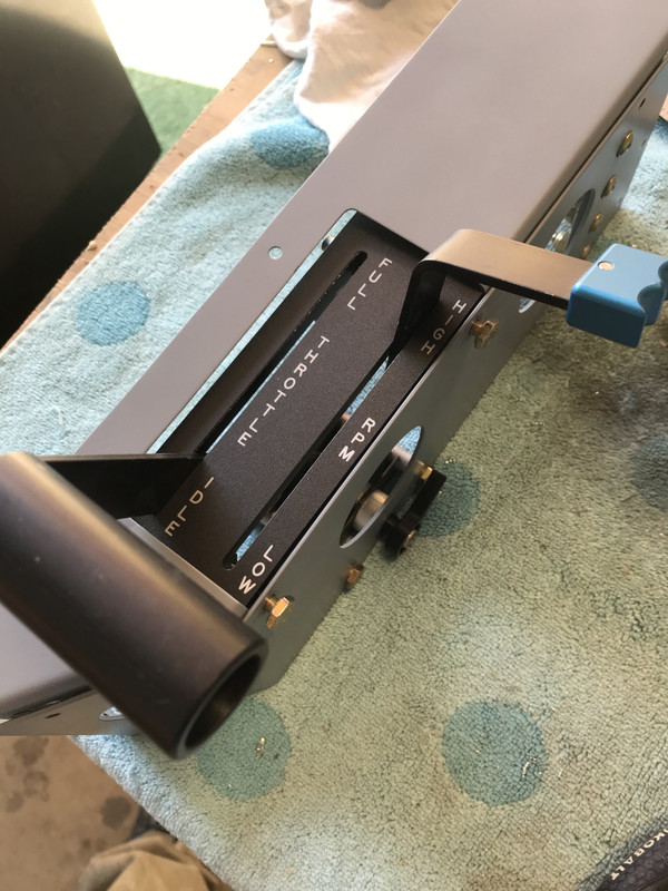

I had the same issue. I have the 3 lever flat top throttle quadrant. I removed the mixture lever and moved the prop lever to it's location. I used two washer for spacing where the prop was before.
I had Engravers.com make me a black lexan plate with just Throttle and Prop. The lexan plate is very thin and comes with a peel off sticker on the back. I bet if you call them and gave them my name they probably still have the template on file.
agent4573 07-23-2020 01:21 PM
That looks like almost exactly what I need. I don't know if I have the extra 0.5" width the 3 lever requires vs the 2, but once I get em installed I can easily make up a template like that and send it to engravers. Thanks.
