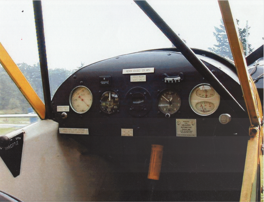

More "Screens" the Better...
I flew J3-Cub for 23 years. Now I can't get enough colored screens...

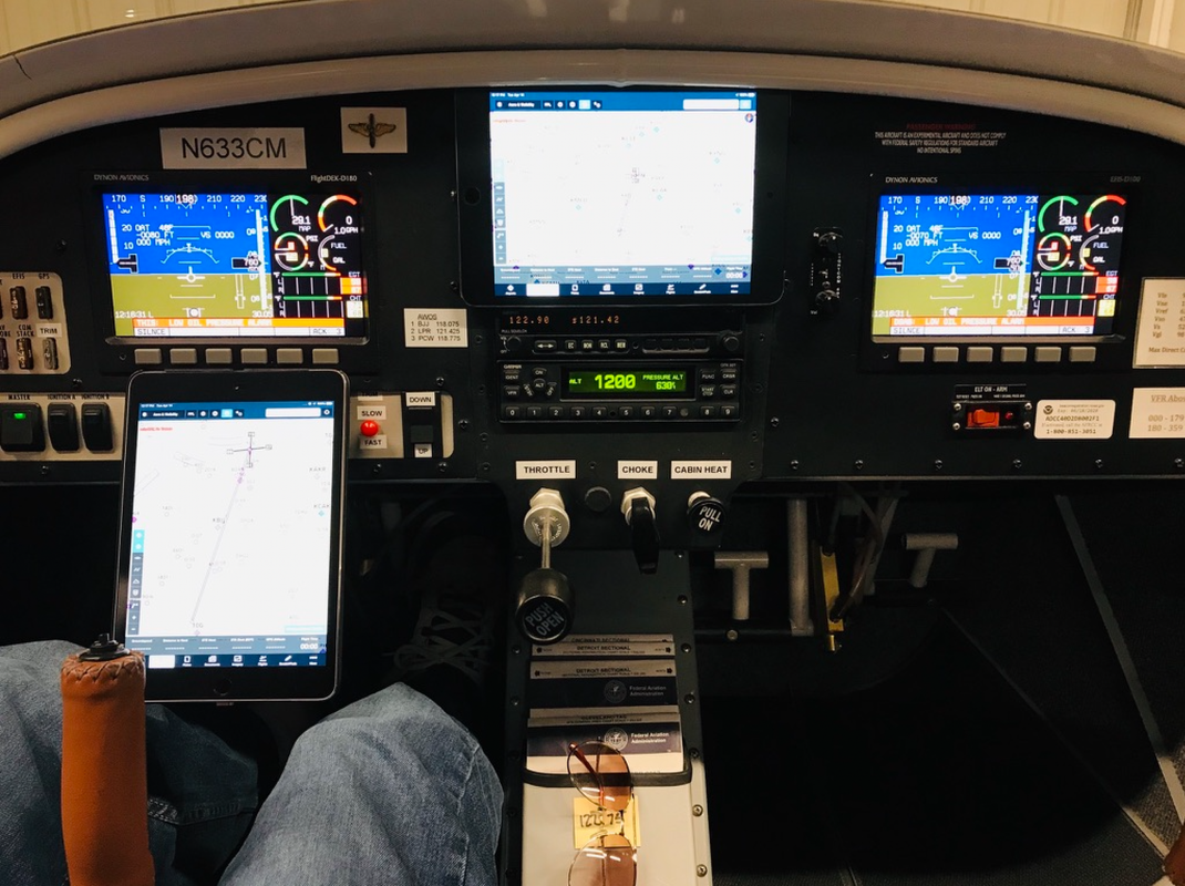

Piper J3 05-16-2020 10:35 AM
Windows??? Only window is the canopy.
Two mini iPad's running ForeFlight with Cockpit Sharing. Angled screen is zoomed out and shows course, weather, and traffic at a distance. Top center screen stays zoomed at 4 mile radius and shows nearby traffic for safe avoidance. Good situational awareness - just need to remember to look outside... :D
