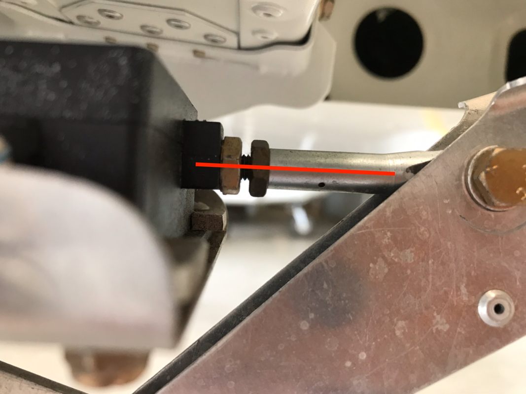

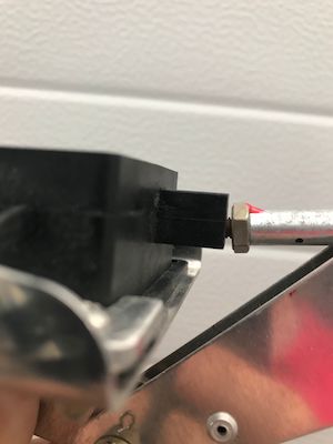

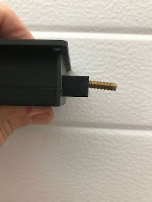

Tony_T 05-17-2020 08:39 AM
Just as a matter of interest I'll post some pictures of three servos. These are all the original life limited servos.
Looks Ok ~580 hrs
Looks OK ~300 hrs
Looks bent ~800 hrs
Piper J3 05-17-2020 09:15 AM
Tony -
Is servo with bent threaded rod yours? Any idea how it got bent? Manhandling stabilator or trim tab?

Tony_T 05-17-2020 10:03 AM
Originally Posted by Piper J3 (Post 1431023)
Tony -
Not mine. I do know the completed fuselage for this airplane was shipped across the country. The stab wasn't mounted but the servo and pushrod may have been. Could have been manhandled, but no way to know for sure. Otherwise, the airplane was always hangared and well maintained.
Yes, this one will be removed and sent to Ray Allen for review and replacement.
BTW, if your servo is like these with the rectangular actuator, you can slip a wire gauge like a spark plug gauge between the jam nut and the actuator which will help determine any bend. The gap is about .025 or a little wider.
