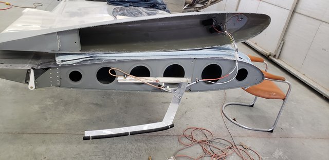

I believe this is precisely what is happening. Sorry for not mentionning it before but my problem is with a right side com antenna and yes it only happens when PTT is engaged. The install has changed since these pictures were taken as the inboard part of the antenna is now installed on the top part of the wingtip.
https://photos.app.goo.gl/TaoYR2oZ7ALdenzp7

Carl Froehlich 05-13-2020 12:26 PM
On the photos it is clear you have NAV/Strobe wire running along the antenna arm. Don?t do that.
Carl

Hmm -- The drawings suggest that this is correct - and cable clamps are included at this location to facilitate this routing.
However, I agree - keep all the wires as far as possible from the radiator (small piece of aluminum on top of the fiberglass) - and route the RG-400 back and away from the radiator.
B

It is as per instructions.

BobTurner 05-13-2020 02:11 PM
The instructions are for when you cannot avoid running wires across the antenna, use the provided clamps. But bypassing the antenna completely, by a foot or more, is better.
The first part of the radiating element (the piece that the feed arm attaches to) appears to be horizontal. For a com you have to bend the entire antenna up or down (depending if the ground leg is riveted low or high) to get as much vertical component in the first part of the antenna (the part that attaches to ground leg) as possible. Otherwise the polarization will be all horizontal, you need vertical.

As an update to my antenna problems, I have modified the installation in the windtip to reflect the Sportcraft antennas instructions in order to increase the verticality of the antenna. I have also improved the grounding of the antenna but to no avail. Engine monitoring still goes haywire when PTT is depressed.
see: https://photos.app.goo.gl/TaoYR2oZ7ALdenzp7

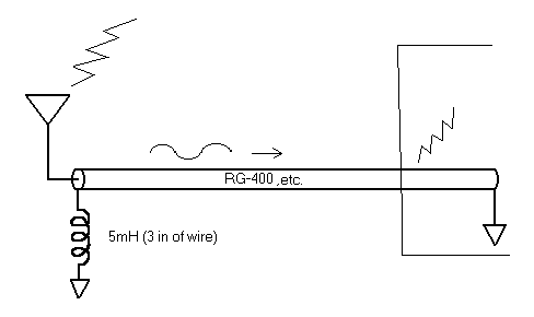

One thing that cought my eye in the installation instructions is this (Bob speaking:) )
"It has recently been brought to my attention that some folks have experienced problems with RF interference with trhe late model panel devices. These new devices operate on lower voltages and when the RF energy gets on the bus wires it can travel back to the panel area and cause all kinds of problems. SO, It is recommended that the cable used for the transmitted signals be the double shielded type and the cables should be run as far from Bus wires as possible."
Is return energy normal in well shielded cable?
I guess rerouting the RG400 will need to be looked into. Any (other) ideas?

?Return Energy? is a problem if the path of least resistance for the RF energy is not the antenna.
What I do:
- Assume the antenna is not resonant at the desired frequency unless you verified it so. Simple task with an antenna analyzer.
- Assume the antenna lead and connectors are an issue unless you verified them good. Again a simple task with an antenna analyzer.
- NEVER run the nav/strobe wires along the antenna like the instructions say. Move the antenna a little aft a little on the wing root to gain some separation. A few inches can make a world of difference. I suspect this is a common problem with both RF energy going back to the panel and LED noise getting into the radio.
- Assuming you are using modern LED Nav/strobes, feed these strobes via a three #20 conductor shielded wire (leads are power for the Nav, strobe and a strobe sync line, the shield is the ground lead).
- The RG-400 antenna coax can be run in the same bundle as the other wing wires. It will not typically be an issue unless there is a bigger problem with the antenna itself.

+1 on Carl?s comments. Look hard at the connectors, they?re surprisingly easy to screw up (ask me how I know!).
1. Is there a sharp bend in the coax, about 3? from the antenna connection? Maybe just the photo angle.
2. I bent mine a little differently. I drew a line right down the middle of the ground leg (the long way), clamped the outboard side plus the antenna, then bent the inboard half of the ground leg (with nutplates). Your bend location cost a bit of structural rigidity. In your photos, I can see that (1) you ?lost? the first inch of the radiator - it is horizontal. This is where the max current flows, and where the max radiation comes from. Probably not a big deal. But (2) I can see that the ?feed leg? got twisted a bit. The aluminum is lifted up a bit under the ground connection. (Not a big deal). But I cannot see under the capacitor, a few inches further up the feed leg. If it is also twisted-and has separated at all from the aluminum-bakelite-aluminum sandwich, the capacitance will be changed. That is important.
As Carl said, move the antenna back so the leading edge is near the thickest part of the wing. Then you?ll have the max possible vertical component. Re-route wires to the lights, inside the end rib if possible. Then run them straight across to the lights, well forward of the antenna.

After reading Jim Weir, I'm thinking ferrite coils. I would try to slip one over the cable where it leaves the wing tip. Probably a lot cheaper than double-shielded cable.
Just a thought.

Most com antennas are well grounded at the base. Further, the feed is shielded by the ac skin. The antenna is outside, the feed is inside, so it is not exposed to the antenna EM field and will not have significant RF voltage on the shield. All is good.
With the Archer install, that natural isolation is not present. There are 2 potential features which need to be addressed to prevent swamping the cabin area with EMI.
It should be understood that the coax feed just may be a better transmission line externally than internally. First, the shield is much bigger and more conductive than the center wire. Second, it is operating within a metallic structure with mostly a low loss air dielectric. So, any voltage on the shield at the antenna location will be pretty much what will be present in the cabin area 15 feet away.
The first mechanism that will induce voltage/current on the shield, is proximity to the antenna. The second is the more direct voltage divider effect of a poor shield ground. An example is a recent posting of a "proper" grounded coax to an Archer antenna. The workmanship was flawless, but the ground wire was about 3 " long. A 3 inch wire has a inductance of about 5 nH which is about 4 ohms at 120 MHZ. A 10 watt transmitter produces roughly 20 volts at 1/2 amp. The result is a solid 2 volts on the shield to be conveyed efficiently to the cabin area. A similar level might be expected on the shield from a feed lurking near the antenna.
So...., my suggestion to reduce some of this badness.
Add a BNC bulkhead/feedtrough fitting on the end rib. The rib along with the fitting applied will strip any voltage from the coax shield and isolate the cable run.
The image below may explain what could cause a lot of gremlins
BTW, a good quality coax single shield is rated about -80db, a double shield about 100db. In the case of the single shield and a 10 watt transmitter, 2mv(0.002V) outside the shield is about it, several orders of magnitude less that the 2 volts of conducted EMI above.

When I first built my plane, I installed a Bob Archer antenna for both VOR and COM. Both antennas worked OK for a couple of years then all of a sudden my VM-1000 engine instrument and GPS started behaving strangely and the COM was not consistent causing the controllers sometimes unable to hear my transmissions. I could not find anything wrong but decided to replace the Bob Archer COM antenna on the wingtip with a bent COM antenna on the belly right under the passenger seat in my RV-4. Immediately everything fixed itself and my range at least doubled with better voice reception and never had trouble with the fuselage blocking reception again. I really did not notice any substantial decrease in speeds but even if I did, I would trade for the superior communications and no gremlins.
I still have the old RG-58 coax cable that was used successfully for decades in certified airplanes but notice that my ILS slope reception is sometimes week when I am more than about 7 miles from the FAF. I should try RG-400 to see if I can improve reception but have been to lazy to change it out. Has anyone else had this problem?
Cheers

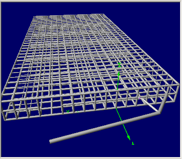

3D of an Archer model which might be of interest..
I would like to mention for those with some background in electronics, there is a great antenna tool available on Ebay, etc called a NanoVNA. I bought a Vector Network Analyzer a few year ago for the better part of a grand. But these handy little rascals are only ~50 dollars. You'll need some BNC adapters as well - and maybe some good reading glasses:). More to say. Too much thread drift.
Ron

Carl Froehlich 07-05-2020 09:00 AM
Standard BNC bulkhead connector: https://www.alliedelec.com/product/a...-rfx/70142939/
But - much simpler and I believe a better way to go is to mount the antenna on the end rib, not in the wingtip. The wingtip then just slides over the antenna.
Carl
