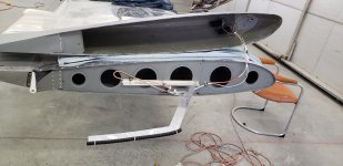

https://photos.app.goo.gl/TaoYR2oZ7ALdenzp7 |
I cannot see the photos.
I can't see the photos either. Might be a permissions problem?
See this note from the instructions:
"It has recently been brought to my attention that some folks have experienced problems with RF interference with the late model panel devices. These new devices operate on lower voltages and when the RF energy gets on the bus wires it can travel back to the panel area and cause all kinds of problems. SO, It is recommended that the cable used for the transmitted signals be the double shielded type and the cables should be run as far from Bus wires as possible. The double shielded types are; RG55, RG142,RG213 and RG400. These are commonly available types but there are others." B |
On the photos it is clear you have NAV/Strobe wire running along the antenna arm. Don?t do that.
Carl |
