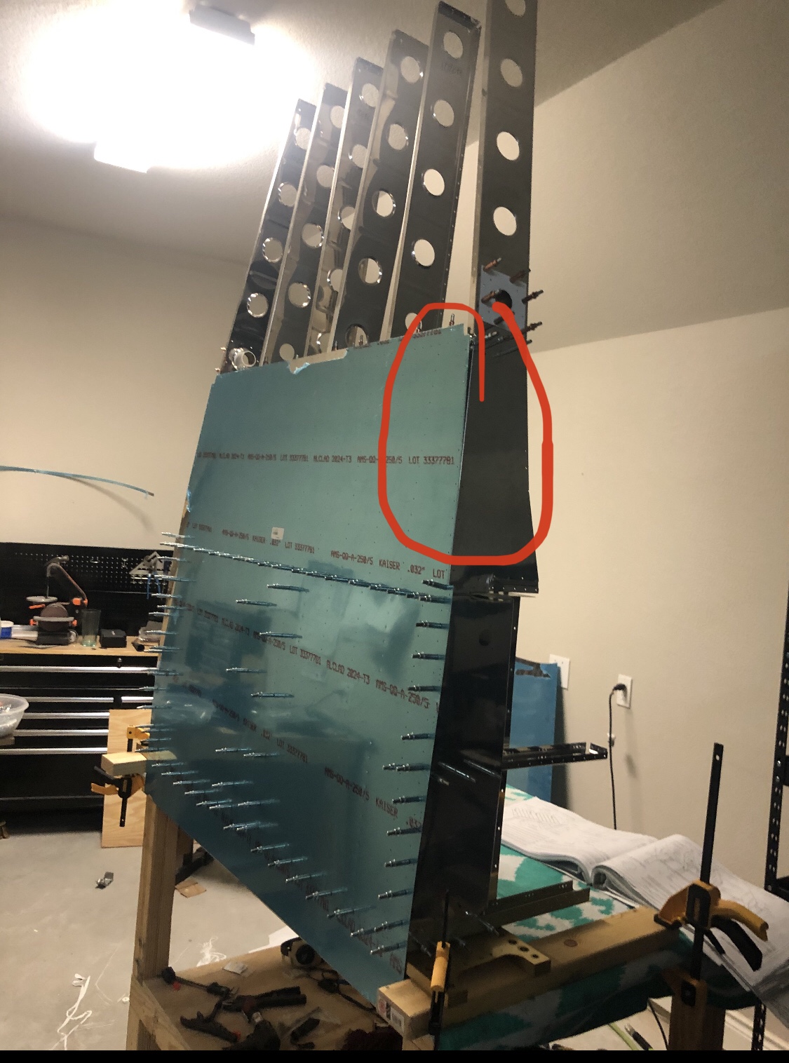

26-5 Step 1 calls for fluting the F-1015 ribs, which I did no problems. It does not call for fluting the F-1018 rib (next further aft outboard rib) to match the curve in the bottom skin holes. I am now clecoing on the bottom skin and finding the holes do not align. I can get the clecos in going one at a time, but the rib begins to pucker/flute itself. Anyone else have this issue? Should I just flute the rib flange? Only concern with doing so is shrinking the overall length causing a different issue. Before doing so wanted to check with the trusty VAF.

Believe I may have found the answer here:
http://www.vansairforce.com/communit...ad.php?t=74324
I will probably just flute and see what happens. Easy enough to un-flute some if it pulls holes too close together. If anyone had any other thoughts, feel free to chime in. Will also keep an eye out for the ?gotcha? discussed in the linked thread.

Yea beware all the gotchas in that section. I think I captured them all here, with due credit to other (more crafty) builders before me.
https://n67sc.blogspot.com/2019/09/m...ttom-skin.html

Fluting worked perfectly. Usually instructions are spot on, but frustrating that sometimes they are inconsistent with when they explicitly call for a certain step/technique vs other times...oh well! Thanks.

Brandon, you and I are at the same place right now and I had this very issue 2 days ago. I went ahead and drilled them after they "self fluted", then fluted them after I removed the skin. I just about have everything ready to go back on after all the deburing and priming.
